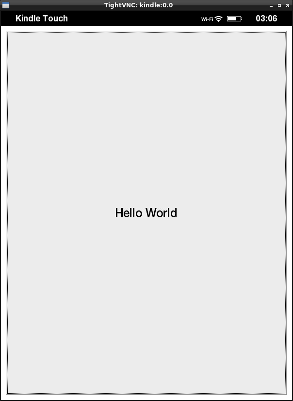

*patter of applause*
Name:	TightVNC: kindle:0.0_080.png

(*) FBDev/Mode: Setting 600x800 videomode x=600, y=800
(*) FBDev/Mode: Setting 600x800 videomode x=600, y=706
(*) FBDev/Mode: Setting 600x800 videomode x=800, y=506
(*) FBDev/Mode: Setting 600x800 videomode x=800, y=600
(*) FBDev/Surface: Allocated 600x800 8 bit LUT8 buffer (index 0) at offset 0 and pitch 600.
(!!!) *** WARNING [Non-flipping window surface and no 'autoflip-window' option used] *** [idirectfbsurface_window.c:310 in IDirectFBSurface_Window_Construct()]
in _gdk_windowing_window_init creating primary surface window - w=600, h=800
create_directfb_window( 600x 800, caps 0x00000009 )
(test:19609): Gdk-CRITICAL **: gdk_drawable_set_colormap: assertion `cmap == NULL || gdk_drawable_get_depth (drawable) == cmap->visual->depth' failed
(*) Direct/Thread: Started 'EventBufferFeed' (-1) [MESSAGING OTHER/OTHER 0/0] <8388608>...
create_directfb_window( 100x 48, caps 0x00000001 )
(test:19609): Gdk-DirectFB-WARNING **: gdk_window_set_keep_above() not implemented.
(test:19609): Gdk-DirectFB-WARNING **: gdk_window_set_keep_below() not implemented.
Step 4) [root@kindle root]# echo 1 > /proc/eink_fb/update_display
for quick redraw testing. assumedly this could be shoved into a relevant repaint event.
but a worker.
Name:	Screenshot from 2012-12-21 17:20:01.png
