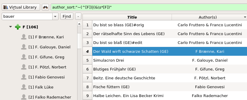

Hallo.
I wanted to change author/author sort and especially the appearance in the home-file. So far I was very successful (in changing), only the result is not just the one wanted. It's a total mess now. How many times I have changed anything and what, to ask would be quite pointless.
Before (sorted alphabetical→s. a.)
Authors fn ln, s. a. fn (tag browser)
Authors sort ln, fn
home-file fn ln, s. a. fn
Wanted
Authors fn ln, s. a. ln (tag browser)
home-file fn ln, s. a. ln

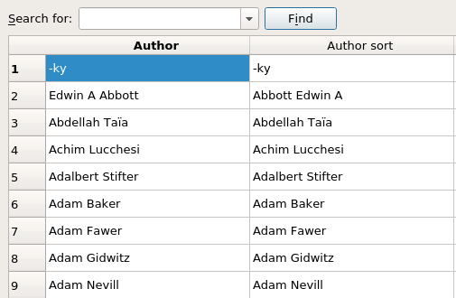

Consequently, it is probably just best to show you the status quo and to solicit general advice.
Name:	Manage Authors.png
Manage Authors
Preferences→Advanced→Tweaks→Author sort name algorithm is set on author_sort_copy_method = 'comma' (default)
I suspect any solution means some manual work, but that does not matter, makes me more and more familiar with my library and calibre.

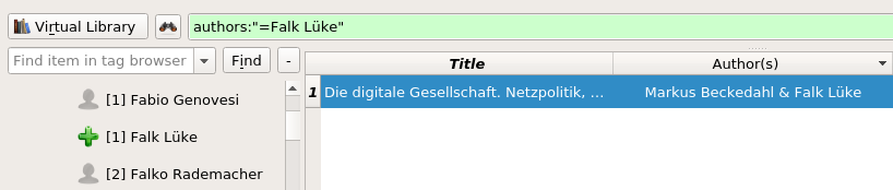

Carlo Fruttero & Franco Lucentini and Falk Lüke are authors of multi authors books. Why these 3 books (from that authors couple) are on top, that one from Falk Lüke not in line, I don't know!?
Name:	multi author book.png
Multi author book

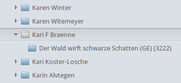

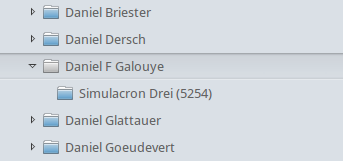

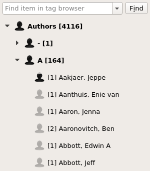

In the example the 4 authors F Brænne, Kari + F. Galouye, Daniel + F. Gifune, Greg + F. Pötzl, Norbert are to change manually, I gess. Calibre doesn't treat 3 or 4 name authors like (normal) 2 name authors. Anyway, that isn't a (big) problem, they are in minority.
I can do that on two ways, with tool Edit metadata individually or Rename [author name].
Results in tag browser OK, but not in home-file.
Name:	Kari F Brænne.png
ID:	139881 Click image for larger version
Name:	Kari F Brænne_home-file.png
Kari F Brænne - - - - - - - - - Kari F Brænne_home-file
Name:	Daniel F Galouye.png
ID:	139883 Click image for larger version
Name:	Daniel F Galouye_home-file.png
Daniel F Galouye - - - - - - - Daniel F Galouye_home-file

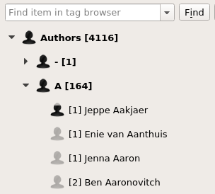

This Quality check PI is really a very powerful, fast-acting tool. Worked perfectly.
Authors sorting in Tag browser now as desired (using Manage Authors).

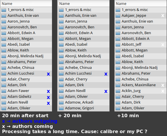

Now I remember why I had this confusion in the lists before. When I turned to you with this thread I just had broken off this sorting process before completion.
Today not! Processing 100%, but takes over a hour.

I struggle around now more than 2 hours with these calibredb commands and can't get it.
At beginning I processed with
calibredb backup_metadata
all the metadat.opf's back into home-file (takes 25 minutes).
Beside there was a terminal list (below a small excerpt).
99.9% 15231 - Ulysses
99.9% 15232 - Ulysses
99.9% 15233 - Dubliners
99.9% 15246 - Quick Start Guide
99.9% 15322 - Stadt Der Fremden
99.9% 15353 - Unknown
99.9% 15371 - Unknown
100.0% 15372 - Warentest [vie, 03 jul 2015]
100.0% 15378 - Worm. Der erste digitale Weltkrieg (GE)
100.0% 15379 - Warentest [sáb, 04 jul 2015]
100.0% 15380 - Warentest [lun, 06 jul 2015]
ali@puta:~$
Unfortunately my terminal scroll back was put on 1000, so shows only the last 1000 entries, but I want to see them all. I wonder, that there are 15380 entries, but caibre shows only 9089 books!?
Now only that
ali@puta:~$ calibredb backup_metadata
ali@puta:~$
Which command shows me that 15380 entries list again?

You'll need to fix the default sort values.
Right-click on an author link in the Book Details pane. Or right-click on Authors in the Tag Browser.
Select "Manage $author_name" -- or "Manage Authors".
This will allow you to modify Author Sort -- all future books will use that value.
Then select all (affected) books, and use Edit Metadata (it will enter bulk mode), check the box for "Automatically set author sort", and reset all your author_sort values based on the updated defaults.
