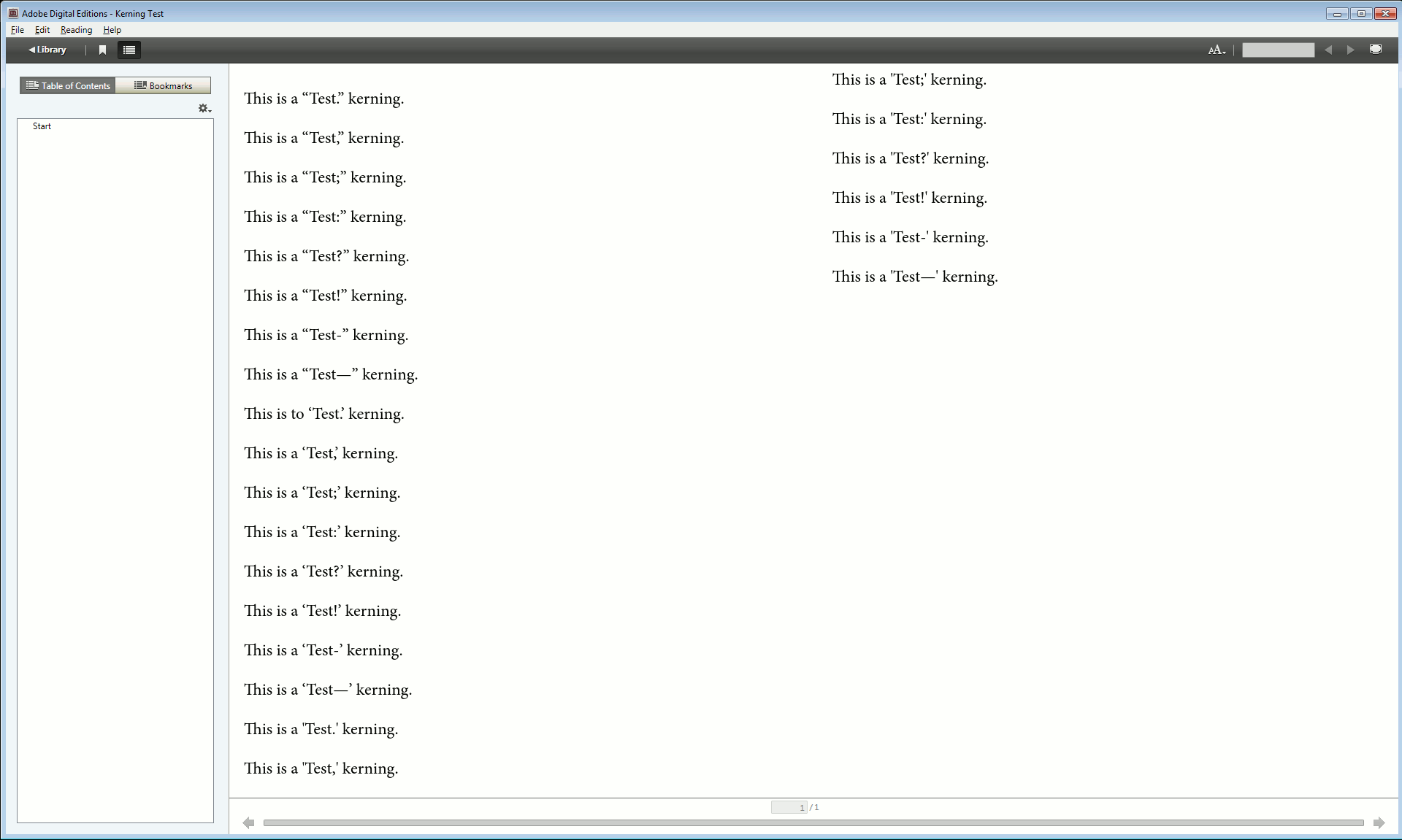

Looks like that is correct. I tested it on my end and got this:
Looks like it is tight on the "smart" double quote and the "smart" single quote.
I attached a test EPUB as well.

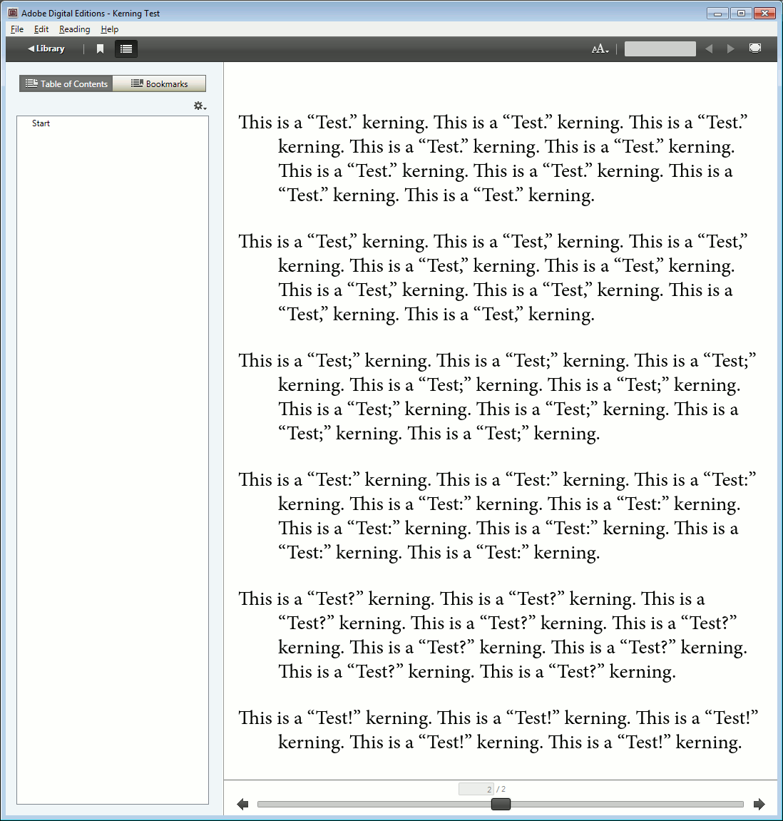

Again, this is where code will matter. I just used that CSS in an expanded Kerning Test (attached to this post), and I still see the issue has not changed.
If you spot an area where this issue does not happen, we will need more tests/code/examples!

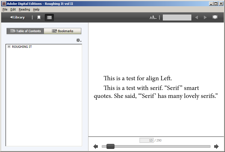

@JSWolf: Of course, you could also assume that users who read with the default sans-serif are accustomed to it, and know what to expect and how to interpret its appearance.
Wouldn't embedding a main body-text font make it difficult for users who want sans-serif? Or who just don't like the font you choose to inflict on them?
PS: @Jellby, when I check with align-left, the sans-serif is still more tightly kerned than the serif font. Maybe it is just a feature of that font...
ID:	116225   Click image for larger version
