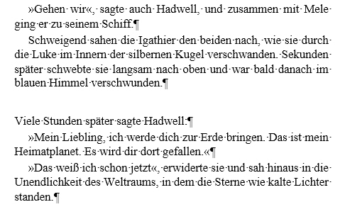

Scene detection by other criteria
Hi Toxaris
Scene detection in the preparation part of the add-in is a really helpful thing. However - very often I come upon scene changes which are indicated merely by a paragraph without indentation (no hanging indent). Then the following paragraphs have hanging indents.
Would it be technically possible to add such a scene break indicator/criterium to your preparation module?
Thanks, Klaus

Yes, it would be possible. However, please keep in mind that this is a very specific case. Also, if the source is OCR you can get incorrect results. Consider the situation that a sentence in a paragraph ends at the end of a line. The next line would start with a new sentence that is part of the same paragraph. The option you describe would then result in an incorrect scenebreak instead of the next line in the paragraph of perhaps the next paragraph. So, it could lead to quite incorrect results.
Most scene breaks have at least some white space between the lines.
If you still want it, please put it on the issue list and I will take a look at it.

Thanks - I will do this. Attached is a screenshot of my issue.
Klaus
P.S. The scene break is the chapter of short story writers

The example you gave should already result into a detected scenebreak. There is a white line between the paragraphs. If not, there is something else wrong.
Unfortunately it did not: the current representation of that scene break in Word 2016 is the paragraph before with an extended spacing - no white line.
Maybe I have to find another way to solve this ...

Can you sent me an example file that has this behavior? Then I can take a look at it why it doesn't do what it should have done.

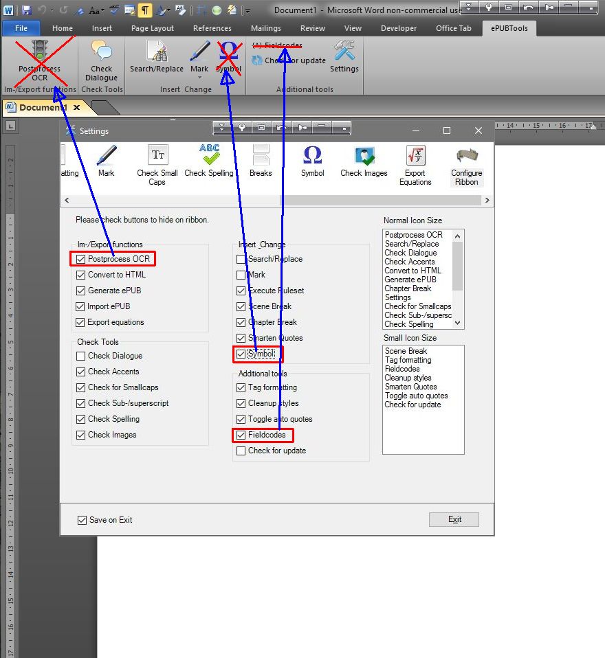

Can't hide 'Symbol' icon in the Ribbon via checking in Configure Ribbon.
For future consideration. Allow users to control the order of buttons on the ribbon so that the order matches their workflow. Check Dialogue is one of the last things I do, but now it's first button in my ribbon.
Will check the Symbol hiding.
I am not sure how doable it will be to let the user control the order of the buttons. I haven't looked into it (I have thought about it) yet. It might be possible.

Suddenly two more items checked as not needed are showing, viz:
They weren't there this morning, otherwise I would have mentioned them.

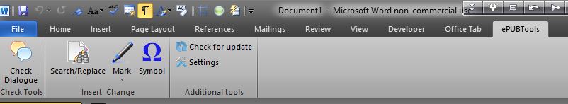

Added: I moved Settings to the Small icon size list and behold, begosh and begorrah the Postprocess OCR and Field codes items disappeared from the ribbon. I'm attaching the config file as it is now
BR(exit)
Attachment 149877
Attachment 149878
BR(exit)
I will, of course, check this. It is strange, since the names have not changed, only the label.
