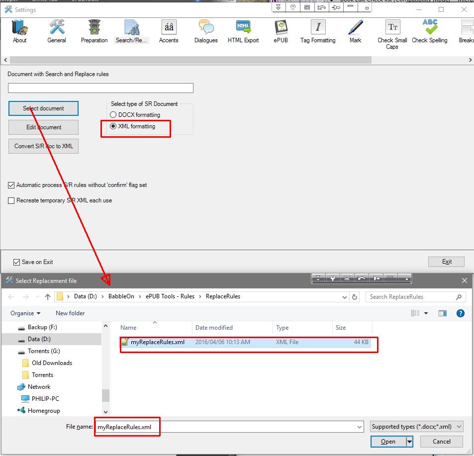

Sorry another bug - I cant Select my XML S&R Rules file, when I do this:

I get this

Happens with 1.23.1 and 1.23, I don't want to go back to 1.22 because then I would lose the changes you made to dialogue checker. I have been using that file for months. I downloaded the sample XML from toxaris.nl/en and got the same result
Can you tell me what I need to hand code into the epubtools.cfg file so that I can use 'myreplacerules.xml' file Ψ²

I will fix this of course, this is silly. I typed OR instead of AND.
What you must change in the configuration file specify the correct path in the parameter "locVervang" while Word is not running. When you start Word, that file should be used.

Didn't work - same result as yesterday - are you sure the tag name is right?

Solved - I added a new locVervang, after the existing empty one I wasn't sure if I needed to wrap the path in quotes, so I used the Mark option as a guide, hence the adjacency.
After I deleted the empty one its OK
