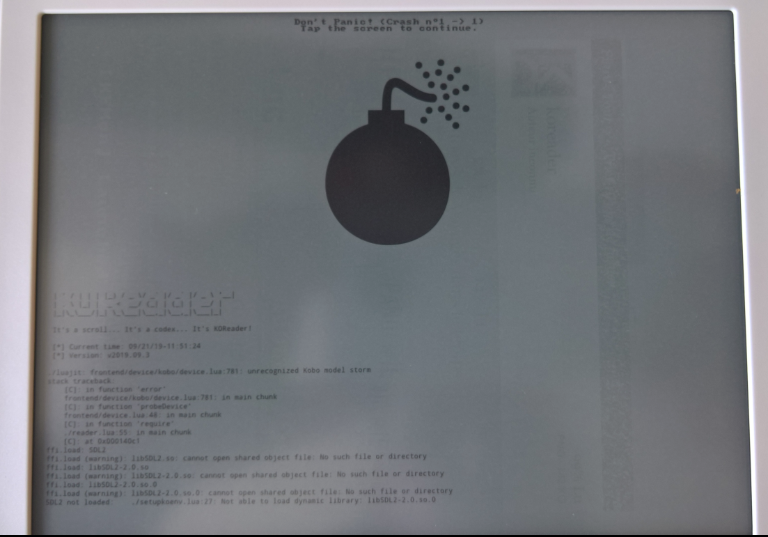

Thumbs up [RESOLVED] Problem installing Koreader on Kobo Libra H2O
Hi everybody !
- Could anyone help me install the Koreader on the "Kobo Libra h2O" book reader?
- On my Clara HD, I used the Koreader, installed with ONE-CLICK, before the new Firmware, but after installing the new Firmware on my "Kobo Libra H2O" the installation doesn't work. I have a "crash" after starting.
-For installation I used:
One-Click Install Packages for KOReader & Plato :
https://www.mobileread.com/forums/sh...d.php?t=314220
*Neither Koreader nor Plato can be launched.
- Is there a solution? Mainly I would like "Koreader" I do not need a "PLATO" . Is there any good soul that could help please?
[Screen scrash]:

I managed to run it.
I replaced KOREADER with the latest versionv2019.09.3-27.
http://build.koreader.rocks/download...1d_2019-09-20/
- But I have a problem with "screen orientation". The touch is the other way around. When I press down on the right, the screen will show up on the left.
(lower right corner= left top corner )
- Is it possible to solve the problem with the orientation / set the touch screen correctly?

Okay, that's what I was afraid of, so, not a huge surprise . (Panel is mounted in a different orientation, potentially finally matching the touch layer, and, if we're extremely lucky, in Portrait, which would allow some fast-paths in the EPDC to finally kick in).
I'm going to need a few things to fix it properly:
* KFMon logs (in Nickel, tap the KFMon icon, and PM me .adds/kfmon/log/kfmon_dump.log)
* KOReader logs (.adds/koreader/crash.log)
* And the cherry on top would be running this test (from Nickel, in Portrait orientation) .

[FBInk] Detected a Kobo Libra H2O (384 => Storm @ Mark 7)
[FBInk] Enabled Kobo Mark 7 quirks
[FBInk] Clock tick frequency appears to be 100 Hz
[FBInk] Screen density set to 300 dpi
[FBInk] Variable fb info: 1264x1680, 16bpp @ rotation: 0 (Upright, 0°)
[FBInk] Fontsize set to 32x32 (IBM base glyph size: 8x8)
[FBInk] Line length: 39 cols, Page size: 52 rows
[FBInk] Vertical fit isn't perfect, shifting rows down by 8 pixels
[FBInk] Fixed fb info: ID is "mxc_epdc_fb", length of fb mem: 9175040 bytes & line length: 2560 bytes
[FBInk] Pen colors set to #000000 for the foreground and #FFFFFF for the background
[KFMon] [2019-09-21 @ 14:46:10] [INFO] Beginning the main loop.
[KFMon] [2019-09-21 @ 14:46:10] [INFO] Checking watch config file '/mnt/onboard/.adds/kfmon/config/koreader.ini' for changes . . .
[KFMon] [2019-09-21 @ 14:46:10] [INFO] Checking watch config file '/mnt/onboard/.adds/kfmon/config/kfmon-log.ini' for changes . . .
[KFMon] [2019-09-21 @ 14:46:10] [INFO] Initializing inotify.
[KFMon] [2019-09-21 @ 14:46:10] [NOTE] Setup an inotify watch for '/mnt/onboard/koreader.png' @ index 0.
[KFMon] [2019-09-21 @ 14:46:10] [NOTE] Setup an inotify watch for '/mnt/onboard/kfmon.png' @ index 1.
[KFMon] [2019-09-21 @ 14:46:10] [INFO] Listening for events.
[FBInk] Detected a change in framebuffer bitdepth, reinitializing...
[FBInk] Variable fb info: 1264x1680, 32bpp @ rotation: 0 (Upright, 0°)
[FBInk] Fixed fb info: ID is "mxc_epdc_fb", length of fb mem: 9175040 bytes & line length: 5120 bytes
[KFMon] [2019-09-21 @ 14:46:47] [NOTE] Tripped IN_OPEN for /mnt/onboard/koreader.png
[KFMon] [2019-09-21 @ 14:46:47] [NOTE] Tripped IN_CLOSE for /mnt/onboard/koreader.png
[KFMon] [2019-09-21 @ 14:46:47] [INFO] Preparing to spawn /mnt/onboard/.adds/koreader/koreader.sh for watch idx 0 . . .
[KFMon] [2019-09-21 @ 14:46:47] [NOTE] /mnt/onboard/.adds/koreader/koreader.sh is flagged as a spawn blocker, it will prevent *any* event from triggering a spawn while it is still running!
[KFMon] [2019-09-21 @ 14:46:47] [NOTE] Spawned process 1281 (/mnt/onboard/koreader.png -> /mnt/onboard/.adds/koreader/koreader.sh @ watch idx 0) . . .
[KFMon] [2019-09-21 @ 14:46:47] [INFO] [TID: 1282] Waiting to reap process 1281 (from watch idx 0) . . .
[FBInk] Variable fb info: 1680x1264, 8bpp @ rotation: 3 (Counter Clockwise, 270°)
[FBInk] Line length: 52 cols, Page size: 39 rows
[FBInk] Fixed fb info: ID is "mxc_epdc_fb", length of fb mem: 9175040 bytes & line length: 1696 bytes
[KFMon] [2019-09-21 @ 14:55:31] [NOTE] Tripped IN_OPEN for /mnt/onboard/kfmon.png
[KFMon] [2019-09-21 @ 14:55:31] [NOTE] Tripped IN_CLOSE for /mnt/onboard/kfmon.png
[KFMon] [2019-09-21 @ 14:55:31] [INFO] As a spawn blocker process is currently running, we won't be spawning anything else to prevent unwanted behavior!
[KFMon] [2019-09-21 @ 14:55:31] [NOTE] Tripped IN_OPEN for /mnt/onboard/koreader.png
[KFMon] [2019-09-21 @ 14:55:31] [NOTE] Tripped IN_CLOSE for /mnt/onboard/koreader.png
[KFMon] [2019-09-21 @ 14:55:31] [INFO] As watch idx 0 (/mnt/onboard/koreader.png) still has a spawned process (1281 -> /mnt/onboard/.adds/koreader/koreader.sh) running, we won't be spawning another instance of it!
[KFMon] [2019-09-21 @ 14:58:11] [NOTE] [TID: 1282] Reaped process 1281 (from watch idx 0): It exited with status 0.
[START] [2019-09-21 @ 14:58:11] [WARN] [PID: 1378] KFMon is already running (PID: 189)!
[KFMon] [2019-09-21 @ 14:58:37] [NOTE] Tripped IN_UNMOUNT for /mnt/onboard/kfmon.png
[KFMon] [2019-09-21 @ 14:58:37] [INFO] Unmount detected, nothing to do, all watches will naturally get destroyed.
[KFMon] [2019-09-21 @ 14:58:37] [NOTE] Tripped IN_IGNORED for /mnt/onboard/kfmon.png
[KFMon] [2019-09-21 @ 14:58:37] [INFO] Trying to remove inotify watch for '/mnt/onboard/koreader.png' @ index 0.
[KFMon] [2019-09-21 @ 14:58:37] [INFO] Stopped listening for events.
[KFMon] [2019-09-21 @ 14:58:37] [INFO] Beginning the main loop.
[KFMon] [2019-09-21 @ 14:58:37] [INFO] /mnt/onboard isn't mounted, waiting for it to be . . .
[KFMon] [2019-09-21 @ 15:03:02] [INFO] Mountpoints changed (iteration nr. 1 of 6)
[KFMon] [2019-09-21 @ 15:03:02] [NOTE] Yay! Target mountpoint is available!
[KFMon] [2019-09-21 @ 15:03:02] [INFO] Checking watch config file '/mnt/onboard/.adds/kfmon/config/koreader.ini' for changes . . .
[KFMon] [2019-09-21 @ 15:03:02] [INFO] Checking watch config file '/mnt/onboard/.adds/kfmon/config/kfmon-log.ini' for changes . . .
[KFMon] [2019-09-21 @ 15:03:02] [INFO] Initializing inotify.
[KFMon] [2019-09-21 @ 15:03:02] [NOTE] Setup an inotify watch for '/mnt/onboard/koreader.png' @ index 0.
[KFMon] [2019-09-21 @ 15:03:02] [NOTE] Setup an inotify watch for '/mnt/onboard/kfmon.png' @ index 1.
[KFMon] [2019-09-21 @ 15:03:02] [INFO] Listening for events.
[KFMon] [2019-09-21 @ 15:03:09] [NOTE] Tripped IN_OPEN for /mnt/onboard/koreader.png
[KFMon] [2019-09-21 @ 15:03:09] [NOTE] Tripped IN_CLOSE for /mnt/onboard/koreader.png
[KFMon] [2019-09-21 @ 15:03:09] [INFO] Preparing to spawn /mnt/onboard/.adds/koreader/koreader.sh for watch idx 0 . . .
[KFMon] [2019-09-21 @ 15:03:09] [NOTE] /mnt/onboard/.adds/koreader/koreader.sh is flagged as a spawn blocker, it will prevent *any* event from triggering a spawn while it is still running!
[KFMon] [2019-09-21 @ 15:03:09] [NOTE] Spawned process 2658 (/mnt/onboard/koreader.png -> /mnt/onboard/.adds/koreader/koreader.sh @ watch idx 0) . . .
[KFMon] [2019-09-21 @ 15:03:09] [INFO] [TID: 2659] Waiting to reap process 2658 (from watch idx 0) . . .
[KFMon] [2019-09-21 @ 15:03:55] [NOTE] Tripped IN_OPEN for /mnt/onboard/koreader.png
[KFMon] [2019-09-21 @ 15:03:55] [NOTE] Tripped IN_CLOSE for /mnt/onboard/koreader.png
[KFMon] [2019-09-21 @ 15:03:55] [INFO] As watch idx 0 (/mnt/onboard/koreader.png) still has a spawned process (2658 -> /mnt/onboard/.adds/koreader/koreader.sh) running, we won't be spawning another instance of it!
[KFMon] [2019-09-21 @ 15:03:56] [NOTE] Tripped IN_OPEN for /mnt/onboard/koreader.png
[KFMon] [2019-09-21 @ 15:03:56] [NOTE] Tripped IN_CLOSE for /mnt/onboard/koreader.png
[KFMon] [2019-09-21 @ 15:03:56] [INFO] As watch idx 0 (/mnt/onboard/koreader.png) still has a spawned process (2658 -> /mnt/onboard/.adds/koreader/koreader.sh) running, we won't be spawning another instance of it!
[KFMon] [2019-09-21 @ 15:04:13] [NOTE] [TID: 2659] Reaped process 2658 (from watch idx 0): It exited with status 0.
[START] [2019-09-21 @ 15:04:13] [WARN] [PID: 2774] KFMon is already running (PID: 189)!
[KFMon] [2019-09-21 @ 15:04:33] [NOTE] Tripped IN_UNMOUNT for /mnt/onboard/kfmon.png
[KFMon] [2019-09-21 @ 15:04:33] [INFO] Unmount detected, nothing to do, all watches will naturally get destroyed.
[KFMon] [2019-09-21 @ 15:04:33] [NOTE] Tripped IN_IGNORED for /mnt/onboard/kfmon.png
[KFMon] [2019-09-21 @ 15:04:33] [INFO] Trying to remove inotify watch for '/mnt/onboard/koreader.png' @ index 0.
[KFMon] [2019-09-21 @ 15:04:33] [INFO] Stopped listening for events.
[KFMon] [2019-09-21 @ 15:04:33] [INFO] Beginning the main loop.
[KFMon] [2019-09-21 @ 15:04:33] [INFO] /mnt/onboard isn't mounted, waiting for it to be . . .
[KFMon] [2019-09-21 @ 15:09:09] [INFO] Mountpoints changed (iteration nr. 1 of 6)
[KFMon] [2019-09-21 @ 15:09:09] [NOTE] Yay! Target mountpoint is available!
[KFMon] [2019-09-21 @ 15:09:09] [INFO] Checking watch config file '/mnt/onboard/.adds/kfmon/config/koreader.ini' for changes . . .
[KFMon] [2019-09-21 @ 15:09:09] [INFO] Checking watch config file '/mnt/onboard/.adds/kfmon/config/kfmon-log.ini' for changes . . .
[KFMon] [2019-09-21 @ 15:09:09] [INFO] Initializing inotify.
[KFMon] [2019-09-21 @ 15:09:09] [NOTE] Setup an inotify watch for '/mnt/onboard/koreader.png' @ index 0.
[KFMon] [2019-09-21 @ 15:09:09] [NOTE] Setup an inotify watch for '/mnt/onboard/kfmon.png' @ index 1.
[KFMon] [2019-09-21 @ 15:09:09] [INFO] Listening for events.
[KFMon] [2019-09-21 @ 15:09:13] [NOTE] Tripped IN_OPEN for /mnt/onboard/koreader.png
[KFMon] [2019-09-21 @ 15:09:13] [NOTE] Tripped IN_CLOSE for /mnt/onboard/koreader.png
[KFMon] [2019-09-21 @ 15:09:13] [INFO] Preparing to spawn /mnt/onboard/.adds/koreader/koreader.sh for watch idx 0 . . .
[KFMon] [2019-09-21 @ 15:09:13] [NOTE] /mnt/onboard/.adds/koreader/koreader.sh is flagged as a spawn blocker, it will prevent *any* event from triggering a spawn while it is still running!
[KFMon] [2019-09-21 @ 15:09:13] [NOTE] Spawned process 3950 (/mnt/onboard/koreader.png -> /mnt/onboard/.adds/koreader/koreader.sh @ watch idx 0) . . .
[KFMon] [2019-09-21 @ 15:09:13] [INFO] [TID: 3951] Waiting to reap process 3950 (from watch idx 0) . . .
[KFMon] [2019-09-21 @ 15:10:30] [NOTE] [TID: 3951] Reaped process 3950 (from watch idx 0): It exited with status 0.
[START] [2019-09-21 @ 15:10:30] [WARN] [PID: 4050] KFMon is already running (PID: 189)!
[KFMon] [2019-09-21 @ 15:10:49] [NOTE] Tripped IN_UNMOUNT for /mnt/onboard/kfmon.png
[KFMon] [2019-09-21 @ 15:10:49] [INFO] Unmount detected, nothing to do, all watches will naturally get destroyed.
[KFMon] [2019-09-21 @ 15:10:49] [NOTE] Tripped IN_IGNORED for /mnt/onboard/kfmon.png
[KFMon] [2019-09-21 @ 15:10:49] [INFO] Trying to remove inotify watch for '/mnt/onboard/koreader.png' @ index 0.
[KFMon] [2019-09-21 @ 15:10:49] [INFO] Stopped listening for events.
[KFMon] [2019-09-21 @ 15:10:49] [INFO] Beginning the main loop.
[KFMon] [2019-09-21 @ 15:10:49] [INFO] /mnt/onboard isn't mounted, waiting for it to be . . .
[KFMon] [2019-09-21 @ 15:14:11] [INFO] Mountpoints changed (iteration nr. 1 of 6)
[KFMon] [2019-09-21 @ 15:14:11] [NOTE] Yay! Target mountpoint is available!
[KFMon] [2019-09-21 @ 15:14:11] [INFO] Checking watch config file '/mnt/onboard/.adds/kfmon/config/koreader.ini' for changes . . .
[KFMon] [2019-09-21 @ 15:14:11] [INFO] Checking watch config file '/mnt/onboard/.adds/kfmon/config/kfmon-log.ini' for changes . . .
[KFMon] [2019-09-21 @ 15:14:11] [INFO] Initializing inotify.
[KFMon] [2019-09-21 @ 15:14:11] [NOTE] Setup an inotify watch for '/mnt/onboard/koreader.png' @ index 0.
[KFMon] [2019-09-21 @ 15:14:11] [NOTE] Setup an inotify watch for '/mnt/onboard/kfmon.png' @ index 1.
[KFMon] [2019-09-21 @ 15:14:11] [INFO] Listening for events.
[KFMon] [2019-09-21 @ 15:15:39] [NOTE] Tripped IN_OPEN for /mnt/onboard/koreader.png
[KFMon] [2019-09-21 @ 15:15:39] [NOTE] Tripped IN_CLOSE for /mnt/onboard/koreader.png
[KFMon] [2019-09-21 @ 15:15:39] [INFO] Preparing to spawn /mnt/onboard/.adds/koreader/koreader.sh for watch idx 0 . . .
[KFMon] [2019-09-21 @ 15:15:39] [NOTE] /mnt/onboard/.adds/koreader/koreader.sh is flagged as a spawn blocker, it will prevent *any* event from triggering a spawn while it is still running!
[KFMon] [2019-09-21 @ 15:15:39] [NOTE] Spawned process 5291 (/mnt/onboard/koreader.png -> /mnt/onboard/.adds/koreader/koreader.sh @ watch idx 0) . . .
[KFMon] [2019-09-21 @ 15:15:39] [INFO] [TID: 5292] Waiting to reap process 5291 (from watch idx 0) . . .
[KFMon] [2019-09-21 @ 15:25:21] [NOTE] [TID: 5292] Reaped process 5291 (from watch idx 0): It exited with status 0.
[START] [2019-09-21 @ 15:25:21] [WARN] [PID: 5364] KFMon is already running (PID: 189)!
[KFMon] [2019-09-21 @ 15:25:58] [NOTE] Tripped IN_UNMOUNT for /mnt/onboard/kfmon.png
[KFMon] [2019-09-21 @ 15:25:58] [INFO] Unmount detected, nothing to do, all watches will naturally get destroyed.
[KFMon] [2019-09-21 @ 15:25:58] [NOTE] Tripped IN_IGNORED for /mnt/onboard/kfmon.png
[KFMon] [2019-09-21 @ 15:25:58] [INFO] Trying to remove inotify watch for '/mnt/onboard/koreader.png' @ index 0.
[KFMon] [2019-09-21 @ 15:25:58] [INFO] Stopped listening for events.
[KFMon] [2019-09-21 @ 15:25:58] [INFO] Beginning the main loop.
[KFMon] [2019-09-21 @ 15:25:58] [INFO] /mnt/onboard isn't mounted, waiting for it to be . . .
[KFMon] [2019-09-21 @ 15:27:27] [INFO] Mountpoints changed (iteration nr. 1 of 6)
[KFMon] [2019-09-21 @ 15:27:27] [NOTE] Yay! Target mountpoint is available!
[KFMon] [2019-09-21 @ 15:27:27] [INFO] Checking watch config file '/mnt/onboard/.adds/kfmon/config/koreader.ini' for changes . . .
[KFMon] [2019-09-21 @ 15:27:27] [INFO] Checking watch config file '/mnt/onboard/.adds/kfmon/config/kfmon-log.ini' for changes . . .
[KFMon] [2019-09-21 @ 15:27:27] [INFO] Initializing inotify.
[KFMon] [2019-09-21 @ 15:27:27] [NOTE] Setup an inotify watch for '/mnt/onboard/koreader.png' @ index 0.
[KFMon] [2019-09-21 @ 15:27:27] [NOTE] Setup an inotify watch for '/mnt/onboard/kfmon.png' @ index 1.
[KFMon] [2019-09-21 @ 15:27:27] [INFO] Listening for events.
[KFMon] [2019-09-21 @ 15:27:37] [NOTE] Tripped IN_OPEN for /mnt/onboard/koreader.png
[KFMon] [2019-09-21 @ 15:27:37] [NOTE] Tripped IN_CLOSE for /mnt/onboard/koreader.png
[KFMon] [2019-09-21 @ 15:27:37] [INFO] Preparing to spawn /mnt/onboard/.adds/koreader/koreader.sh for watch idx 0 . . .
[KFMon] [2019-09-21 @ 15:27:37] [NOTE] /mnt/onboard/.adds/koreader/koreader.sh is flagged as a spawn blocker, it will prevent *any* event from triggering a spawn while it is still running!
[KFMon] [2019-09-21 @ 15:27:37] [NOTE] Spawned process 6651 (/mnt/onboard/koreader.png -> /mnt/onboard/.adds/koreader/koreader.sh @ watch idx 0) . . .
[KFMon] [2019-09-21 @ 15:27:37] [INFO] [TID: 6652] Waiting to reap process 6651 (from watch idx 0) . . .
[KFMon] [2019-09-21 @ 15:29:50] [NOTE] [TID: 6652] Reaped process 6651 (from watch idx 0): It exited with status 0.
[START] [2019-09-21 @ 15:29:50] [WARN] [PID: 6741] KFMon is already running (PID: 189)!
[KFMon] [2019-09-21 @ 15:30:16] [NOTE] Tripped IN_UNMOUNT for /mnt/onboard/kfmon.png
[KFMon] [2019-09-21 @ 15:30:16] [INFO] Unmount detected, nothing to do, all watches will naturally get destroyed.
[KFMon] [2019-09-21 @ 15:30:16] [NOTE] Tripped IN_IGNORED for /mnt/onboard/kfmon.png
[KFMon] [2019-09-21 @ 17:19:16] [NOTE] Tripped IN_UNMOUNT for /mnt/onboard/kfmon.png
[KFMon] [2019-09-21 @ 17:19:16] [INFO] Unmount detected, nothing to do, all watches will naturally get destroyed.
[KFMon] [2019-09-21 @ 17:19:16] [NOTE] Tripped IN_IGNORED for /mnt/onboard/kfmon.png
[KFMon] [2019-09-21 @ 17:19:16] [INFO] Trying to remove inotify watch for '/mnt/onboard/koreader.png' @ index 0.
[KFMon] [2019-09-21 @ 17:19:16] [INFO] Stopped listening for events.
[KFMon] [2019-09-21 @ 17:19:16] [INFO] Beginning the main loop.
[KFMon] [2019-09-21 @ 17:19:16] [INFO] /mnt/onboard isn't mounted, waiting for it to be . . .
[KFMon] [2019-09-21 @ 17:21:57] [INFO] Mountpoints changed (iteration nr. 1 of 6)
[KFMon] [2019-09-21 @ 17:21:57] [NOTE] Yay! Target mountpoint is available!
[KFMon] [2019-09-21 @ 17:21:57] [INFO] Checking watch config file '/mnt/onboard/.adds/kfmon/config/koreader.ini' for changes . . .
[KFMon] [2019-09-21 @ 17:21:57] [INFO] Checking watch config file '/mnt/onboard/.adds/kfmon/config/kfmon-log.ini' for changes . . .
[KFMon] [2019-09-21 @ 17:21:57] [INFO] Initializing inotify.
[KFMon] [2019-09-21 @ 17:21:57] [NOTE] Setup an inotify watch for '/mnt/onboard/koreader.png' @ index 0.
[KFMon] [2019-09-21 @ 17:21:57] [NOTE] Setup an inotify watch for '/mnt/onboard/kfmon.png' @ index 1.
[KFMon] [2019-09-21 @ 17:21:57] [INFO] Listening for events.
[KFMon] [2019-09-21 @ 17:22:06] [NOTE] Tripped IN_OPEN for /mnt/onboard/koreader.png
[KFMon] [2019-09-21 @ 17:22:06] [NOTE] Tripped IN_CLOSE for /mnt/onboard/koreader.png
[KFMon] [2019-09-21 @ 17:22:06] [INFO] Preparing to spawn /mnt/onboard/.adds/koreader/koreader.sh for watch idx 0 . . .
[KFMon] [2019-09-21 @ 17:22:06] [NOTE] /mnt/onboard/.adds/koreader/koreader.sh is flagged as a spawn blocker, it will prevent *any* event from triggering a spawn while it is still running!
[KFMon] [2019-09-21 @ 17:22:06] [NOTE] Spawned process 1418 (/mnt/onboard/koreader.png -> /mnt/onboard/.adds/koreader/koreader.sh @ watch idx 0) . . .
[KFMon] [2019-09-21 @ 17:22:06] [INFO] [TID: 1419] Waiting to reap process 1418 (from watch idx 0) . . .
[KFMon] [2019-09-21 @ 17:23:54] [NOTE] Tripped IN_OPEN for /mnt/onboard/koreader.png
[KFMon] [2019-09-21 @ 17:23:54] [NOTE] Tripped IN_CLOSE for /mnt/onboard/koreader.png
[KFMon] [2019-09-21 @ 17:23:54] [INFO] As watch idx 0 (/mnt/onboard/koreader.png) still has a spawned process (1418 -> /mnt/onboard/.adds/koreader/koreader.sh) running, we won't be spawning another instance of it!
[KFMon] [2019-09-21 @ 17:23:55] [NOTE] Tripped IN_OPEN for /mnt/onboard/koreader.png
[KFMon] [2019-09-21 @ 17:23:55] [NOTE] Tripped IN_CLOSE for /mnt/onboard/koreader.png
[KFMon] [2019-09-21 @ 17:23:55] [INFO] As watch idx 0 (/mnt/onboard/koreader.png) still has a spawned process (1418 -> /mnt/onboard/.adds/koreader/koreader.sh) running, we won't be spawning another instance of it!
[KFMon] [2019-09-21 @ 17:24:03] [NOTE] [TID: 1419] Reaped process 1418 (from watch idx 0): It exited with status 0.
[START] [2019-09-21 @ 17:24:03] [WARN] [PID: 1528] KFMon is already running (PID: 188)!
[KFMon] [2019-09-21 @ 17:24:20] [NOTE] Tripped IN_UNMOUNT for /mnt/onboard/kfmon.png
[KFMon] [2019-09-21 @ 17:24:20] [INFO] Unmount detected, nothing to do, all watches will naturally get destroyed.
[KFMon] [2019-09-21 @ 17:24:20] [NOTE] Tripped IN_IGNORED for /mnt/onboard/kfmon.png
[KFMon] [2019-09-21 @ 17:24:20] [INFO] Trying to remove inotify watch for '/mnt/onboard/koreader.png' @ index 0.
[KFMon] [2019-09-21 @ 17:24:20] [INFO] Stopped listening for events.
[KFMon] [2019-09-21 @ 17:24:20] [INFO] Beginning the main loop.
[KFMon] [2019-09-21 @ 17:24:20] [INFO] /mnt/onboard isn't mounted, waiting for it to be . . .
[KFMon] [2019-09-21 @ 17:28:00] [INFO] Mountpoints changed (iteration nr. 1 of 6)
[KFMon] [2019-09-21 @ 17:28:00] [NOTE] Yay! Target mountpoint is available!
[KFMon] [2019-09-21 @ 17:28:00] [INFO] Checking watch config file '/mnt/onboard/.adds/kfmon/config/koreader.ini' for changes . . .
[KFMon] [2019-09-21 @ 17:28:00] [INFO] Checking watch config file '/mnt/onboard/.adds/kfmon/config/kfmon-log.ini' for changes . . .
[KFMon] [2019-09-21 @ 17:28:00] [INFO] Initializing inotify.
[KFMon] [2019-09-21 @ 17:28:00] [NOTE] Setup an inotify watch for '/mnt/onboard/koreader.png' @ index 0.
[KFMon] [2019-09-21 @ 17:28:00] [NOTE] Setup an inotify watch for '/mnt/onboard/kfmon.png' @ index 1.
[KFMon] [2019-09-21 @ 17:28:00] [INFO] Listening for events.
[KFMon] [2019-09-21 @ 17:28:21] [NOTE] Tripped IN_OPEN for /mnt/onboard/koreader.png
[KFMon] [2019-09-21 @ 17:28:21] [NOTE] Tripped IN_CLOSE for /mnt/onboard/koreader.png
[KFMon] [2019-09-21 @ 17:28:21] [INFO] Preparing to spawn /mnt/onboard/.adds/koreader/koreader.sh for watch idx 0 . . .
[KFMon] [2019-09-21 @ 17:28:21] [NOTE] /mnt/onboard/.adds/koreader/koreader.sh is flagged as a spawn blocker, it will prevent *any* event from triggering a spawn while it is still running!
[KFMon] [2019-09-21 @ 17:28:21] [NOTE] Spawned process 2745 (/mnt/onboard/koreader.png -> /mnt/onboard/.adds/koreader/koreader.sh @ watch idx 0) . . .
[KFMon] [2019-09-21 @ 17:28:21] [INFO] [TID: 2746] Waiting to reap process 2745 (from watch idx 0) . . .
[KFMon] [2019-09-21 @ 17:29:02] [NOTE] Tripped IN_OPEN for /mnt/onboard/koreader.png
[KFMon] [2019-09-21 @ 17:29:02] [NOTE] Tripped IN_CLOSE for /mnt/onboard/koreader.png
[KFMon] [2019-09-21 @ 17:29:02] [INFO] As watch idx 0 (/mnt/onboard/koreader.png) still has a spawned process (2745 -> /mnt/onboard/.adds/koreader/koreader.sh) running, we won't be spawning another instance of it!
[KFMon] [2019-09-21 @ 17:30:29] [NOTE] [TID: 2746] Reaped process 2745 (from watch idx 0): It exited with status 0.
[START] [2019-09-21 @ 17:30:29] [WARN] [PID: 2807] KFMon is already running (PID: 188)!
[KFMon] [2019-09-21 @ 17:30:57] [NOTE] Tripped IN_UNMOUNT for /mnt/onboard/kfmon.png
[KFMon] [2019-09-21 @ 17:30:57] [INFO] Unmount detected, nothing to do, all watches will naturally get destroyed.
[KFMon] [2019-09-21 @ 17:30:57] [NOTE] Tripped IN_IGNORED for /mnt/onboard/kfmon.png
[KFMon] [2019-09-21 @ 17:30:57] [INFO] Trying to remove inotify watch for '/mnt/onboard/koreader.png' @ index 0.
[KFMon] [2019-09-21 @ 17:30:57] [INFO] Stopped listening for events.
[KFMon] [2019-09-21 @ 17:30:57] [INFO] Beginning the main loop.
[KFMon] [2019-09-21 @ 17:30:57] [INFO] /mnt/onboard isn't mounted, waiting for it to be . . .
[KFMon] [2019-09-21 @ 17:32:36] [INFO] Mountpoints changed (iteration nr. 1 of 6)
[KFMon] [2019-09-21 @ 17:32:36] [NOTE] Yay! Target mountpoint is available!
[KFMon] [2019-09-21 @ 17:32:36] [INFO] Checking watch config file '/mnt/onboard/.adds/kfmon/config/koreader.ini' for changes . . .
[KFMon] [2019-09-21 @ 17:32:36] [INFO] Checking watch config file '/mnt/onboard/.adds/kfmon/config/kfmon-log.ini' for changes . . .
[KFMon] [2019-09-21 @ 17:32:36] [INFO] Initializing inotify.
[KFMon] [2019-09-21 @ 17:32:36] [NOTE] Setup an inotify watch for '/mnt/onboard/koreader.png' @ index 0.
[KFMon] [2019-09-21 @ 17:32:36] [NOTE] Setup an inotify watch for '/mnt/onboard/kfmon.png' @ index 1.
[KFMon] [2019-09-21 @ 17:32:36] [INFO] Listening for events.
[KFMon] [2019-09-21 @ 17:32:55] [NOTE] Tripped IN_OPEN for /mnt/onboard/koreader.png
[KFMon] [2019-09-21 @ 17:32:55] [NOTE] Tripped IN_CLOSE for /mnt/onboard/koreader.png
[KFMon] [2019-09-21 @ 17:32:55] [INFO] Preparing to spawn /mnt/onboard/.adds/koreader/koreader.sh for watch idx 0 . . .
[KFMon] [2019-09-21 @ 17:32:55] [NOTE] /mnt/onboard/.adds/koreader/koreader.sh is flagged as a spawn blocker, it will prevent *any* event from triggering a spawn while it is still running!
[KFMon] [2019-09-21 @ 17:32:55] [NOTE] Spawned process 4110 (/mnt/onboard/koreader.png -> /mnt/onboard/.adds/koreader/koreader.sh @ watch idx 0) . . .
[KFMon] [2019-09-21 @ 17:32:55] [INFO] [TID: 4111] Waiting to reap process 4110 (from watch idx 0) . . .
[KFMon] [2019-09-21 @ 17:42:14] [NOTE] [TID: 4111] Reaped process 4110 (from watch idx 0): It exited with status 0.
[START] [2019-09-21 @ 17:42:14] [WARN] [PID: 4182] KFMon is already running (PID: 188)!
[KFMon] [2019-09-21 @ 17:45:20] [NOTE] Tripped IN_UNMOUNT for /mnt/onboard/kfmon.png
[KFMon] [2019-09-21 @ 17:45:20] [INFO] Unmount detected, nothing to do, all watches will naturally get destroyed.
[KFMon] [2019-09-21 @ 17:45:20] [NOTE] Tripped IN_IGNORED for /mnt/onboard/kfmon.png
[KFMon] [2019-09-21 @ 17:45:20] [INFO] Trying to remove inotify watch for '/mnt/onboard/koreader.png' @ index 0.
[KFMon] [2019-09-21 @ 17:45:20] [INFO] Stopped listening for events.
[KFMon] [2019-09-21 @ 17:45:20] [INFO] Beginning the main loop.
[KFMon] [2019-09-21 @ 17:45:20] [INFO] /mnt/onboard isn't mounted, waiting for it to be . . .
[KFMon] [2019-09-21 @ 17:47:44] [INFO] Mountpoints changed (iteration nr. 1 of 6)
[KFMon] [2019-09-21 @ 17:47:44] [NOTE] Yay! Target mountpoint is available!
[KFMon] [2019-09-21 @ 17:47:44] [INFO] Checking watch config file '/mnt/onboard/.adds/kfmon/config/koreader.ini' for changes . . .
[KFMon] [2019-09-21 @ 17:47:44] [INFO] Checking watch config file '/mnt/onboard/.adds/kfmon/config/kfmon-log.ini' for changes . . .
[KFMon] [2019-09-21 @ 17:47:44] [INFO] Initializing inotify.
[KFMon] [2019-09-21 @ 17:47:44] [NOTE] Setup an inotify watch for '/mnt/onboard/koreader.png' @ index 0.
[KFMon] [2019-09-21 @ 17:47:44] [NOTE] Setup an inotify watch for '/mnt/onboard/kfmon.png' @ index 1.
[KFMon] [2019-09-21 @ 17:47:44] [INFO] Listening for events.
[KFMon] [2019-09-21 @ 17:48:14] [NOTE] Tripped IN_OPEN for /mnt/onboard/koreader.png
[KFMon] [2019-09-21 @ 17:48:15] [NOTE] Tripped IN_CLOSE for /mnt/onboard/koreader.png
[KFMon] [2019-09-21 @ 17:48:15] [INFO] Preparing to spawn /mnt/onboard/.adds/koreader/koreader.sh for watch idx 0 . . .
[KFMon] [2019-09-21 @ 17:48:15] [NOTE] /mnt/onboard/.adds/koreader/koreader.sh is flagged as a spawn blocker, it will prevent *any* event from triggering a spawn while it is still running!
[KFMon] [2019-09-21 @ 17:48:15] [NOTE] Spawned process 5521 (/mnt/onboard/koreader.png -> /mnt/onboard/.adds/koreader/koreader.sh @ watch idx 0) . . .
[KFMon] [2019-09-21 @ 17:48:15] [INFO] [TID: 5522] Waiting to reap process 5521 (from watch idx 0) . . .
[KFMon] [2019-09-21 @ 17:49:27] [NOTE] [TID: 5522] Reaped process 5521 (from watch idx 0): It exited with status 0.
[START] [2019-09-21 @ 17:49:27] [WARN] [PID: 5581] KFMon is already running (PID: 188)!
[KFMon] [2019-09-21 @ 17:49:47] [NOTE] Tripped IN_UNMOUNT for /mnt/onboard/kfmon.png
[KFMon] [2019-09-21 @ 17:49:47] [INFO] Unmount detected, nothing to do, all watches will naturally get destroyed.
[KFMon] [2019-09-21 @ 17:49:47] [NOTE] Tripped IN_IGNORED for /mnt/onboard/kfmon.png
[KFMon] [2019-09-21 @ 17:49:47] [INFO] Trying to remove inotify watch for '/mnt/onboard/koreader.png' @ index 0.
[KFMon] [2019-09-21 @ 17:49:47] [INFO] Stopped listening for events.
[KFMon] [2019-09-21 @ 17:49:47] [INFO] Beginning the main loop.
[KFMon] [2019-09-21 @ 17:49:47] [INFO] /mnt/onboard isn't mounted, waiting for it to be . . .
[KFMon] [2019-09-21 @ 17:54:52] [INFO] Mountpoints changed (iteration nr. 1 of 6)
[KFMon] [2019-09-21 @ 17:54:52] [NOTE] Yay! Target mountpoint is available!
[KFMon] [2019-09-21 @ 17:54:52] [INFO] Checking watch config file '/mnt/onboard/.adds/kfmon/config/koreader.ini' for changes . . .
[KFMon] [2019-09-21 @ 17:54:52] [INFO] Checking watch config file '/mnt/onboard/.adds/kfmon/config/kfmon-log.ini' for changes . . .
[KFMon] [2019-09-21 @ 17:54:52] [INFO] Initializing inotify.
[KFMon] [2019-09-21 @ 17:54:52] [NOTE] Setup an inotify watch for '/mnt/onboard/koreader.png' @ index 0.
[KFMon] [2019-09-21 @ 17:54:52] [NOTE] Setup an inotify watch for '/mnt/onboard/kfmon.png' @ index 1.
[KFMon] [2019-09-21 @ 17:54:52] [INFO] Listening for events.
[KFMon] [2019-09-21 @ 17:55:20] [NOTE] Tripped IN_OPEN for /mnt/onboard/kfmon.png
[KFMon] [2019-09-21 @ 17:55:20] [NOTE] Tripped IN_CLOSE for /mnt/onboard/kfmon.png
[KFMon] [2019-09-21 @ 17:55:20] [INFO] Preparing to spawn /mnt/onboard/.adds/kfmon/bin/kfmon-printlog.sh for watch idx 1 . . .
[KFMon] [2019-09-21 @ 17:55:20] [NOTE] Spawned process 6864 (/mnt/onboard/kfmon.png -> /mnt/onboard/.adds/kfmon/bin/kfmon-printlog.sh @ watch idx 1) . . .
[KFMon] [2019-09-21 @ 17:55:20] [INFO] [TID: 6865] Waiting to reap process 6864 (from watch idx 1) . . .
**** Log dumped on 2019-09-21 @ 17:55:23 ****
**** FW 4.17.13694 on Linux 4.1.15-00414-g1584c01 (#48 SMP PREEMPT Mon Jul 22 16:37:36 CST 2019) ****

crash.log :
Original fb rotation is set @ 0
Original fb bitdepth is set @ 32bpp
Switching fb bitdepth to 8bpp & rotation to Portrait
Variable fb info: 1264x1680 (1280x1792), 32bpp @ rotation: 0 (Upright, 0°)
Device's expected Portrait orientation should be: 3 (Counter Clockwise, 270°)!
Switching fb to 8bpp @ rotation 3 . . .
Setting bitdepth to 8bpp
Setting grayscale to 1
Setting rotate to 3 (Counter Clockwise, 270°)
Setting rotate to 1 (Clockwise, 90°) to account for kernel rotation quirks
Current rotation (1) doesn't match the expected rotation (3), attempting to fix it . . .
Kernel rotation quirk recovery: 1 -> 1
Kernel rotation quirk recovery (intermediary @ 1): 2 -> 2
Kernel rotation quirk recovery: 2 -> 2
Kernel rotation quirk recovery (intermediary @ 2): 3 -> 3
Bitdepth is now 8bpp (grayscale: 1) @ rotate: 3 (Counter Clockwise, 270°)
Variable fb info: 1680x1264 (1696x2560), 8bpp @ rotation: 3 (Counter Clockwise, 270°)
                launching...
  _  _____  ____                _
 | |/ / _ \|  _ \ ___  __ _  __| | ___ _ __
 | ' / | | | |_) / _ \/ _` |/ _` |/ _ \ '__|
 | . \ |_| |  _ <  __/ (_| | (_| |  __/ |
 |_|\_\___/|_| \_\___|\__,_|\__,_|\___|_|
 It's a scroll... It's a codex... It's KOReader!
[*] Current time: 09/21/19-14:46:48[*] Version: v2019.09.3-27-ge2c771d_2019-09-20
ffi.load: SDL2
ffi.load (warning): libSDL2.so: cannot open shared object file: No such file or directory
ffi.load: libSDL2-2.0.so
ffi.load (warning): libSDL2-2.0.so: cannot open shared object file: No such file or directory
ffi.load: libSDL2-2.0.so.0
ffi.load (warning): libSDL2-2.0.so.0: cannot open shared object file: No such file or directory
SDL2 not loaded:	./setupkoenv.lua:27: Not able to load dynamic library: libSDL2-2.0.so.0
ffi.load: blitbuffer
FB: computed size: 4341760
FB: id           : mxc_epdc_fb
FB: smem_len     : 9175040
FB: line_length  : 1696
FB: xres         : 1680
FB: xres_virtual : 1696
FB: yres         : 1264
FB: yres_virtual : 2560
FB: bpp          : 8
09/21/19-14:46:48 ERROR Could not open file:  /sys/class/backlight/tlc5947_bl/color
09/21/19-14:46:48 INFO  initializing for device Kobo_storm
09/21/19-14:46:48 INFO  framebuffer resolution: {
    ["h"] = 1680,
    ["w"] = 1264
[ko-input] Forked off fake event generator(pid:1330).
ffi.load: libs/libmupdf.so
ffi.load: libs/libwrap-mupdf.so
ffi.load: libs/libfreetype.so.6
PING 192.168.0.1 (192.168.0.1): 56 data bytes
64 bytes from 192.168.0.1: seq=0 ttl=64 time=89.585 ms
--- 192.168.0.1 ping statistics ---
1 packets transmitted, 1 packets received, 0% packet loss
round-trip min/avg/max = 89.585/89.585/89.585 ms
09/21/19-14:46:49 INFO  opening file ./help/quickstart-en-v2019.09.3-27-ge2c771d_2019-09-20.html
09/21/19-14:46:49 INFO  Loading plugins from directory: plugins
ffi.load: sqlite3
ffi.load: z
ffi.load: sqlite3
09/21/19-14:46:49 INFO  Plugin  plugins/hello.koplugin/main.lua  has been disabled.
09/21/19-14:46:49 INFO  Plugin  plugins/autofrontlight.koplugin/main.lua  has been disabled.
09/21/19-14:46:50 INFO  RD loaded plugin SSH at plugins/SSH.koplugin
09/21/19-14:46:50 INFO  RD loaded plugin autosuspend at plugins/autosuspend.koplugin
09/21/19-14:46:50 INFO  RD loaded plugin autoturn at plugins/autoturn.koplugin
09/21/19-14:46:50 INFO  RD loaded plugin backgroundrunner at plugins/backgroundrunner.koplugin
09/21/19-14:46:50 INFO  RD loaded plugin batterystat at plugins/batterystat.koplugin
09/21/19-14:46:50 INFO  RD loaded plugin calibrecompanion at plugins/calibrecompanion.koplugin
09/21/19-14:46:50 INFO  CoverBrowser: setting default display modes
09/21/19-14:46:50 INFO  RD loaded plugin coverbrowser at plugins/coverbrowser.koplugin
09/21/19-14:46:50 INFO  RD loaded plugin evernote at plugins/evernote.koplugin
09/21/19-14:46:50 INFO  RD loaded plugin goodreads at plugins/goodreads.koplugin
09/21/19-14:46:50 INFO  RD loaded plugin keepalive at plugins/keepalive.koplugin
09/21/19-14:46:50 INFO  RD loaded plugin kosync at plugins/kosync.koplugin
09/21/19-14:46:50 INFO  RD loaded plugin newsdownloader at plugins/newsdownloader.koplugin
09/21/19-14:46:50 INFO  RD loaded plugin perceptionexpander at plugins/perceptionexpander.koplugin
09/21/19-14:46:50 INFO  RD loaded plugin readtimer at plugins/readtimer.koplugin
09/21/19-14:46:50 INFO  RD loaded plugin send2ebook at plugins/send2ebook.koplugin
09/21/19-14:46:50 INFO  RD loaded plugin statistics at plugins/statistics.koplugin
09/21/19-14:46:50 INFO  RD loaded plugin systemstat at plugins/systemstat.koplugin
09/21/19-14:46:50 INFO  RD loaded plugin terminal at plugins/terminal.koplugin
09/21/19-14:46:50 INFO  RD loaded plugin texteditor at plugins/texteditor.koplugin
09/21/19-14:46:50 INFO  RD loaded plugin timesync at plugins/timesync.koplugin
09/21/19-14:46:50 INFO  RD loaded plugin wallabag at plugins/wallabag.koplugin
09/21/19-14:46:50 INFO  RD loaded plugin zsync at plugins/zsync.koplugin
09/21/19-14:55:30 INFO  FM loaded plugin SSH at plugins/SSH.koplugin
09/21/19-14:55:30 INFO  FM loaded plugin autosuspend at plugins/autosuspend.koplugin
09/21/19-14:55:30 INFO  FM loaded plugin backgroundrunner at plugins/backgroundrunner.koplugin
09/21/19-14:55:30 INFO  FM loaded plugin batterystat at plugins/batterystat.koplugin
09/21/19-14:55:30 INFO  FM loaded plugin calibrecompanion at plugins/calibrecompanion.koplugin
09/21/19-14:55:30 INFO  FM loaded plugin coverbrowser at plugins/coverbrowser.koplugin
09/21/19-14:55:30 INFO  FM loaded plugin evernote at plugins/evernote.koplugin
09/21/19-14:55:30 INFO  FM loaded plugin goodreads at plugins/goodreads.koplugin
09/21/19-14:55:30 INFO  FM loaded plugin keepalive at plugins/keepalive.koplugin
09/21/19-14:55:30 INFO  FM loaded plugin newsdownloader at plugins/newsdownloader.koplugin
09/21/19-14:55:30 INFO  FM loaded plugin perceptionexpander at plugins/perceptionexpander.koplugin
09/21/19-14:55:30 INFO  FM loaded plugin readtimer at plugins/readtimer.koplugin
09/21/19-14:55:30 INFO  FM loaded plugin send2ebook at plugins/send2ebook.koplugin
09/21/19-14:55:30 INFO  FM loaded plugin statistics at plugins/statistics.koplugin
09/21/19-14:55:30 INFO  FM loaded plugin systemstat at plugins/systemstat.koplugin
09/21/19-14:55:30 INFO  FM loaded plugin terminal at plugins/terminal.koplugin
09/21/19-14:55:30 INFO  FM loaded plugin texteditor at plugins/texteditor.koplugin
09/21/19-14:55:30 INFO  FM loaded plugin timesync at plugins/timesync.koplugin
09/21/19-14:55:30 INFO  FM loaded plugin wallabag at plugins/wallabag.koplugin
ffi.load: libs/liblodepng.so
ffi.load: libs/libturbojpeg.so
ffi.load: libs/libgif.so.7
09/21/19-14:58:10 INFO  no dialog left to show
09/21/19-14:58:10 INFO  quitting uimanager
Restoring original fb bitdepth @ 32bpp & rotation @ 0
Switching fb to 32bpp @ rotation 0 . . .
Setting bitdepth to 32bpp
Setting grayscale to 0
Setting rotate to 0 (Upright, 0°)
Bitdepth is now 32bpp (grayscale: 0) @ rotate: 0 (Upright, 0°)
                launching...
  _  _____  ____                _
[*] Current time: 09/21/19-15:03:10[*] Version: v2019.09.3-27-ge2c771d_2019-09-20
ffi.load: SDL2
FB: xres         : 1680
FB: yres         : 1264
FB: bpp          : 8
09/21/19-15:03:10 ERROR Could not open file:  /sys/class/backlight/tlc5947_bl/color
09/21/19-15:03:10 INFO  initializing for device Kobo_storm
09/21/19-15:03:10 INFO  framebuffer resolution: {
    ["h"] = 1680,
    ["w"] = 1264
[ko-input] Forked off fake event generator(pid:2707).
09/21/19-15:03:10 INFO  Kobo WiFi: Left in an inconsistent state by launcher!
09/21/19-15:03:10 INFO  Kobo WiFi: disabling WiFi
09/21/19-15:03:11 INFO  Loading plugins from directory: plugins
ffi.load: sqlite3
ffi.load: z
ffi.load: sqlite3
09/21/19-15:03:12 INFO  Plugin  plugins/hello.koplugin/main.lua  has been disabled.
09/21/19-15:03:12 INFO  Plugin  plugins/autofrontlight.koplugin/main.lua  has been disabled.
09/21/19-15:03:12 INFO  FM loaded plugin SSH at plugins/SSH.koplugin
09/21/19-15:03:12 INFO  FM loaded plugin autosuspend at plugins/autosuspend.koplugin
09/21/19-15:03:12 INFO  FM loaded plugin backgroundrunner at plugins/backgroundrunner.koplugin
09/21/19-15:03:12 INFO  FM loaded plugin batterystat at plugins/batterystat.koplugin
09/21/19-15:03:12 INFO  FM loaded plugin calibrecompanion at plugins/calibrecompanion.koplugin
09/21/19-15:03:12 INFO  FM loaded plugin coverbrowser at plugins/coverbrowser.koplugin
09/21/19-15:03:12 INFO  FM loaded plugin evernote at plugins/evernote.koplugin
09/21/19-15:03:12 INFO  FM loaded plugin goodreads at plugins/goodreads.koplugin
09/21/19-15:03:12 INFO  FM loaded plugin keepalive at plugins/keepalive.koplugin
09/21/19-15:03:12 INFO  FM loaded plugin newsdownloader at plugins/newsdownloader.koplugin
09/21/19-15:03:12 INFO  FM loaded plugin perceptionexpander at plugins/perceptionexpander.koplugin
09/21/19-15:03:12 INFO  FM loaded plugin readtimer at plugins/readtimer.koplugin
09/21/19-15:03:12 INFO  FM loaded plugin send2ebook at plugins/send2ebook.koplugin
09/21/19-15:03:12 INFO  FM loaded plugin statistics at plugins/statistics.koplugin
09/21/19-15:03:12 INFO  FM loaded plugin systemstat at plugins/systemstat.koplugin
09/21/19-15:03:12 INFO  FM loaded plugin terminal at plugins/terminal.koplugin
09/21/19-15:03:12 INFO  FM loaded plugin texteditor at plugins/texteditor.koplugin
09/21/19-15:03:12 INFO  FM loaded plugin timesync at plugins/timesync.koplugin
09/21/19-15:03:12 INFO  FM loaded plugin wallabag at plugins/wallabag.koplugin
09/21/19-15:03:21 ERROR Could not open file:  /sys/class/backlight/tlc5947_bl/color
09/21/19-15:03:45 ERROR Could not open file:  /sys/class/backlight/tlc5947_bl/color
09/21/19-15:03:55 INFO  opening file /mnt/onboard/koreader.png
09/21/19-15:03:56 INFO  RD loaded plugin SSH at plugins/SSH.koplugin
09/21/19-15:03:56 INFO  RD loaded plugin autosuspend at plugins/autosuspend.koplugin
09/21/19-15:03:56 INFO  RD loaded plugin autoturn at plugins/autoturn.koplugin
09/21/19-15:03:56 INFO  RD loaded plugin backgroundrunner at plugins/backgroundrunner.koplugin
09/21/19-15:03:56 INFO  RD loaded plugin batterystat at plugins/batterystat.koplugin
09/21/19-15:03:56 INFO  RD loaded plugin calibrecompanion at plugins/calibrecompanion.koplugin
09/21/19-15:03:56 INFO  RD loaded plugin coverbrowser at plugins/coverbrowser.koplugin
09/21/19-15:03:56 INFO  RD loaded plugin evernote at plugins/evernote.koplugin
09/21/19-15:03:56 INFO  RD loaded plugin goodreads at plugins/goodreads.koplugin
09/21/19-15:03:56 INFO  RD loaded plugin keepalive at plugins/keepalive.koplugin
09/21/19-15:03:56 INFO  RD loaded plugin kosync at plugins/kosync.koplugin
09/21/19-15:03:56 INFO  RD loaded plugin newsdownloader at plugins/newsdownloader.koplugin
09/21/19-15:03:56 INFO  RD loaded plugin perceptionexpander at plugins/perceptionexpander.koplugin
09/21/19-15:03:56 INFO  RD loaded plugin readtimer at plugins/readtimer.koplugin
09/21/19-15:03:56 INFO  RD loaded plugin send2ebook at plugins/send2ebook.koplugin
09/21/19-15:03:56 INFO  RD loaded plugin statistics at plugins/statistics.koplugin
09/21/19-15:03:56 INFO  RD loaded plugin systemstat at plugins/systemstat.koplugin
09/21/19-15:03:56 INFO  RD loaded plugin terminal at plugins/terminal.koplugin
09/21/19-15:03:56 INFO  RD loaded plugin texteditor at plugins/texteditor.koplugin
09/21/19-15:03:56 INFO  RD loaded plugin timesync at plugins/timesync.koplugin
09/21/19-15:03:56 INFO  RD loaded plugin wallabag at plugins/wallabag.koplugin
09/21/19-15:03:56 INFO  RD loaded plugin zsync at plugins/zsync.koplugin
09/21/19-15:03:56 INFO  setting zoom mode to pagewidth
09/21/19-15:03:59 WARN  page number too low: 0!
09/21/19-15:04:03 WARN  page number too low: 0!
09/21/19-15:04:13 INFO  no dialog left to show
09/21/19-15:04:13 INFO  quitting uimanager
                launching...
  _  _____  ____                _
[*] Current time: 09/21/19-15:09:14[*] Version: v2019.09.3-27-ge2c771d_2019-09-20
ffi.load: SDL2
FB: xres         : 1680
FB: yres         : 1264
FB: bpp          : 8
09/21/19-15:09:14 ERROR Could not open file:  /sys/class/backlight/tlc5947_bl/color
09/21/19-15:09:14 INFO  initializing for device Kobo_storm
09/21/19-15:09:14 INFO  framebuffer resolution: {
    ["h"] = 1680,
    ["w"] = 1264
[ko-input] Forked off fake event generator(pid:3999).
09/21/19-15:09:15 INFO  Kobo WiFi: Left in an inconsistent state by launcher!
09/21/19-15:09:15 INFO  Kobo WiFi: disabling WiFi
09/21/19-15:09:16 INFO  Loading plugins from directory: plugins
ffi.load: sqlite3
ffi.load: z
ffi.load: sqlite3
09/21/19-15:09:16 INFO  Plugin  plugins/hello.koplugin/main.lua  has been disabled.
09/21/19-15:09:16 INFO  Plugin  plugins/autofrontlight.koplugin/main.lua  has been disabled.
09/21/19-15:09:16 INFO  FM loaded plugin SSH at plugins/SSH.koplugin
09/21/19-15:09:16 INFO  FM loaded plugin autosuspend at plugins/autosuspend.koplugin
09/21/19-15:09:16 INFO  FM loaded plugin backgroundrunner at plugins/backgroundrunner.koplugin
09/21/19-15:09:16 INFO  FM loaded plugin batterystat at plugins/batterystat.koplugin
09/21/19-15:09:16 INFO  FM loaded plugin calibrecompanion at plugins/calibrecompanion.koplugin
09/21/19-15:09:16 INFO  FM loaded plugin coverbrowser at plugins/coverbrowser.koplugin
09/21/19-15:09:16 INFO  FM loaded plugin evernote at plugins/evernote.koplugin
09/21/19-15:09:16 INFO  FM loaded plugin goodreads at plugins/goodreads.koplugin
09/21/19-15:09:16 INFO  FM loaded plugin keepalive at plugins/keepalive.koplugin
09/21/19-15:09:16 INFO  FM loaded plugin newsdownloader at plugins/newsdownloader.koplugin
09/21/19-15:09:16 INFO  FM loaded plugin perceptionexpander at plugins/perceptionexpander.koplugin
09/21/19-15:09:16 INFO  FM loaded plugin readtimer at plugins/readtimer.koplugin
09/21/19-15:09:16 INFO  FM loaded plugin send2ebook at plugins/send2ebook.koplugin
09/21/19-15:09:16 INFO  FM loaded plugin statistics at plugins/statistics.koplugin
09/21/19-15:09:16 INFO  FM loaded plugin systemstat at plugins/systemstat.koplugin
09/21/19-15:09:16 INFO  FM loaded plugin terminal at plugins/terminal.koplugin
09/21/19-15:09:16 INFO  FM loaded plugin texteditor at plugins/texteditor.koplugin
09/21/19-15:09:16 INFO  FM loaded plugin timesync at plugins/timesync.koplugin
09/21/19-15:09:16 INFO  FM loaded plugin wallabag at plugins/wallabag.koplugin
09/21/19-15:09:29 ERROR Could not open file:  /sys/class/backlight/tlc5947_bl/color
09/21/19-15:10:30 INFO  no dialog left to show
09/21/19-15:10:30 INFO  quitting uimanager
                launching...
  _  _____  ____                _
[*] Current time: 09/21/19-15:15:40[*] Version: v2019.09.3-27-ge2c771d_2019-09-20
ffi.load: SDL2
FB: xres         : 1680
FB: yres         : 1264
FB: bpp          : 8
09/21/19-15:15:40 INFO  initializing for device Kobo_storm
09/21/19-15:15:40 INFO  framebuffer resolution: {
    ["h"] = 1680,
    ["w"] = 1264
[ko-input] Forked off fake event generator(pid:5340).
64 bytes from 192.168.0.1: seq=0 ttl=64 time=4.989 ms
round-trip min/avg/max = 4.989/4.989/4.989 ms
09/21/19-15:15:41 INFO  Loading plugins from directory: plugins
ffi.load: sqlite3
ffi.load: z
ffi.load: sqlite3
09/21/19-15:15:41 INFO  Plugin  plugins/hello.koplugin/main.lua  has been disabled.
09/21/19-15:15:41 INFO  Plugin  plugins/autofrontlight.koplugin/main.lua  has been disabled.
09/21/19-15:15:41 INFO  FM loaded plugin SSH at plugins/SSH.koplugin
09/21/19-15:15:41 INFO  FM loaded plugin autosuspend at plugins/autosuspend.koplugin
09/21/19-15:15:41 INFO  FM loaded plugin backgroundrunner at plugins/backgroundrunner.koplugin
09/21/19-15:15:41 INFO  FM loaded plugin batterystat at plugins/batterystat.koplugin
09/21/19-15:15:41 INFO  FM loaded plugin calibrecompanion at plugins/calibrecompanion.koplugin
09/21/19-15:15:41 INFO  FM loaded plugin coverbrowser at plugins/coverbrowser.koplugin
09/21/19-15:15:41 INFO  FM loaded plugin evernote at plugins/evernote.koplugin
09/21/19-15:15:41 INFO  FM loaded plugin goodreads at plugins/goodreads.koplugin
09/21/19-15:15:41 INFO  FM loaded plugin keepalive at plugins/keepalive.koplugin
09/21/19-15:15:41 INFO  FM loaded plugin newsdownloader at plugins/newsdownloader.koplugin
09/21/19-15:15:41 INFO  FM loaded plugin perceptionexpander at plugins/perceptionexpander.koplugin
09/21/19-15:15:41 INFO  FM loaded plugin readtimer at plugins/readtimer.koplugin
09/21/19-15:15:41 INFO  FM loaded plugin send2ebook at plugins/send2ebook.koplugin
09/21/19-15:15:41 INFO  FM loaded plugin statistics at plugins/statistics.koplugin
09/21/19-15:15:41 INFO  FM loaded plugin systemstat at plugins/systemstat.koplugin
09/21/19-15:15:41 INFO  FM loaded plugin terminal at plugins/terminal.koplugin
09/21/19-15:15:41 INFO  FM loaded plugin texteditor at plugins/texteditor.koplugin
09/21/19-15:15:41 INFO  FM loaded plugin timesync at plugins/timesync.koplugin
09/21/19-15:15:41 INFO  FM loaded plugin wallabag at plugins/wallabag.koplugin
09/21/19-15:16:38 INFO  opening file /mnt/onboard/Bures, Roman/Propast casu - Roman Bures.kepub.epub
09/21/19-15:16:39 INFO  RD loaded plugin SSH at plugins/SSH.koplugin
09/21/19-15:16:39 INFO  RD loaded plugin autosuspend at plugins/autosuspend.koplugin
09/21/19-15:16:39 INFO  RD loaded plugin autoturn at plugins/autoturn.koplugin
09/21/19-15:16:39 INFO  RD loaded plugin backgroundrunner at plugins/backgroundrunner.koplugin
09/21/19-15:16:39 INFO  RD loaded plugin batterystat at plugins/batterystat.koplugin
09/21/19-15:16:39 INFO  RD loaded plugin calibrecompanion at plugins/calibrecompanion.koplugin
09/21/19-15:16:39 INFO  RD loaded plugin coverbrowser at plugins/coverbrowser.koplugin
09/21/19-15:16:39 INFO  RD loaded plugin evernote at plugins/evernote.koplugin
09/21/19-15:16:39 INFO  RD loaded plugin goodreads at plugins/goodreads.koplugin
09/21/19-15:16:39 INFO  RD loaded plugin keepalive at plugins/keepalive.koplugin
09/21/19-15:16:39 INFO  RD loaded plugin kosync at plugins/kosync.koplugin
09/21/19-15:16:39 INFO  RD loaded plugin newsdownloader at plugins/newsdownloader.koplugin
09/21/19-15:16:39 INFO  RD loaded plugin perceptionexpander at plugins/perceptionexpander.koplugin
09/21/19-15:16:39 INFO  RD loaded plugin readtimer at plugins/readtimer.koplugin
09/21/19-15:16:39 INFO  RD loaded plugin send2ebook at plugins/send2ebook.koplugin
09/21/19-15:16:39 INFO  RD loaded plugin statistics at plugins/statistics.koplugin
09/21/19-15:16:39 INFO  RD loaded plugin systemstat at plugins/systemstat.koplugin
09/21/19-15:16:39 INFO  RD loaded plugin terminal at plugins/terminal.koplugin
09/21/19-15:16:39 INFO  RD loaded plugin texteditor at plugins/texteditor.koplugin
09/21/19-15:16:39 INFO  RD loaded plugin timesync at plugins/timesync.koplugin
09/21/19-15:16:39 INFO  RD loaded plugin wallabag at plugins/wallabag.koplugin
09/21/19-15:16:39 INFO  RD loaded plugin zsync at plugins/zsync.koplugin
CRE: document loaded, but styles re-init needed (cause: embedded fonts)
CRE: styles re-init needed after load, re-rendering
09/21/19-15:25:21 INFO  no dialog left to show
09/21/19-15:25:21 INFO  quitting uimanager
                launching...
  _  _____  ____                _
[*] Current time: 09/21/19-15:27:37[*] Version: v2019.09.3-27-ge2c771d_2019-09-20
ffi.load: SDL2
FB: xres         : 1680
FB: yres         : 1264
FB: bpp          : 8
09/21/19-15:27:38 INFO  initializing for device Kobo_storm
09/21/19-15:27:38 INFO  framebuffer resolution: {
    ["h"] = 1680,
    ["w"] = 1264
[ko-input] Forked off fake event generator(pid:6724).
64 bytes from 192.168.0.1: seq=0 ttl=64 time=2.843 ms
round-trip min/avg/max = 2.843/2.843/2.843 ms
09/21/19-15:27:39 INFO  Loading plugins from directory: plugins
ffi.load: sqlite3
ffi.load: z
ffi.load: sqlite3
09/21/19-15:27:39 INFO  Plugin  plugins/hello.koplugin/main.lua  has been disabled.
09/21/19-15:27:39 INFO  Plugin  plugins/autofrontlight.koplugin/main.lua  has been disabled.
09/21/19-15:27:39 INFO  FM loaded plugin SSH at plugins/SSH.koplugin
09/21/19-15:27:39 INFO  FM loaded plugin autosuspend at plugins/autosuspend.koplugin
09/21/19-15:27:39 INFO  FM loaded plugin backgroundrunner at plugins/backgroundrunner.koplugin
09/21/19-15:27:39 INFO  FM loaded plugin batterystat at plugins/batterystat.koplugin
09/21/19-15:27:39 INFO  FM loaded plugin calibrecompanion at plugins/calibrecompanion.koplugin
09/21/19-15:27:39 INFO  FM loaded plugin coverbrowser at plugins/coverbrowser.koplugin
09/21/19-15:27:39 INFO  FM loaded plugin evernote at plugins/evernote.koplugin
09/21/19-15:27:39 INFO  FM loaded plugin goodreads at plugins/goodreads.koplugin
09/21/19-15:27:39 INFO  FM loaded plugin keepalive at plugins/keepalive.koplugin
09/21/19-15:27:39 INFO  FM loaded plugin newsdownloader at plugins/newsdownloader.koplugin
09/21/19-15:27:39 INFO  FM loaded plugin perceptionexpander at plugins/perceptionexpander.koplugin
09/21/19-15:27:39 INFO  FM loaded plugin readtimer at plugins/readtimer.koplugin
09/21/19-15:27:39 INFO  FM loaded plugin send2ebook at plugins/send2ebook.koplugin
09/21/19-15:27:39 INFO  FM loaded plugin statistics at plugins/statistics.koplugin
09/21/19-15:27:39 INFO  FM loaded plugin systemstat at plugins/systemstat.koplugin
09/21/19-15:27:39 INFO  FM loaded plugin terminal at plugins/terminal.koplugin
09/21/19-15:27:39 INFO  FM loaded plugin texteditor at plugins/texteditor.koplugin
09/21/19-15:27:39 INFO  FM loaded plugin timesync at plugins/timesync.koplugin
09/21/19-15:27:39 INFO  FM loaded plugin wallabag at plugins/wallabag.koplugin
09/21/19-15:27:59 INFO  opening file /mnt/onboard/Riddle, A. G_/Pandemie - A. G. Riddle.kepub.epub
09/21/19-15:28:00 INFO  RD loaded plugin SSH at plugins/SSH.koplugin
09/21/19-15:28:00 INFO  RD loaded plugin autosuspend at plugins/autosuspend.koplugin
09/21/19-15:28:00 INFO  RD loaded plugin autoturn at plugins/autoturn.koplugin
09/21/19-15:28:00 INFO  RD loaded plugin backgroundrunner at plugins/backgroundrunner.koplugin
09/21/19-15:28:00 INFO  RD loaded plugin batterystat at plugins/batterystat.koplugin
09/21/19-15:28:00 INFO  RD loaded plugin calibrecompanion at plugins/calibrecompanion.koplugin
09/21/19-15:28:00 INFO  RD loaded plugin coverbrowser at plugins/coverbrowser.koplugin
09/21/19-15:28:00 INFO  RD loaded plugin evernote at plugins/evernote.koplugin
09/21/19-15:28:00 INFO  RD loaded plugin goodreads at plugins/goodreads.koplugin
09/21/19-15:28:00 INFO  RD loaded plugin keepalive at plugins/keepalive.koplugin
09/21/19-15:28:00 INFO  RD loaded plugin kosync at plugins/kosync.koplugin
09/21/19-15:28:00 INFO  RD loaded plugin newsdownloader at plugins/newsdownloader.koplugin
09/21/19-15:28:00 INFO  RD loaded plugin perceptionexpander at plugins/perceptionexpander.koplugin
09/21/19-15:28:00 INFO  RD loaded plugin readtimer at plugins/readtimer.koplugin
09/21/19-15:28:00 INFO  RD loaded plugin send2ebook at plugins/send2ebook.koplugin
09/21/19-15:28:00 INFO  RD loaded plugin statistics at plugins/statistics.koplugin
09/21/19-15:28:00 INFO  RD loaded plugin systemstat at plugins/systemstat.koplugin
09/21/19-15:28:00 INFO  RD loaded plugin terminal at plugins/terminal.koplugin
09/21/19-15:28:00 INFO  RD loaded plugin texteditor at plugins/texteditor.koplugin
09/21/19-15:28:00 INFO  RD loaded plugin timesync at plugins/timesync.koplugin
09/21/19-15:28:00 INFO  RD loaded plugin wallabag at plugins/wallabag.koplugin
09/21/19-15:28:00 INFO  RD loaded plugin zsync at plugins/zsync.koplugin
09/21/19-15:29:50 INFO  no dialog left to show
09/21/19-15:29:50 INFO  quitting uimanager
                launching...
  _  _____  ____                _
[*] Current time: 09/21/19-15:32:10[*] Version: v2019.09.3-27-ge2c771d_2019-09-20
ffi.load: SDL2
FB: xres         : 1680
FB: yres         : 1264
FB: bpp          : 8
09/21/19-15:32:11 INFO  initializing for device Kobo_storm
09/21/19-15:32:11 INFO  framebuffer resolution: {
    ["h"] = 1680,
    ["w"] = 1264
[ko-input] Forked off fake event generator(pid:8052).
09/21/19-15:32:11 INFO  Kobo WiFi: Left in an inconsistent state by launcher!
09/21/19-15:32:11 INFO  Kobo WiFi: disabling WiFi
                launching...

[*] Current time: 09/21/19-15:39:53[*] Version: v2019.09.3-27-ge2c771d_2019-09-20
ffi.load: SDL2
FB: xres         : 1680
FB: yres         : 1264
FB: bpp          : 8
09/21/19-15:39:53 INFO  initializing for device Kobo_storm
09/21/19-15:39:53 INFO  framebuffer resolution: {
    ["h"] = 1680,
    ["w"] = 1264
[ko-input] Forked off fake event generator(pid:9332).
09/21/19-15:39:54 INFO  Kobo WiFi: Left in an inconsistent state by launcher!
09/21/19-15:39:54 INFO  Kobo WiFi: disabling WiFi

09/21/19-15:40:44 INFO  RD loaded plugin timesync at plugins/timesync.koplugin
09/21/19-15:40:44 INFO  RD loaded plugin wallabag at plugins/wallabag.koplugin
09/21/19-15:40:44 INFO  RD loaded plugin zsync at plugins/zsync.koplugin
09/21/19-15:40:45 ERROR Could not open file:  /sys/class/backlight/tlc5947_bl/color
09/21/19-15:41:31 INFO  no dialog left to show
09/21/19-15:41:31 INFO  quitting uimanager
                launching...
  _  _____  ____                _
[*] Current time: 09/21/19-15:43:56[*] Version: v2019.09.3-27-ge2c771d_2019-09-20
ffi.load: SDL2
FB: xres         : 1680
FB: yres         : 1264
FB: bpp          : 8
09/21/19-15:43:56 ERROR Could not open file:  /sys/class/backlight/tlc5947_bl/color
09/21/19-15:43:56 INFO  initializing for device Kobo_storm
09/21/19-15:43:56 INFO  framebuffer resolution: {
    ["h"] = 1680,
    ["w"] = 1264
[ko-input] Forked off fake event generator(pid:10677).
64 bytes from 192.168.0.1: seq=0 ttl=64 time=6.493 ms
round-trip min/avg/max = 6.493/6.493/6.493 ms
09/21/19-15:43:57 INFO  Loading plugins from directory: plugins
ffi.load: sqlite3
ffi.load: z
ffi.load: sqlite3
09/21/19-15:43:57 INFO  Plugin  plugins/hello.koplugin/main.lua  has been disabled.
09/21/19-15:43:57 INFO  Plugin  plugins/autofrontlight.koplugin/main.lua  has been disabled.
09/21/19-15:43:57 INFO  FM loaded plugin SSH at plugins/SSH.koplugin
09/21/19-15:43:57 INFO  FM loaded plugin autosuspend at plugins/autosuspend.koplugin
09/21/19-15:43:57 INFO  FM loaded plugin backgroundrunner at plugins/backgroundrunner.koplugin
09/21/19-15:43:57 INFO  FM loaded plugin batterystat at plugins/batterystat.koplugin
09/21/19-15:43:57 INFO  FM loaded plugin calibrecompanion at plugins/calibrecompanion.koplugin
09/21/19-15:43:57 INFO  FM loaded plugin coverbrowser at plugins/coverbrowser.koplugin
09/21/19-15:43:57 INFO  FM loaded plugin evernote at plugins/evernote.koplugin
09/21/19-15:43:57 INFO  FM loaded plugin goodreads at plugins/goodreads.koplugin
09/21/19-15:43:57 INFO  FM loaded plugin keepalive at plugins/keepalive.koplugin
09/21/19-15:43:57 INFO  FM loaded plugin newsdownloader at plugins/newsdownloader.koplugin
09/21/19-15:43:57 INFO  FM loaded plugin perceptionexpander at plugins/perceptionexpander.koplugin
09/21/19-15:43:57 INFO  FM loaded plugin readtimer at plugins/readtimer.koplugin
09/21/19-15:43:57 INFO  FM loaded plugin send2ebook at plugins/send2ebook.koplugin
09/21/19-15:43:57 INFO  FM loaded plugin statistics at plugins/statistics.koplugin
09/21/19-15:43:57 INFO  FM loaded plugin systemstat at plugins/systemstat.koplugin
09/21/19-15:43:57 INFO  FM loaded plugin terminal at plugins/terminal.koplugin
09/21/19-15:43:57 INFO  FM loaded plugin texteditor at plugins/texteditor.koplugin
09/21/19-15:43:57 INFO  FM loaded plugin timesync at plugins/timesync.koplugin
09/21/19-15:43:57 INFO  FM loaded plugin wallabag at plugins/wallabag.koplugin
09/21/19-15:44:28 INFO  opening file /mnt/onboard/Bures, Roman/Propast casu - Roman Bures.kepub.epub
09/21/19-15:44:28 INFO  RD loaded plugin SSH at plugins/SSH.koplugin
09/21/19-15:44:28 INFO  RD loaded plugin autosuspend at plugins/autosuspend.koplugin
09/21/19-15:44:28 INFO  RD loaded plugin autoturn at plugins/autoturn.koplugin
09/21/19-15:44:28 INFO  RD loaded plugin backgroundrunner at plugins/backgroundrunner.koplugin
09/21/19-15:44:28 INFO  RD loaded plugin batterystat at plugins/batterystat.koplugin
09/21/19-15:44:28 INFO  RD loaded plugin calibrecompanion at plugins/calibrecompanion.koplugin
09/21/19-15:44:28 INFO  RD loaded plugin coverbrowser at plugins/coverbrowser.koplugin
09/21/19-15:44:28 INFO  RD loaded plugin evernote at plugins/evernote.koplugin
09/21/19-15:44:28 INFO  RD loaded plugin goodreads at plugins/goodreads.koplugin
09/21/19-15:44:28 INFO  RD loaded plugin keepalive at plugins/keepalive.koplugin
09/21/19-15:44:28 INFO  RD loaded plugin kosync at plugins/kosync.koplugin
09/21/19-15:44:28 INFO  RD loaded plugin newsdownloader at plugins/newsdownloader.koplugin
09/21/19-15:44:28 INFO  RD loaded plugin perceptionexpander at plugins/perceptionexpander.koplugin
09/21/19-15:44:28 INFO  RD loaded plugin readtimer at plugins/readtimer.koplugin
09/21/19-15:44:28 INFO  RD loaded plugin send2ebook at plugins/send2ebook.koplugin
09/21/19-15:44:28 INFO  RD loaded plugin statistics at plugins/statistics.koplugin
09/21/19-15:44:28 INFO  RD loaded plugin systemstat at plugins/systemstat.koplugin
09/21/19-15:44:28 INFO  RD loaded plugin terminal at plugins/terminal.koplugin
09/21/19-15:44:28 INFO  RD loaded plugin texteditor at plugins/texteditor.koplugin
09/21/19-15:44:28 INFO  RD loaded plugin timesync at plugins/timesync.koplugin
09/21/19-15:44:28 INFO  RD loaded plugin wallabag at plugins/wallabag.koplugin
09/21/19-15:44:28 INFO  RD loaded plugin zsync at plugins/zsync.koplugin
09/21/19-15:45:15 INFO  no dialog left to show
09/21/19-15:45:15 INFO  quitting uimanager
                launching...
  _  _____  ____                _
[*] Current time: 09/21/19-15:47:14[*] Version: v2019.09.3-27-ge2c771d_2019-09-20
ffi.load: SDL2
FB: xres         : 1680
FB: yres         : 1264
FB: bpp          : 8
09/21/19-15:47:14 ERROR Could not open file:  /sys/class/backlight/tlc5947_bl/color
09/21/19-15:47:14 INFO  initializing for device Kobo_storm
09/21/19-15:47:14 INFO  framebuffer resolution: {
    ["h"] = 1680,
    ["w"] = 1264
[ko-input] Forked off fake event generator(pid:11956).
09/21/19-15:47:15 INFO  Kobo WiFi: Left in an inconsistent state by launcher!
09/21/19-15:47:15 INFO  Kobo WiFi: disabling WiFi
09/21/19-15:47:16 INFO  Loading plugins from directory: plugins
ffi.load: sqlite3
ffi.load: z
ffi.load: sqlite3
09/21/19-15:47:16 INFO  Plugin  plugins/hello.koplugin/main.lua  has been disabled.
09/21/19-15:47:16 INFO  Plugin  plugins/autofrontlight.koplugin/main.lua  has been disabled.
09/21/19-15:47:16 INFO  FM loaded plugin SSH at plugins/SSH.koplugin
09/21/19-15:47:16 INFO  FM loaded plugin autosuspend at plugins/autosuspend.koplugin
09/21/19-15:47:16 INFO  FM loaded plugin backgroundrunner at plugins/backgroundrunner.koplugin
09/21/19-15:47:16 INFO  FM loaded plugin batterystat at plugins/batterystat.koplugin
09/21/19-15:47:16 INFO  FM loaded plugin calibrecompanion at plugins/calibrecompanion.koplugin
09/21/19-15:47:16 INFO  FM loaded plugin coverbrowser at plugins/coverbrowser.koplugin
09/21/19-15:47:16 INFO  FM loaded plugin evernote at plugins/evernote.koplugin
09/21/19-15:47:16 INFO  FM loaded plugin goodreads at plugins/goodreads.koplugin
09/21/19-15:47:16 INFO  FM loaded plugin keepalive at plugins/keepalive.koplugin
09/21/19-15:47:16 INFO  FM loaded plugin newsdownloader at plugins/newsdownloader.koplugin
09/21/19-15:47:16 INFO  FM loaded plugin perceptionexpander at plugins/perceptionexpander.koplugin
09/21/19-15:47:16 INFO  FM loaded plugin readtimer at plugins/readtimer.koplugin
09/21/19-15:47:16 INFO  FM loaded plugin send2ebook at plugins/send2ebook.koplugin

                launching...
  _  _____  ____                _
[*] Current time: 09/21/19-16:37:42[*] Version: v2019.09.3-27-ge2c771d_2019-09-20
ffi.load: SDL2
FB: xres         : 1680
FB: yres         : 1264
FB: bpp          : 8
09/21/19-16:37:42 ERROR Could not open file:  /sys/class/backlight/tlc5947_bl/color
09/21/19-16:37:42 INFO  initializing for device Kobo_storm
09/21/19-16:37:42 INFO  framebuffer resolution: {
    ["h"] = 1680,
    ["w"] = 1264
