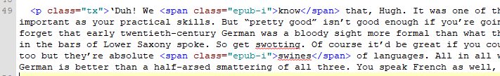

As for simple plurals snd posessives, they should in fact be added to the wordlist corpus. When affix compressed (munched) the plurals are properly detected and the suffixes are stripped and replaced with a flag hich keeps the root word list (.dic) small but word coverage large. That is the whole point of affix compression.
That is what I would have expected, but not what I experience in practice -
as you can see from these screen shots.
The word 'swines' has been highlighted as misspelled.
Removing the 's' corrects the problem
But (as you can see) swines is the valid plural of swine.
Do please do generate your UK wordlist (no need to check each one) we can do that via scowl. Include all variations of the word you have encountered.
We can fix the en based dictionaries.
OK, I will upload it later.

In common US English, the plural form of "swine" is in fact "swine" not "swines". I would guess your online dictionary is not quite correct in regards to this particular word, especially for US english.
But this may also be a point of divergence between GB vs US based dictionaries.
