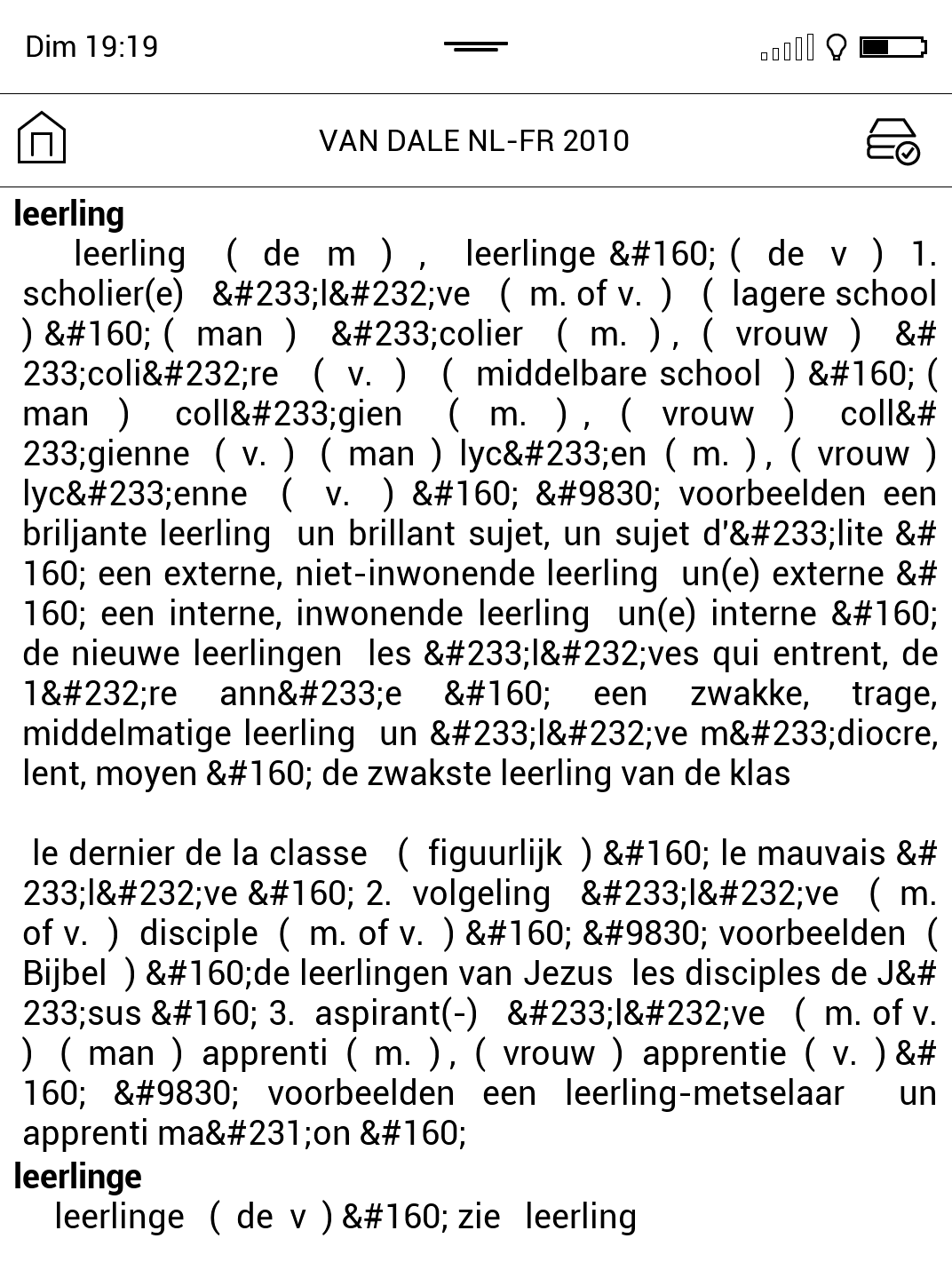

@Markismus amazing work, thank you so much!
I'm using your VanDale Groot Woordenboek Nederlands-Frans (2010)_reconstructed_Feb19th2021.dic, but it has a lot of XML entities instead of Unicode characters. They appear as entities in the Pocketbook dictionary application, and don't appear at all in the quick dictionary popup of the normal ePub reader. I haven't tried in Koreader.
I looked at your script but I'm not super familiar with Perl. Perhaps https://github.com/Markismus/PocketB...ookdic.pl#L375 could be replaced with https://metacpan.org/pod/HTML::HTML5::Entities?

@Getkey Nice screenshot! If you're ready to test, I am willing to program a fix. I haven't had a Pocketbook since 2 years, so most newer features for Pocketbook are as yet untested.
This is easily seen from the tail end of the script. "Create Stardict Dictionary" runs from line 1696 to 1745, while "Create Pocketbook Dictionary" runs from line 1749 to 1756. That ten-fold lines for the tested conversion.
Line 375 actually replaces '&' symbols in the text that are _not_ followed by a html-codepoint with the escape character '&' This to prevent errors in parsers that do look at escape sequences.
These entries seem to use a decimal escape sequence. So 160->nbsp, 233->é, 232->è, etc. However, 9830->♦, which seems odd.
Non-breakable spaces (&160 are in fact converted to codepoints at line 971 and further:
sub convertNonBreakableSpacetoNumberedSequence{
	my $UnConverted = join('',@_);
	debugV("Entered sub convertNonBreakableSpacetoNumberedSequence");
	$UnConverted =~ s~\ ~*~sg ;
	my @Converted = split(/$/, $UnConverted);
	return( @Converted );}
Which are converted to characters in the next subroutine at l.977:
[code]
sub convertNumberedSequencesToChar{
debugV("Entered sub convertNumberedSequencesToChar");
$UnConverted =~ s~\&\#x([0-9A-Fa-f]{1,6});~chr("0x".$1)~seg ;
$UnConverted =~ s~\&\#([0-9]{1,6});~chr(int($1))~seg ;
return( split(/(\n)/, $UnConverted) );}
[\code]
So the questions is not whether we need another dependency, but why the subroutine is not used or fails for Van Dale FR-NL 2010.
In line 1621 and further sub removeInvalidChars is defined and it also replaces some Perl characters codepoints. Also odd that those remain, if the subroutine convertNumberedSequencesToChar is called.
So when is it called? Apparently, it is called if the SameTypeSequence is not "h". In line 1682 and further:
# If SameTypeSequence is not "h", remove � sequences and replace them with characters.
if ( $SameTypeSequence ne "h" ){
	@xdxf_reconstructed = convertNumberedSequencesToChar(
							convertNonBreakableSpacetoNumberedSequence( @xdxf_reconstructed )
So if you introduce an extra toggle, e.g.
my $ForceConvertNumberedSequencesToChar = 1;
if ( $SameTypeSequence ne "h" or $ForceConvertNumberedSequencesToChar or $isCreatePocketbookDictionary){
You could test whether the results are nicer for the Pocketbook.
If you aren't able to run the script yourself, I am willing to give it a whirl and send you the result if you're willing to test.

I've just looked at the xdxf-article. It is definitely not filtered.
<ar>
<head><k>leerling</k></head><def><p><span style="font-weight:bold;">leerling</span> <span style="font-style:italic;">(</span><span style="font-style:italic;">de</span><sup>m</sup><span style="font-style:italic;">)</span><span style="font-weight:bold;">, </span><span style="font-weight:bold;">leerlinge</span>*<span style="font-style:italic;">(</span><span style="font-style:italic;">de</span><sup>v</sup><span style="font-style:italic;">)</span><br/>1. <span style="font-style:italic;">scholier(e)</span><br/><span style="font-weight:bold;">élève</span><span style="font-style:italic;"> (</span><span style="font-style:italic;">m. of v.</span><span style="font-style:italic;">)</span><br/><span style="font-style:italic;">(</span><span style="font-style:italic;">lagere school</span><span style="font-style:italic;">)</span>*<span style="font-style:italic;">(</span><span style="font-style:italic;">man</span><span style="font-style:italic;">) </span><span style="font-weight:bold;">écolier</span><span style="font-style:italic;"> (</span><span style="font-style:italic;">m.</span><span style="font-style:italic;">)</span>, <span style="font-style:italic;">(</span><span style="font-style:italic;">vrouw</span><span style="font-style:italic;">) </span><span style="font-weight:bold;">écolière</span><span style="font-style:italic;"> (</span><span style="font-style:italic;">v.</span><span style="font-style:italic;">)</span><br/><span style="font-style:italic;">(</span><span style="font-style:italic;">middelbare school</span><span style="font-style:italic;">)</span>*<span style="font-style:italic;">(</span><span style="font-style:italic;">man</span><span style="font-style:italic;">) </span><span style="font-weight:bold;">collégien</span><span style="font-style:italic;"> (</span><span style="font-style:italic;">m.</span><span style="font-style:italic;">)</span>, <span style="font-style:italic;">(</span><span style="font-style:italic;">vrouw</span><span style="font-style:italic;">) </span><span style="font-weight:bold;">collégienne</span><span style="font-style:italic;"> (</span><span style="font-style:italic;">v.</span><span style="font-style:italic;">)</span><br/><span style="font-style:italic;">(</span><span style="font-style:italic;">man</span><span style="font-style:italic;">) </span>lycéen<span style="font-style:italic;"> (</span><span style="font-style:italic;">m.</span><span style="font-style:italic;">)</span>, <span style="font-style:italic;">(</span><span style="font-style:italic;">vrouw</span><span style="font-style:italic;">) </span>lycéenne<span style="font-style:italic;"> (</span><span style="font-style:italic;">v.</span><span style="font-style:italic;">)</span>*<br/>♦ voorbeelden<br/>een briljante leerling<br/><span style="color:#472565;">un brillant sujet, un sujet d'élite</span>*<br/>een externe, niet-inwonende leerling<br/><span style="color:#472565;">un(e) externe</span>*<br/>een interne, inwonende leerling<br/><span style="color:#472565;">un(e) interne</span>*<br/>de nieuwe leerlingen<br/><span style="color:#472565;">les élèves qui entrent, de 1ère année</span>*<br/>een zwakke, trage, middelmatige leerling<br/><span style="color:#472565;">un élève médiocre, lent, moyen</span>*<br/>de zwakste leerling van de klas<br/><span style="color:#472565;">le dernier de la classe</span><br/><span style="font-style:italic;">(</span><span style="font-style:italic;">figuurlijk</span><span style="font-style:italic;">)</span>*<span style="color:#472565;">le mauvais élève</span>*<br/>2. <span style="font-style:italic;">volgeling</span><br/><span style="font-weight:bold;">élève</span><span style="font-style:italic;"> (</span><span style="font-style:italic;">m. of v.</span><span style="font-style:italic;">)</span><br/>disciple<span style="font-style:italic;"> (</span><span style="font-style:italic;">m. of v.</span><span style="font-style:italic;">)</span>*<br/>♦ voorbeelden<br/><span style="font-style:italic;">(</span><span style="font-style:italic;">Bijbel</span><span style="font-style:italic;">)</span>*de leerlingen van Jezus<br/><span style="color:#472565;">les disciples de Jésus</span>*<br/>3. <span style="font-style:italic;">aspirant(-)</span><br/><span style="font-weight:bold;">élève</span><span style="font-style:italic;"> (</span><span style="font-style:italic;">m. of v.</span><span style="font-style:italic;">)</span><br/><span style="font-style:italic;">(</span><span style="font-style:italic;">man</span><span style="font-style:italic;">) </span>apprenti<span style="font-style:italic;"> (</span><span style="font-style:italic;">m.</span><span style="font-style:italic;">)</span>, <span style="font-style:italic;">(</span><span style="font-style:italic;">vrouw</span><span style="font-style:italic;">) </span>apprentie<span style="font-style:italic;"> (</span><span style="font-style:italic;">v.</span><span style="font-style:italic;">)</span>*<br/>♦ voorbeelden<br/>een leerling-metselaar<br/><span style="color:#472565;">un apprenti maçon</span>*</p></def>
</ar>
After forcing the conversion it looks like this:
<ar>
</ar>
And the coding agrees that '♦' is a diamond. (As does this forum, that upon saving this post converts '&# 9830;' immediately to '♦'.)

I've uploaded the new Dutch-French dictionary to the pCloud. Its filename ends with ..Nov14th2021.dic
The html-escape sequences for symbols should be gone. Do you have a problem with the remaining color-styling or does the conversion rip that right out?

@Markismus, this is great! Works very well, see the scr0004.png and scr0008.png. And thanks for the explanation!
I think the ♦ are normal and are meant as a sort of separator.
Nope it's perfect. The only "issue" is that in the PocketBook dictionary app, the ♦ are displayed as □ (see scr0004.png). It works in the quick dictionary popup however. So it seems the issue is on PocketBook's side and can be ignored (it's minor anyway ).

After adding <0x00> to the subroutine removeInvalidChars and rerunning the script for Duden the entry generated is:
<ar>
<head><k>a</k></head><def><sup>i.</sup><blockquote><span><span><b>a, </b><b>A </b>das; - (UGS.: -s), - (UGS.: -s) [mhd., ahd. a]: <b>1.</b> erster Buchstabe des Alphabets: <i>ein kleines a, ein großes A; </i> <i>eine Broschüre mit praktischen Hinweisen von A bis Z (unter alphabetisch angeordneten Stichwörtern); </i> <b>R </b>wer A sagt, muss auch B sagen (wer etwas beginnt, muss es fortsetzen u. auch unangenehme Folgen auf sich nehmen); <sup>*</sup><b>das A und O, </b>(SELTENER:) <b>das A und das O </b>(die Hauptsache, Quintessenz, das Wesentliche, Wichtigste, der Kernpunkt; urspr. = der Anfang und das Ende, nach dem ersten [Alpha] und dem letzten [Omega] Buchstaben des griech. Alphabets); <sup>*</sup><b>von A bis Z </b>(UGS.; von Anfang bis Ende, ganz und gar, ohne Ausnahme; nach dem ersten u. dem letzten Buchstaben des dt. Alphabets). <b>2.</b> ‹das; -, -› (MUSIK) sechster Ton der C-Dur-Tonleiter: <i>der Kammerton a, A.</i> </span></span><span></span></blockquote>
<sup>ii.</sup><blockquote><span><span><small><sup>1</sup></small><b>a</b>= a-Moll; Ar.</span></span><span></span></blockquote>
<blockquote><span><span><small><sup>2</sup></small><b>a</b> ‹Präp.› [ital. a &lt; lat. ad = zu]: auf, mit, zu (in ital. Fügungen, z.*B. a*conto, a*tempo).</span></span><span></span></blockquote></def>
</ar>
Note that the '>' symbol is still formatted as the html-codepoing '&lt;'. is this also not displayed properly, just as '&apos;'?

I've created a subroutine to remove the html-escape characters:
sub unEscapeHTMLString{
    my $String = shift;
    $String =~ s~\&lt;~<~sg;
    $String =~ s~\&gt;~>~sg;
    $String =~ s~\&apos;~'~sg;
    $String =~ s~\&amp;~&~sg;
    $String =~ s~\&quot;~"~sg;
    return $String;}
The entry for rectum is now generated as:
<head><k>rectum</k></head><def><b>rec</b>‧<b>tum</b></c> /ˈrektəm/  <i><c> noun</c></i> (<i>plural </i><b>rectums</c></b><i> or</i> <b>recta</c></b> /-tə/) [countable]</c><i> medical</c></i>
<blockquote>[Date: </c>1400-1500</c>; Language: </c>Modern Latin</c>; Origin: </c>rectum intestinum</c> </c><i>'straight intestine'</c></i>]</blockquote>
<blockquote> the lowest part of your ↑<kref>bowel</kref>s</c> ⇨ <b>rectal</b></blockquote></def>
</ar>
@GetKey Could you check whether the Longman Dictionary of Nov15th displays without html-codes?
