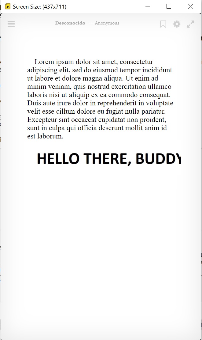

@Jellby - I think I'm seeing the difference between our two codes, and I don't really understand what the implications are:
Basically, in your test version the height is defined at the <div> level, not the <img> level, resulting in the correct scaling that you observed. I'm confused, though, why definiing the height at the <img> level would result in squishing, and I'm wondering if there are any other unintended consequences depending on which level the height/width values are assigned. Do you know?
EDIT: Welp, I've found unintended consequences...
Whatever protocol PageEdit is using to parse height/width values defined at the <div> results in the image going off the screen (see test3, attached).
And in the EpubJSReader Sigil plugin it cuts off part of the right-hand side of the image (see test4).
