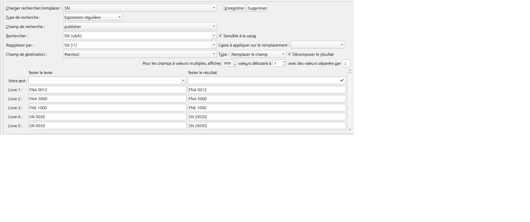

Just one more question .
As you can see on the image file , the filter is correctly applicated but it takes also others formats in the destination ?
How to applied ONLY SN (\d{4})
search&replace take action on rows where the filter it's not applicated ... strange . the "do_nothing" in my if/then/else doesn't work
Thanks for your help
Exemple : if publisher is "Flammarion" you will have in Series2 Flammarion!!! It should be empty

Old 02-06-2023, 01:30 PM   #8
Doum
Doum began at the beginning.
Posts: 30
Join Date: Jun 2020
Device: Kobo Aura HD
what kind of error ?
Thanks for your answer
Yes it does the job on all selected rows but it's also copy all not selected rows in my columns #series2 form publishers as you can see on the image SN3.png
The filter it's not exclusive
And after i aplied, the result it's on SN4.png with wrongs results
So if it's should works as you said, i made a mistake .
Perhaps on the result field, a special syntaxe ?!?

Old 02-06-2023, 02:14 PM   #9
Posts: 28,440
Karma: 48895676
Device: Kobo Libra2,Kobo Aura2, K4NT(Fixed: New Bat.), Galaxy Tab A
You did not First use The Library Search to only select books that start with:
publisher:~SN (\d{4})
Then use Bulk mode to do the move
