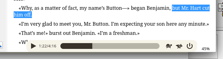

I have tried it with this Audio-ebook here:
https://www.readbeyond.it/ebooks/b7b497df.html
See attached picture: a bar appears, Calibre is highlighting the sentences, but I hear no sound.

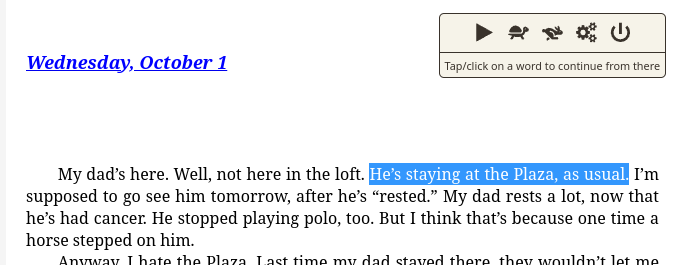

When I try Read Aloud with a regular ebook, without embedded audio, then I do hear audio. See the other attached screenshot. Now the bar appears at the right top instead of the bottom center. It has an extra icon to configure the voices.

Well actually, now that I think about it, the next release is basically adding support for the audio/mpeg format to the calibre viewer. MP3 should work already and does for me, which is what the audio ebook sfrom read beyond use. The symptom you describe of audio not playing is something else, probably related to some incompatibility on Linux or the other. Use the official calibre binaries and see if it works.

As I have mentioned before, I do hear audio for the TTS Read Aloud, so audio is partially working. Just not when it should be playing back the embedded audio files.
