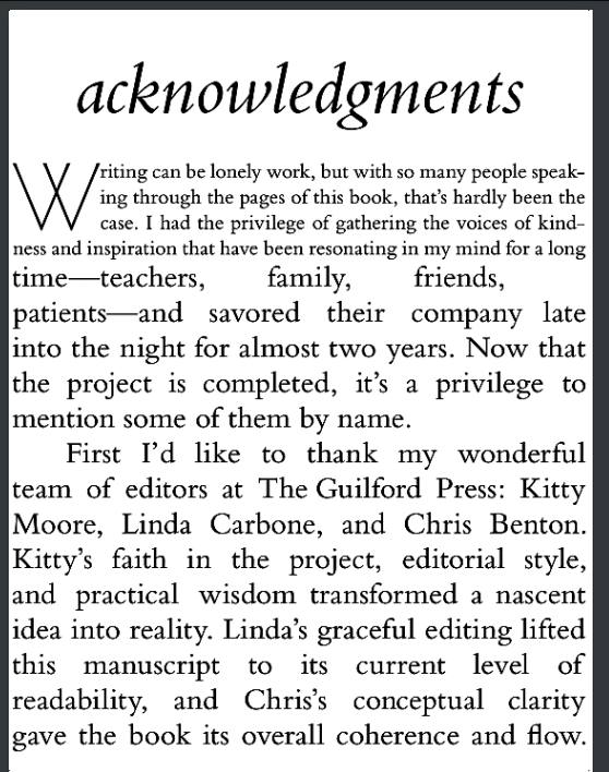

Are you still working on the project?
Do you have plans on fixing Big first letters ( drop cap )
It is really boring
