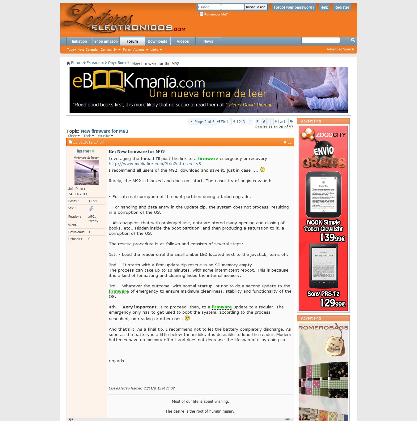

I installed the update from
https://onyx-boox.com/support/firmware/
it upated it but after the reboot it freezes on the last black 'brick' start screen. If I remove the SDCard and reboot it (with reset and power) it freezes.
Any idea what to do? Is there a recovery mode where I can completely reflash the system? Any other ideas?
Updates from onyx-boox.com (artactech) are for ereaders purchased from them.
Updates given here work on devices from http://ereader-store.de/ or other distribution channels. I guess you already know this but check if the problem is due to wrong firmware.
Check this post if it is of any help:
https://www.mobileread.com/forums/sho...8&postcount=10
If I press the Joystick button on reboot it says:
No update found booting ... and after some seconds it freezes.
Maybe because I already have installed this update? Is there a way to a forced downgrade? Or a newer beta firmware to install it over.
I have very little experience with troubleshooting.
I just remembered this post regarding emergency firmware and directed you to that. I first read about this emergency firmware at Lectores Forum and i have attached the screen shot.
I hope somebody else replies to your query or you should make a new topic in the forum.

Thanks, with the help of a program called mfgtools and the guy from the EReader Store I could reflash and revive my device.
Kudos to their support.
