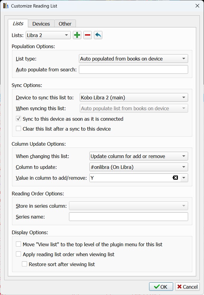

Does anyone know if it is possible to apply a custom column coloring only if a particular reading list is active?
sgmoore is offline   Reply With Quote
Old 09-02-2025, 04:24 PM   #1430
Posts: 84,122
Karma: 153695583
Yes you can. You can setup a custom Y/N column and use that to define the coloring.
Here is what I do to mark what eBooks are on my Libra 2.
Attachment 217849
Thanks, that should do what I want.
