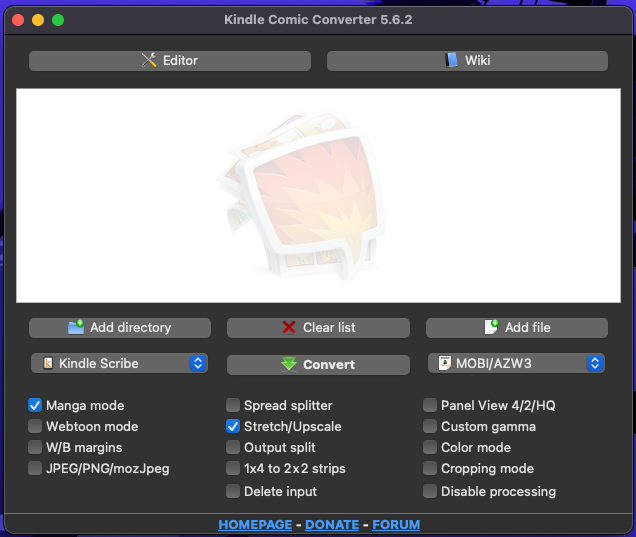

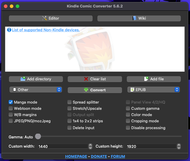

I wanted to report an issue I'm seeing with the latest version (version 5.6.2). I'm using the new Kindle Scribe profile. The conversion is not scaled properly on every page. There is an empty border - sometimes on the top and left, sometimes on top and right etc. Sometimes there is no border and it's perfectly scaled. The end result is that image 'jumps' from left to right or changes in scale depending on whether it is scaled to full screen or not, or which side has the empty border. However, if you use the 'Other' setting and with 1440x1920 resolution, each page is scaled perfectly. (I'm not using the native Scribe resolution since Kindlegen will downscale it anyway). In either case, it doesn't matter whether the 'Stretch/Upscale' setting is ticked or not. The output remains the same (i.e. the 'Kindle Scribe' setting version is not scaled properly, which the Other 1440x1920 resolution is scaled properly).
Also, not sure if it matters - I'm starting with a 188.2MB CBZ file. The Kindle Scribe setting version gets converted to a 118.6MB file, while the Other 1440x1920 version gets converted to a 158.2MB file.
Conversion using the 'Kindle Scribe' version is indeed slightly faster (but not by much). It seems like the 'Kindle Scribe' preset has some issue where the image is not getting scaled perfectly.
Edit: Note - In case anyone is not aware, I'm using 1440x1920 resolution since that's the maximum resolution that Kindlegen outputs to. Using the native resolution will downscale the image to this size anyway, and it is extremely slow (Takes 15-20min instead of the typical 1-2min).

You better provide more information, like OS, screenshot of KCC settings, folder structure, image dimensions, etc.
Also try a beta build exe. There's on linked in one of the active PRs.
And where did you get kindlegen?
I feel.like youay have activated panel view by mistake which is buggy with certain resolutions. Disable it by double tapping image.
GitHub issue is probably easier for images.

Thanks for replying. Sorry, it took me some time to get back to this, and take images. I've now tried multiple manga comics - 4 of them. All of them show the same behavior. The 'Kindle Scribe' preset does seem to be behaving incorrectly. This is also seen in the file sizes. The 'Kindle Scribe' preset file size for the .mobi output is about 25% to 30% smaller than the 'Other' preset with 1440x1920 resolution. I've tried transferring the files directly and via Calibre to see if Calibre is causing any issue. The behavior remains the same in every case.
Here are some relevant details that you had asked for -
1) I'm using Mac OS (Ventura 13.4.1) on an Intel Mac Mini
2)I've not tried a beta build. I'll try it later and let you know if I see any changes.
3) I was using kindlegen extracted from Kindle Previewer. But then since the latest version supports Kindle Previewer directly, I simply removed the kindlegen files from the /usr/bin folder. From the update notes for KCC I figured that the latest version simply picks it up from Kindle Previewer 3. So I installed that software in my Applications folder, and then KCC started working as usual.
3) Pretty sure I didn't activate panel view. In fact on Kindle Scribe I can't even get it to activate on any of the converted mobi's. Both versions of the converted comic were simply opened and could immediately tell the difference within a few pages.
4) The only settings I am using are -- Manga Mode (ticked), Strech/Upscale (ticked; fully ticked, not the partial hyphen). No other setting for either Kindle Scribe preset, or the 'Other' preset. In case of other, I'm setting Custom width 1440; Custom height 1920. Images for settings for both modes are attached.
I've attached a few images showing the issue. Same pages for two different manga. You can see how for the 'Kindle Scribe' preset the images are not filling the entire page. On some other pages, the whole page is filled, but the image is not centered. There is a wider gap on the left or right.

Ah, you are on Mac, that changes things. There are only windows betas for now in that PR. My advice:
1) Try updating to Kindle Previewer 3.72 and moving kindlegen to /usr/bin/local. I feel like a slightly older version (3.71?) had some formatting issues that were fixed. Might be mis-remembering though.
2) Leave Stretch/Upscale unchecked.
3) I personally use MozJpeg and partially check split. Not sure if it will change anything but worth trying.
Maybe try running the latest master, instructions here: https://github.com/ciromattia/kcc/wi...l-from-sources
I've had zero issues running KCC on either Windows or Mac, but I only run from source to get all the latest features and bug fixes.

So, some minor updates.
On the Mac side, I was already on the latest version of Kindle Previewer. I did move kindlegen to /usr/local/bin and tried again (deleted Kindle Previewer from the computer). It did not make any difference.
I then logged into Windows (I have a windows partition on my Mac). Downloaded KCC, and tried it in windows. Tried all various combinations of check-boxes - with and without upscale, mozjpeg. Whatever the case, the behavior remains the same in windows as well.
I did play around with settings quite a bit. At this time, I'm convinced that the 'Kindle Scribe' preset does not work as well as the 'Other' preset set to 1440x1920.
I did not try downloading the beta versions. The instructions seemed like it would take time for me to figure out, and frankly it's not needed. The Other preset works quite well. Just want to report to the community here that the 'Kindle Scribe' preset doesn't work perfectly. Better to use the 'Other' preset with the custom resolution set to 1440x1920.
That being said, I'm curious to know if the preset works perfectly for others. I have now tried 4 different manga, and tried in both Mac and Windows, and played around a lot with the settings. The 'Kindle Scribe' preset doesn't scale the pages full screen perfectly. Anyone just reading this post, see the images I attached a few posts above. You'll know what I mean.
Not sure what's the best way to inform the developers, but if someone can point this to them, it might help.
pumpkinwhite is offline   Reply With Quote
