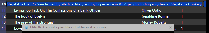

Hi folks, I've been getting some glitch upon double-clicking files on list view. Can't remember when it started to happen, unfortunately. Before going into the description, let me state clearly what conditions don't trigger the error message:
a) double-clicking in Cover grid view is unaffected.
b) it doesn't happen when the event "Book List Double Clicked" is unchecked.

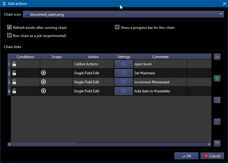

Now I'll try to explain. I have a chain with the following actions, kindly provided by ownedbycats, that runs on event "Book List Double Clicked":
- open book
- set #lastread
- Increment #timesread
- add date to #readdates
On list view, when I double-click the title of a book that contains a PDF format (which is my default "preferred input format" in Behaviour preferences, for double-clicking priority purposes), it runs the chain fine, sets all fields correctly. However, when I task-switch back to Calibre from my default system PDF program, the title cell shows as if waiting for an input, I mean, it's been inadvertently selected for editing, as if I had pressed F2.
What happens next is that, even without making any changes to the title field, when I click anywhere outside the title cell, I get the message in the attached log - "PermissionError: [WinError 32] The process cannot access the file because it is being used by another process"
Also, that will occur either when I have the tweak doubleclick_on_library_view set to 'open_viewer' or to 'do_nothing'. Since I started using this chain, I use the latter (do_nothing).
I wonder if some tweak to the "Book List Double Clicked" event or to the chain itself could prevent that?

Won't help with the unintentional selection, but the esc key should back out of accidental edits without the error.
yes, I've too found esc is a quick workaround for that.. but only after the error message, which is what I'm wondering if can be prevented
edit: well, what I actually wanted to mean is that pressing Esc prevents the message, but there's something else related to focus I can't precisely describe

I am not able to replicate. If by any chance you have the following plugin tweak set:
action_chains_single_click_edit = True
Try removing it and restart calibre, and see whether it makes a difference. This was useful to solve a problem that seem to have been resolved in recent calibre versions.
yes, that was it!
once I removed that plugin tweak, issue is resolved!
I can't remember why I've needed to set it, by the way, but hopefully this removal won't affect other chains.
Try removing it and restart calibre[...]
Oh well, I realised single-click editing on list view is actually indispensable to me, so I did some extra testing and I guess I found something worth mentioning.
After reinstating the action_chains_single_click_edit plugin tweak, I tested different double-click speeds, either by alternating between purposely delayed double-clicks and fast ones or by changing the double-click speed setting on Control Panel (setting it to the fastest level available).
I'm still testing those settings but as of now I can "double-click to open" on list view without having that issue most times. It seems that the higher the double-click speed, meaning lower interval between the first and the second click, the less likely is that the issue will arise.
edit to add: actually I totally forgot that I had that tweak in place, so at some point I started to think it was a core Calibre option :amnesia_smiley:
