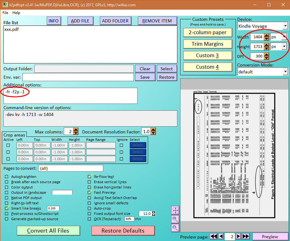

Dear Willus,
i try to another pdf file with your recommand. My ideal is for the tables, figures, charts will be landscape mode fit to screen and the other pages is normal view, but maybe my command is not correct, when i enter the -fr and the figure (with drawed rectangule) is not only wide all page but also to the next page. so please you check and advise me

Originally Posted by Boyzzun View Post
Dear Willus,
Add the option -f2p -1 to fit the figure to one page. See attached screen shot.
