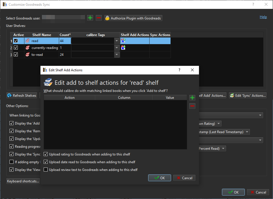

I have setup Kobo Utilities with the own columns that sync: Date Read and Read Percentage, etc.
With the GoodReads Sync I can sync my read status from Calibre to GoodRead but it is not syncing the Date Read.
It seems that can only be synced from GoodReads to Calibre and not vice versa, or am I missing something?
EDIT:
Never mind I figured it out
Needed to add Shelve actions

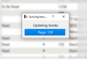

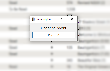

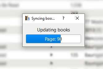

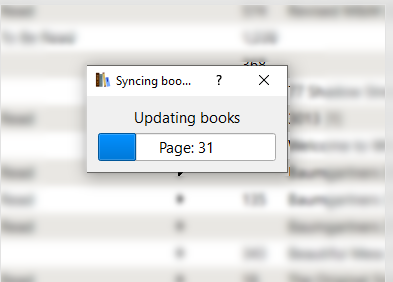

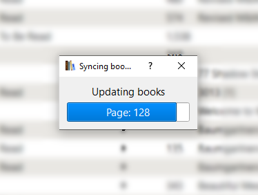

I am uploading screenshots with timestamps made today to indicate exactly what I am talking about when I say the plugin updates books slowly. I don't know if it is because of something to do with my library, or my setup, but Inoticed that when I created a blank library the books updated at the rate of 140 books 10 seconds. However when I synced the same 140 books on the shelf to another library with 4000 books (but no icon rules) it took 3:28 to finish.
The last version that worked for me (which I still use) is 1.12.1 It only runs on my Calibre 4.7 in 32 bit (I have the most recent version in 64 bit so I can use all the other programs).
The plugin that I downloaded today is the one that these screenshots refer to.
So, exactly what I am doing it syncing from a shelf
exactly what the plugin says "Updating Books"
Exactly what the performance problem is? - it takes 3 minutes to update 140 books
I am running on an HP Envy 17, with Windows 10, Calibre 64 latest version, 1TB SSD and 12G Ram. I am not using any other features. The quantity of books on the shelf make no difference. They update at the same rate. However, the plugin version 1.12.1 which is no longer supported will update the same books on the same shelf in the same library instantly.
A plain library with no other books but the ones I am syncing in will take 10 seconds. However, that is just for 140 books, I have many more shelves with more books, and my library has more columns.
The "hang time" that no one noticed because there wasn't a scroll bar to show, was less than 15 seconds for shelves holding 1000 books or less. I would never try and use this new version with anything near that. 140 books almost 3 and a half minutes. Also, that shelf was just a plain shelf without any rules except to upload a tags column.
Does this explain better?
Name:	Updating Books Page  2 --- 3_36_53 PM Start.png
ID:	182243   Click image for larger version
Name:	Updating Books Page 31 --- 3_37_32 PM 1 minute.png
ID:	182244   Click image for larger version
Name:	Updating Books Page 90---  3_38_53 PM 2 minutes 21 sec..png
ID:	182245   Click image for larger version
Name:	Updating Books Page 128-- 3_39_45 PM 3 minutes 12 sec..png
ID:	182246   Click image for larger version
Name:	Updating Books Page 139-  3_40_01 PM 3 minutes 28 sec..png

@Rellwood: One of the reasons I have never been able to look at this and fix it is that you never give any real information. As many times as you have reported this, this is the first time you have actually said "syncing from a shelf". And I have repeatedly asked you to tell me this. And while the screenshots a great, they don't tell me much, just that you are seeing a problem. Which you have stated before and I have never doubted was happening. Surprises yes, but, I have had no reason to not believe what you are stating.
I have asked for detailed steps of what you are doing, and never been told. You might think it is obvious, but, when the problem cannot be reproduced, you need to go back to basics and make sure everyone is on the same page. A simple thing, this is the first time you have even hinted whether the issue is with the communications with Goodreads, or when the calibre library is actually being updated.
I have asked for a debug log, and not received one. That will have accurate timings of what is happening. Then I can look at where exactly the time is being used. And, ideally, a debug log from the fast version as well.
Ok, exact steps. We are using my "g-f-horror" shelf (genre.fiction.horror)
This shelf has only one sync rule "add to '#currentbookshelves' genre.fiction.horror" it currently has
Sync from shelf. That's it. I am doing nothing else.
Click on the plugin,
Click on sync from shelf.
Select shelf. Wait for the following "Syncing from shelf g-f-horror" Page 1 (this is the status bar quick popup that shows before the list of shelves pops up)
Sync from shelf popup showing all the shelves, and the rules
Select "OK"
Now, this is where it takes time. This is the part from the screenshots.
Now that is all that I am doing. I am not doing anything else.
I can PM you the bug logs.
Rellwood is offline   Reply With Quote
