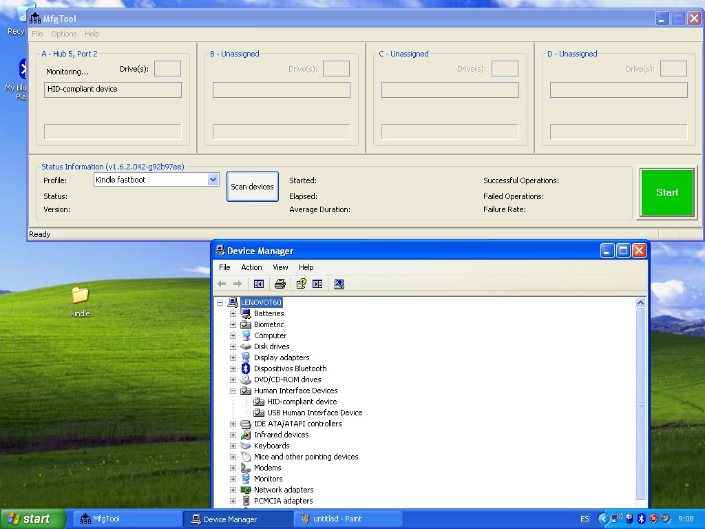

Briked K5
Hello everyone, first of all thank you very much for all the information and availability you have in this forum.
I have the following problem, a K5 does not start, but the battery if it is charged, try to recover it with Kubrik, but it is frozen in usb donwload mode.
Then I tried MfgTool, which leaves it in fastboot. But after that he is paralyzed again.
Finally I used the USB TTY cable, and I have the following dialog:

@Mr.Markus:
Sounds like multiple failures of the eMMC chip.
There is a thread here (somewhere) on replacing that chip if you have the hot air re-work tools to change it.

The first thing was to do a new installation of Windows XP, on an old computer.
and he stops at that point, he doesn't ask me to install drivers, it doesn't occur to me what else I could have done wrong.
I have a hot air gun, but I would have to order the replacement from China.
mr.markus is offline   Reply With Quote

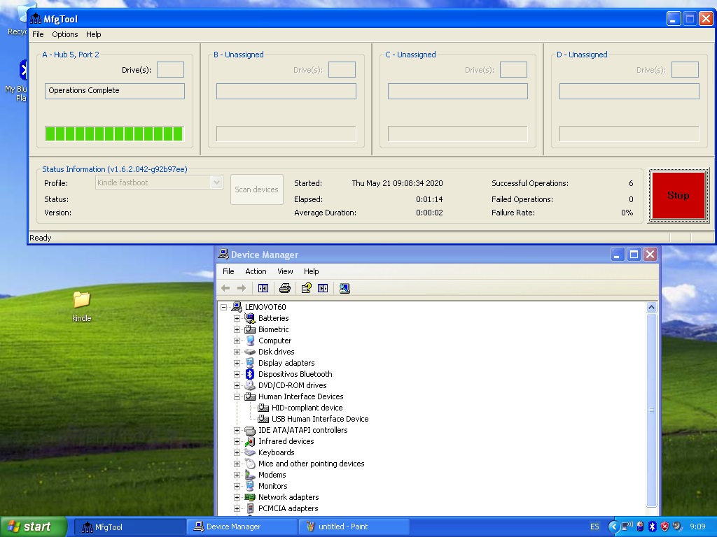

Excuse me, I had a problem uploading the images in the previous post...
ID:	179399   Click image for larger version

That profile name is "Kindle" ...
You might have the wrong profile.
The "Kindle Fire (i.e: color)" readers are Android and the "Kindle grayscale" models (this forum) are Amazon/Linux.
Both use a "fastboot" program but they are different!
Be sure you have the correct fastboot tool (such as from this forum, none other).
Old 05-21-2020, 04:03 PM   #1380
mr.markus
mr.markus began at the beginning.
Posts: 5
Join Date: May 2020
Device: K5 PW2018
Thanks again for your response and concern, I got the MfgTools file when I downloaded it in the KindleSelectBoot folder that appears in the Guide to debricking kindle touch v4, next to the Profile files.
[PROFILE]
PLAYER=Kindle fastboot
VERSION=2
[OPERATIONS]
UTP_UPDATE=OS Firmware,120,1
[OS Firmware]
UCL_INSTALL_SECTION=EMMC
Thanks again
