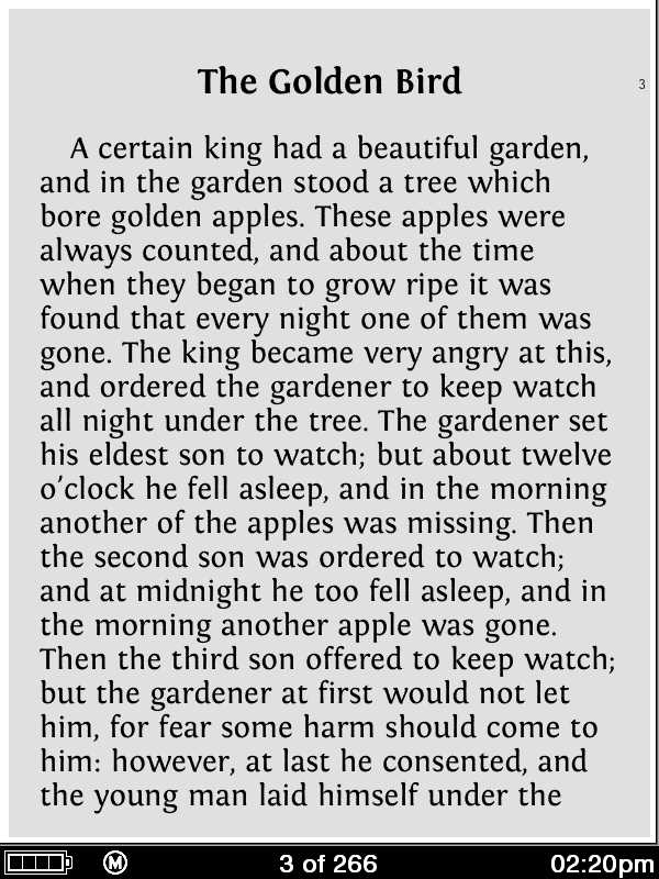

Just finished Already Dead in ePub using the font hack the Zelda linked me to (loved this book and would love another one with the lead character).
I loved the flexibility of being able to read it with the fontin font. One thing I noticed was that occasionally I would still have slow page turns. For maybe 10 pages in a row several times through out the book, I would see "formatting" during a page turn. I could see the new page under the "formatting" symbol but it still made the page turn 2 seconds or so long (about as slow as the embedded font LRF version of the book). The book was in the main memory. I removed the SD card with other books (only 2 books in the main memory) but I would still get the "formatting" symbol. I'm not sure what to do about this.

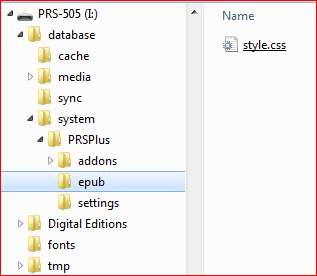

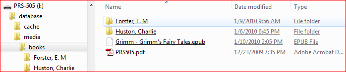

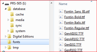

I finally figured out how make the font substitution work with PRSPlus so that I don't have to go through Calibre to embed the font.
Per the PRSPlus site.
(path to custom css is: internal memory /database/system/PRSPlus/epub/style.css)
I already had my fontin css file saved as a txt file. I just renamed a copy as "style.css" and droped it in the PRSPlus/epub/ folder. I already had a fonts folder per Zelada's instructions. I then downloaded a book from Feedbooks and moved it directly onto the 505 without every opening Calibre. It worked!
Now does anyone know how I would add the border parameter to my css file?

Hi daffy
thats a nice screen capture there, howd you do it?
