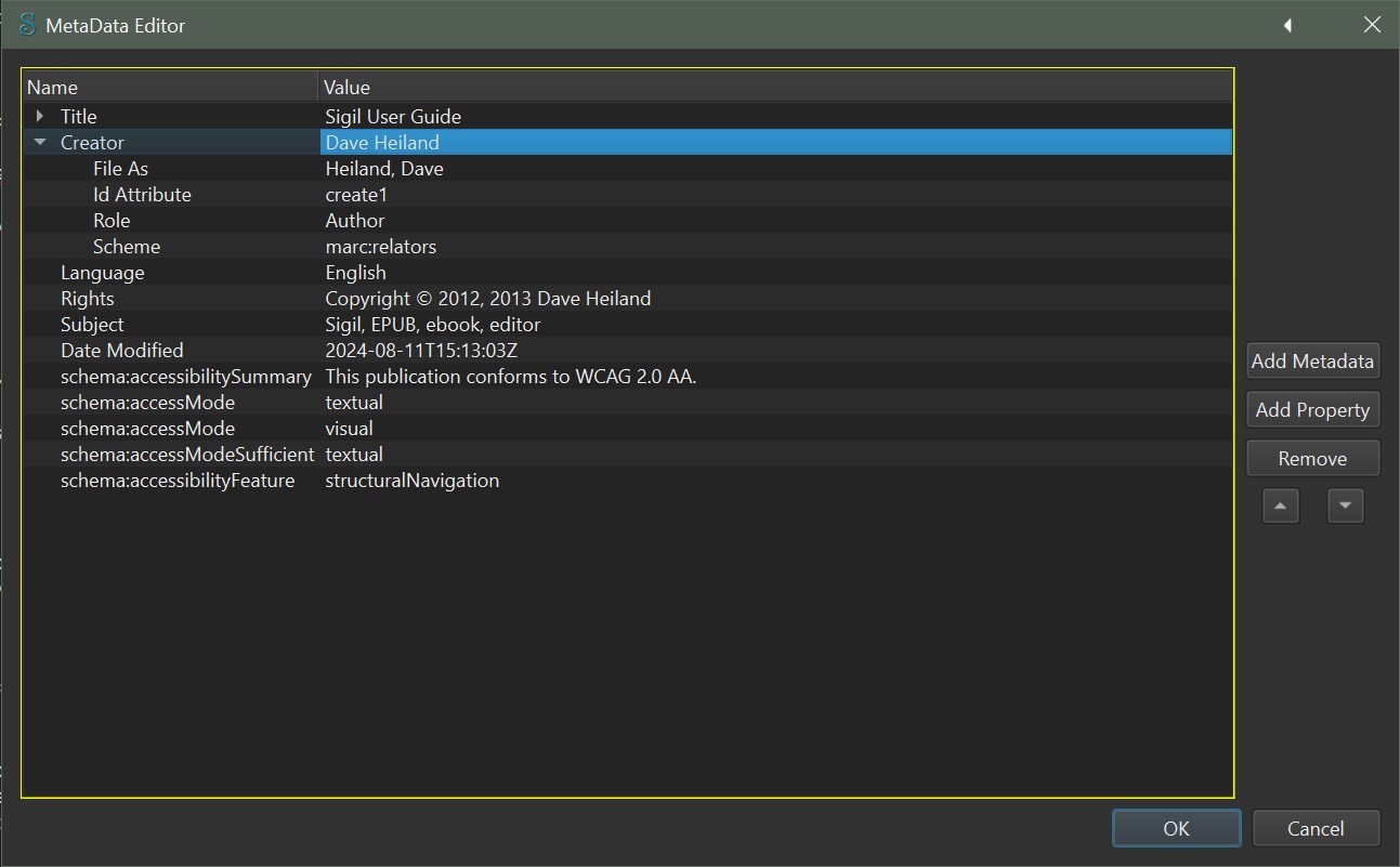

How do you launch the context popup menu without using a mouse? I thought the idea was you wanted a solution that was keyboard only.
By pressing the Application/Menu key ==>> https://en.wikipedia.org/wiki/Menu_key
Shift+F10 does the same, which I use on my Surface Go and Alien Alpha
Wouldn't assigning shortcuts to the buttons be better?
No, a context menu is almost always better, a) all options are shown, b) any that are not available are greyed out, c) if an option does have a shortcut it is shown… which acts a reminder.
As I said, your "irritant" does not happen on other platforms? Did you ever try right arrow to expand it followed by a second right arrow? Does that work?
Yep tried that
Open Sigil user guide and press F8, arrow down to Creator:
Press →
ID:	218657 Creator Tree opens
Press →
ID:	218658 Highlight moves DOWN to File as
Press →
ID:	218659 Highlight moves right to File as value
Press ↑
ID:	218660 Highlight moves up to Creator value
The problem is, as you alluded to before, the → and ← are serving two purposes:
1. to expand and collapse a branch
2: to move between the Name and Value columns.
How about using the ↓ and ↑ keys to expand and collapse a branch.
Nah, that won't work either… how about Ctrl+→ and Ctrl+← to expand and collapse.

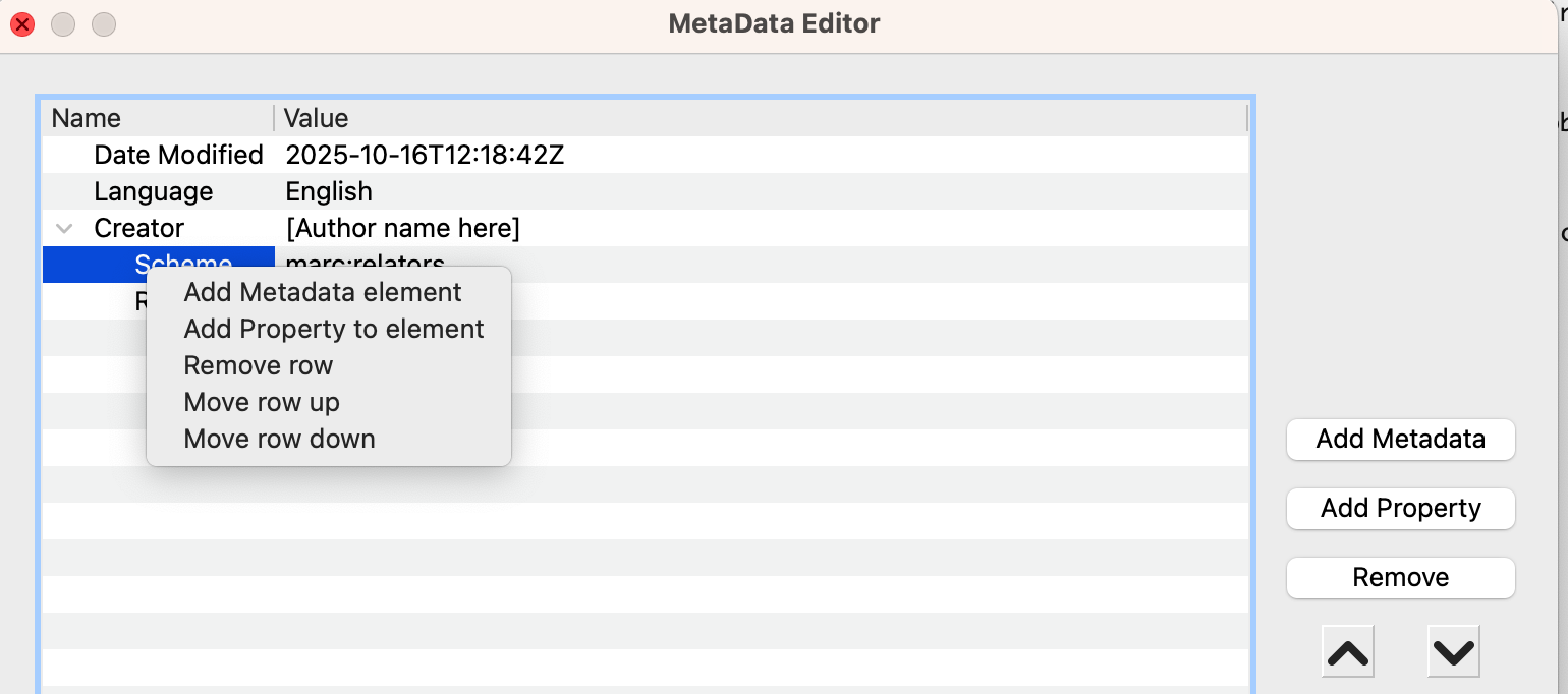

Okay I will take a shot at a Context Menu.
As for the "irritant" behaviour is built directly into the QTreeView class so it will take some work to subclass QTreeView and try to control how it work. Work that only seems to need to be done for Windows. I will see if that damn QStyleHint change will work.
KevinH is offline

@BetterRed
I took a shot at adding a short context menu to the Metadata Editor entire QTreeView.
See the screenshot below.
As for your "irritant" it appears to be an real "irritant" to me too as there is no easy way to make Windows work like MaOS without changing its theme.
So fixing this irritant may take some work, and might not be part of the next release.
