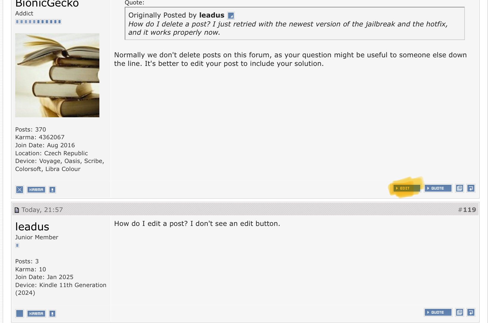

Originally Posted by leadus View Post
How do I edit a post? I don't see an edit button.
It should be right there on your post.

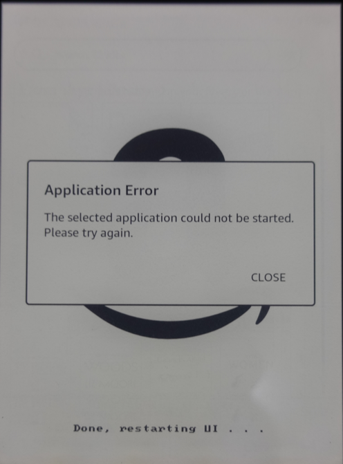

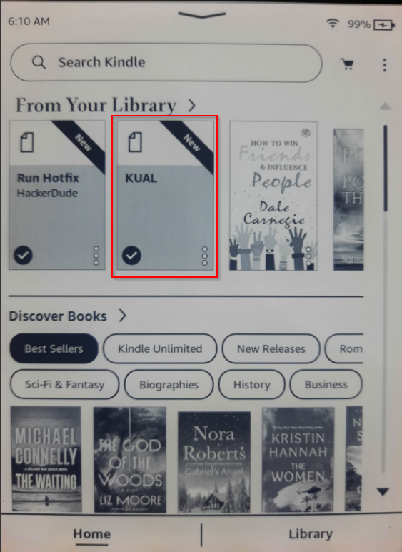

Hi, I try to Winter Jailbreak my Kindle Paperwhite 10th Edition (PW4 - My first 8th serial number is G8S0 PP12) that currently using Firmware Version 5.17.1.0.3 (4351860007) - 70971.
During Jailbreaking & hotfix, I found there is no issue, runs as expected.
(Please find the attached winterbreak.txt)
But during installing KUAL+MRPI, I got this "Application Error, the selected application could not be started. please try again". and the screen goes to the Home and found KUAL Book.
FYI, I use this file "Update_KUALBooklet_18b218e_install.bin" and put under mrpackages folder.
If I check to the mrinstaller.log I found "Illegal instruction", please find the attached mrinstaller.txt for the full log.
Can anyone advise on this?
If KUAL is there and runs normally when you open it then there's no issue, you can ignore any error during the installation, it happens often. Enjoy your jailbroken Kindle
It is not there. I only saw it a few minutes after I posted it, and then it was gone:
Hi BionicGecko, thanks a lot for your advises, glad that now I'm able to run KOReader on my Kindle by using Marek's koreader nightly builds.
