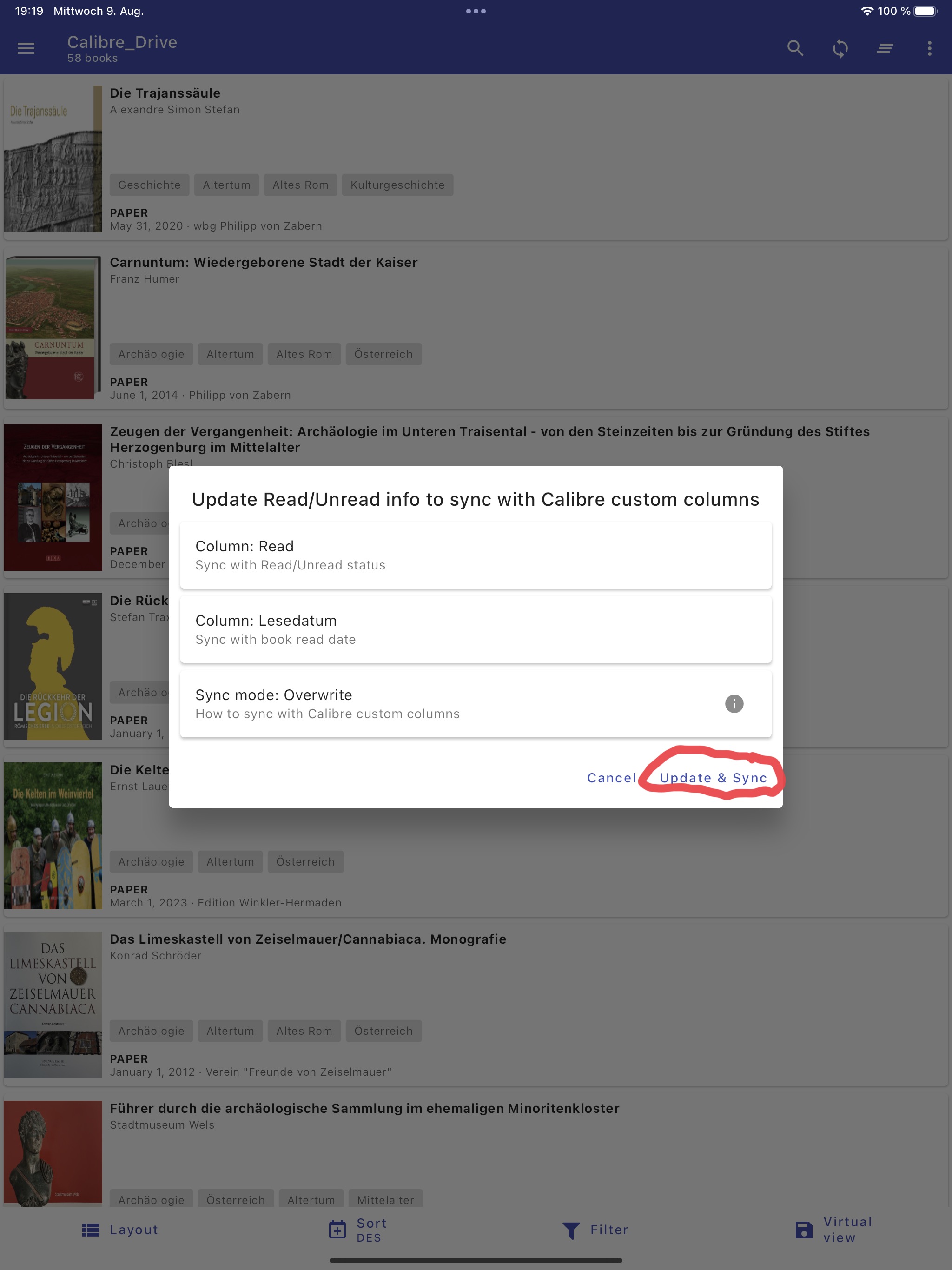

Thanks for your answer, which gives me hope. But I feel like a dope:
1. Make a yes/no column in Calibre? Call it "read"?
2. Sync Library to Calibre Sync
3. then sync the read status.
If that's correct, I no longer seem to have the ability to do step number three. There is box that shows the read status or sync.... There is also no edit sign next to the library path. It sounds like it works for you, so I'm hoping that you can give me the steps, as if I were a small child ��

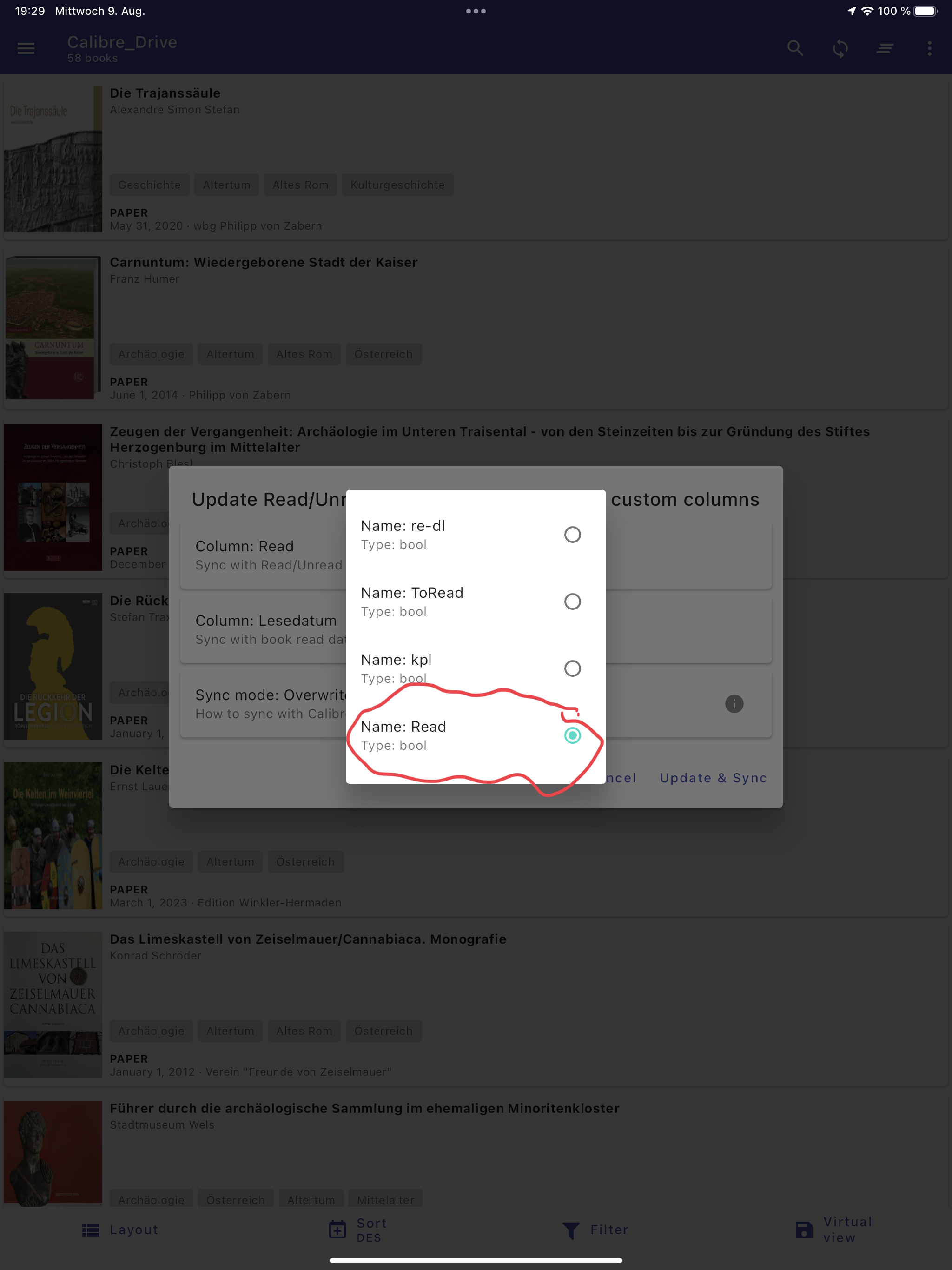

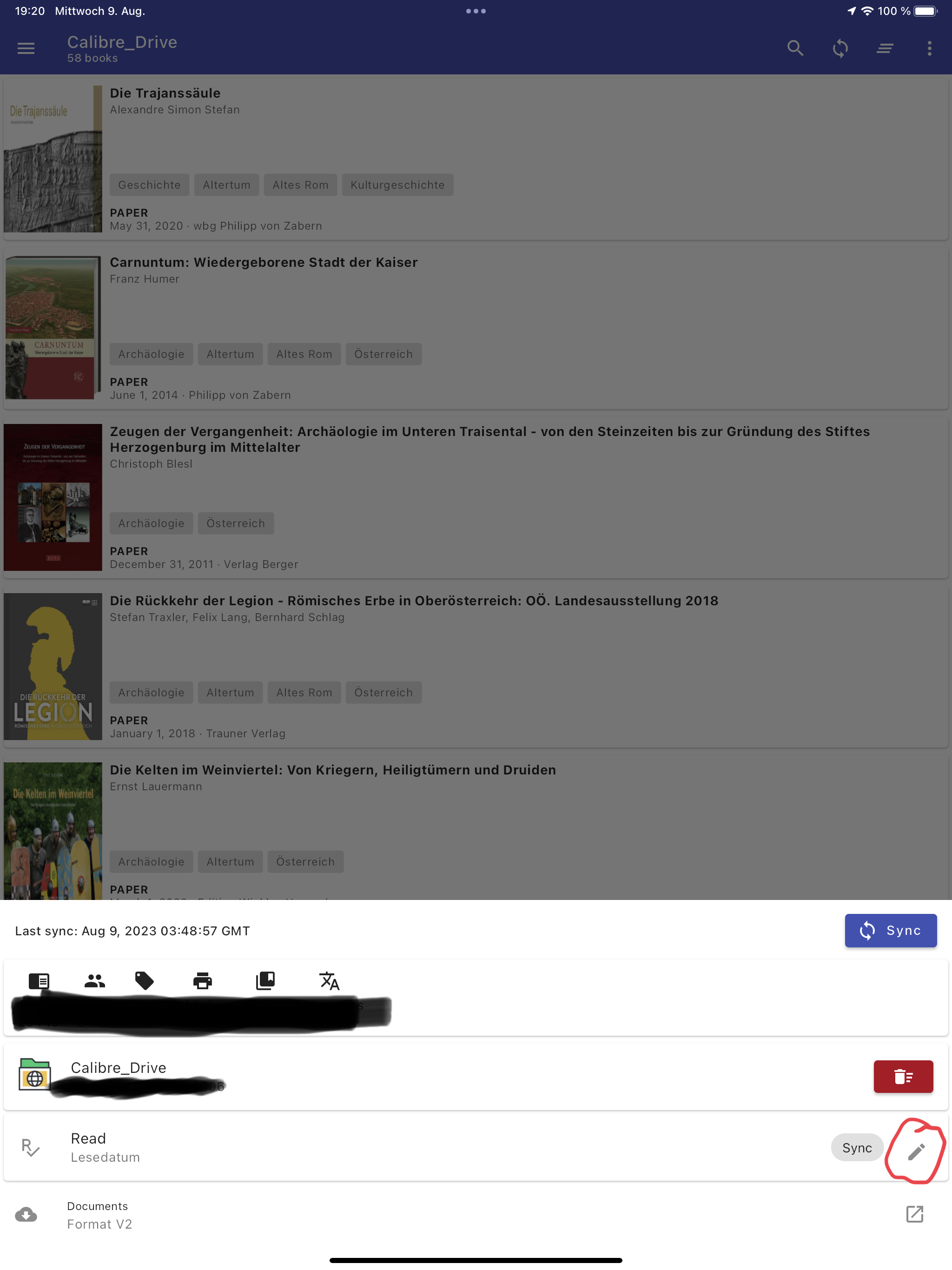

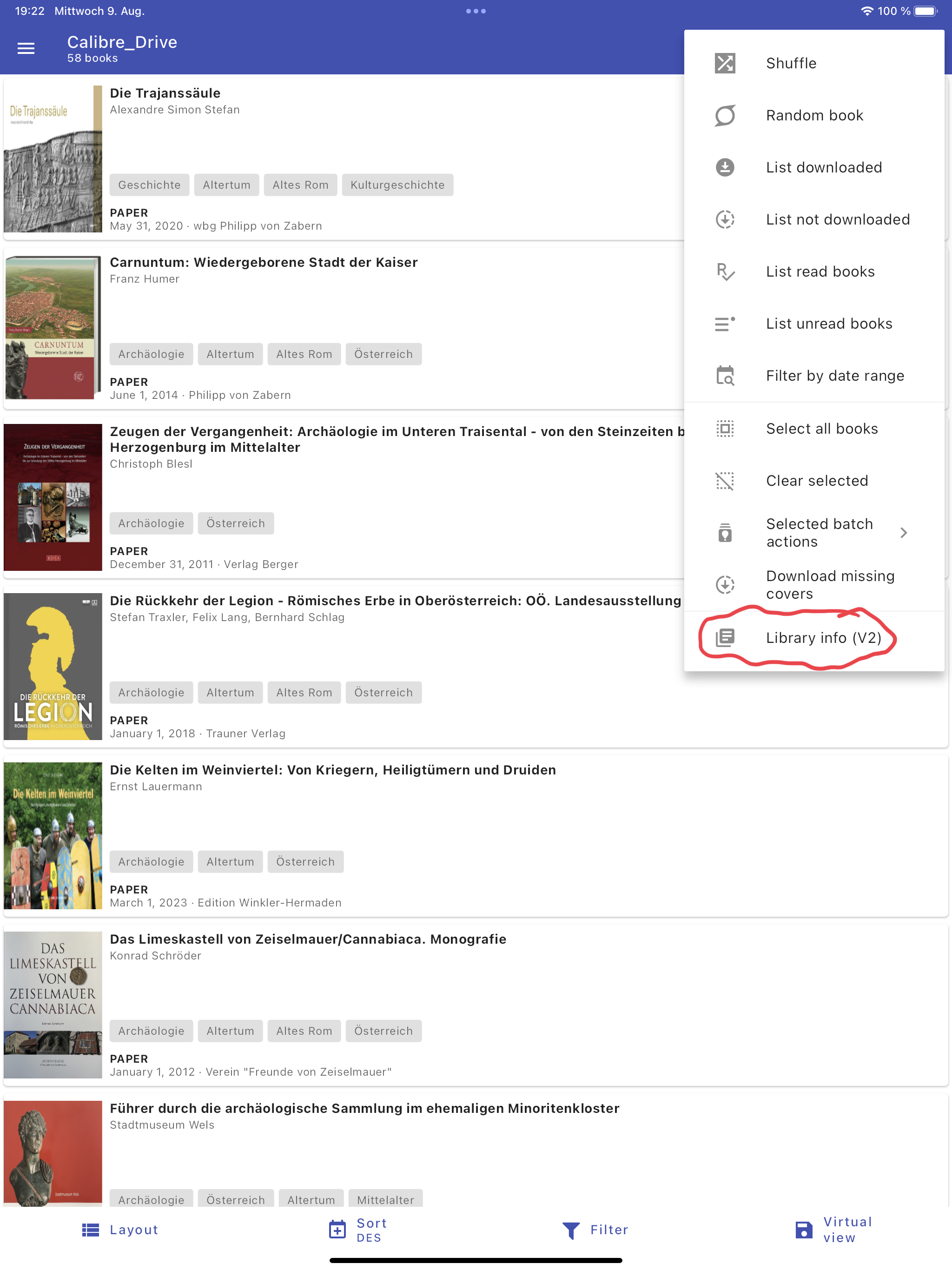

Yes, the steps are correct. For step 3 I attached pics in the order of steps

I connected my ipad as a smart device, copied an ebook to it and marked the ebook as read.
then i reconnected calibre sync but in calibre the read status is not changed
the menu from the first picture does not exist or i dont find it
when i want to delete the ebook, it only deletes the cbz ebook file but book entry still exists under smart device
