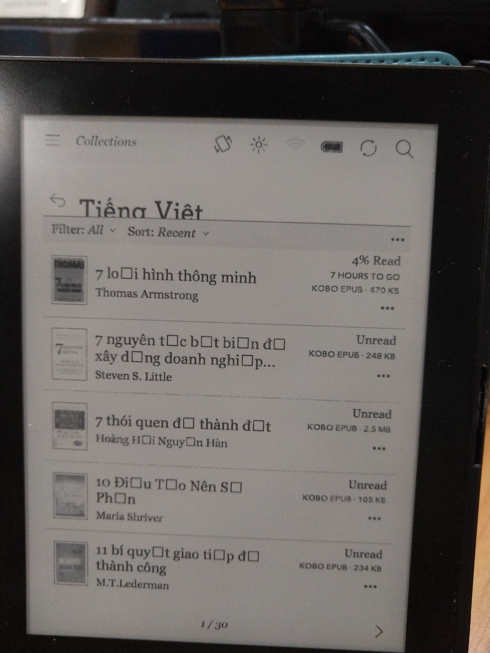

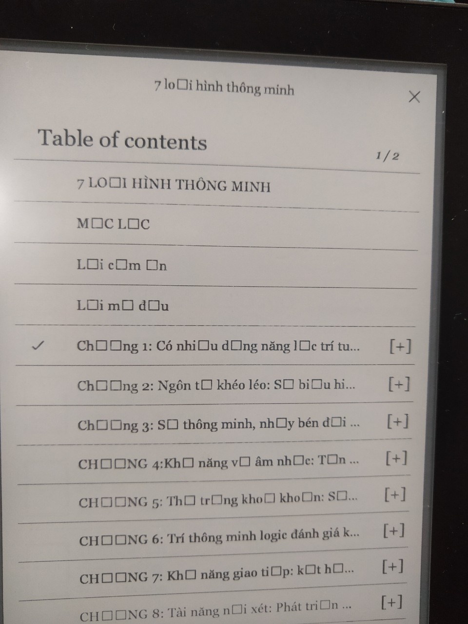

I didn't have any problem with book titles and table of content after patching for previous firmware but my kobo aura does not display the book title and TOC correctly after this patch. Has kobo firmware changed the system fonts? Anybody can help? My books language is Vietnamese. Thanks in advance!
ID:	174795   Click image for larger version
The Kobo built-in system fonts (Georgia and Avenir) have never been satisfactory in the GUI for Vietnamese users. I'm not aware that anything has changed in this regard in firmware 4.18.13737. So I'm not sure what you've been doing in the past to improve the look of Vietnamese authors/titles/TOC entries in the GUI.
There are some things you can do to improve matters. Read this recent thread for more information - particularly the summary of findings in post #63.

Hi Jackie_w,
You've saved my Kobo Aura. The "Custom GUI system fonts" did the job. I prefer Code2000; however, it does not support Vietnamese. So I use "Noto Serif SC" and "Noto Sans SC" which support Vietnamese, Chinese (both Traditional and Simplied) as Chinese is my second language.
For previous firmware version, I just need to run "Custom collection/author header title font" patch then it will also take effect to Book lists and TOC. But not the current version. I don't know why.
There still some bugs like every time restarting the device I have open an Vietnamese book so that language can display correctly (same as previous version). And the preview of TOC (one line of TOC at the bottom when clicking in the middle of reading book) still cannnot display correctly which previous version does not have.
Thank you.
That's good
I'm a bit confused by this statement. This patch did need to be updated for firmware 4.18.13737 but, as far as I know, it only affects a very small part of the GUI. It shouldn't (now or ever) have affected the book lists and TOC entries.
Carefully compare the code you are using for your version of this patch with that in the copy of nickel.yaml in the standard download pack of kobopatch.
The word "bug" implies "avoidable, fixable error". It is currently neither avoidable nor fixable. After a full reboot the Kobo only has access to a very few built-in fonts. You have to force it to load all its sideloaded fonts. I discuss the simplest workarounds here in the previously linked thread.
You can use New patch - "Custom page navigation scrubber" detailed in post #3 of this thread to customise this font.
Whilst all of the above should improve things for you - in a rather piecemeal manner - there is a potentially "better" option you might like to consider.
It is discussed in the kobopatch users & non-Kobo-supported languages thread I linked earlier? Look for the posts discussing using a font editor (e.g. FontForge, TTFEdit, Type Light) to help you internally rename your 2 chosen Noto fonts to Georgia/'Avenir Next' before sideloading them.
This will give your Kobo GUI a complete overhaul and you won't need to repeatedly customise font-family in multiple patches. You will still have the same problem after a power-off/reboot but this option will survive a firmware update without needing to be re-applied.
