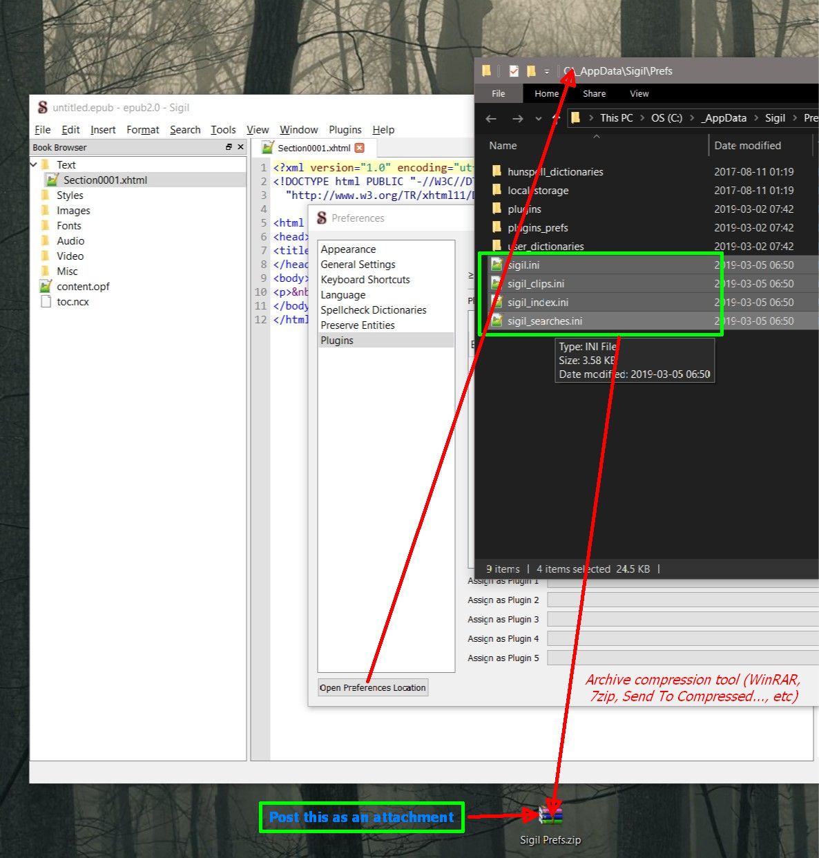

You can be of a lot more help. As soon as Sigil starts behaving badly in the manner described, please zip up your ini files in the preferences folder and post them so we can look at them. No one has yet complied with our request to post their ini files when a clean install of Sigil 0.9.12 starts badly misbehaving.
In case someone needs it:
Attachment 170007
Thanks!
