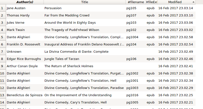

I think in the log you analysed, I imported the books twice, to show, that the books without a #filename in the first import and in the second import are different
This is an example without duplicate filenames and importing the files only once.
debuglog.txt
Sorted by Modified time:

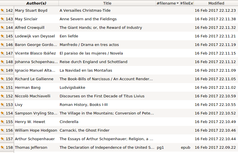

Name:	Screenshot from 2017-02-16 23-12-11.png
Sorted by #filename (157/805 files does not have #filename)
Name:	Screenshot from 2017-02-16 23-04-42.png
