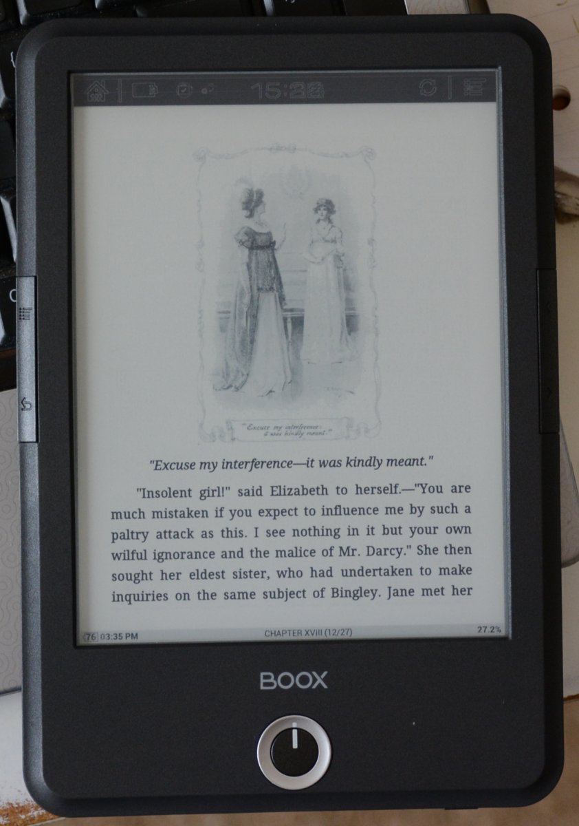

OK, I've bought Moon+ and it works extremely well. Setting a theme with a white background, a black font, and bold text, gives an extremely readable display - as good as the Kindle Paperwhite, to my mind. The page turn buttons work "out of the box", and so does TTS. An excellent reader, and one that makes this device a definite "Keeper" for me.
The controls are completely configurable, and the D-pad is fully supported for whatever you want it to do.
See attached picture.

Looks good. I wonder if the apps Immersive Full Screen mode would work to hide the top menu bar.
HarryT: Darnation!
Isn't there SOMETHING that doesn't work as it should? Must... resist.... Anything? How's the page counting: can Moon+ open AZW3 files and count pages like the Kindle does, or is there some other option to customize it for EPUB's? I see 12/27 in the picture; do you know by any chance how this app counts?
What's with the bold text; are the normal fonts not bold enough? What happens to text that should be bold by default; is it even bolder?
Can the top bar be hidden? The small footer is enough already.
Have you also tried Mantano?
Are you tired of these questions yet?
Thanks in advance
If a cover appears that I like, there is a chance I'll try this reader. I'll root it, clean it up, install a 'big' reading app, and it'll be the most customizable e-reader ever created; fit for years to come, as long as it doesn't break.
No, only the Kindle app can read AZW3's
It counts the number of "pages" (screens) in a chapter.
Moon+ has about a million customisation options - I've only scratched the surface of what it can do so far. It doesn't support AZW3 - I'm using it with ePub.
The normal fonts are not terribly black - I find it looks better with bold fonts. Bold text is very rare in eBooks - that doesn't bother me.
I don't believe so, but I may be wrong. That's nothing to do with the app - it's put there by the "system".

This is looking good. Maybe Onyx should include an option to hide the top bar as soon as a program starts. TBH, it's the one thing I can really mark down as "wrong", at this point in time.
