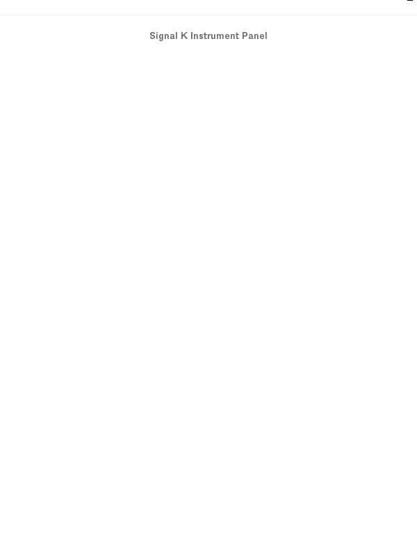

with the Experimental Browser I can reach 10.10.10.1:3000/@signalk/instrumentpanel
but I have this ......
.......instead of this:

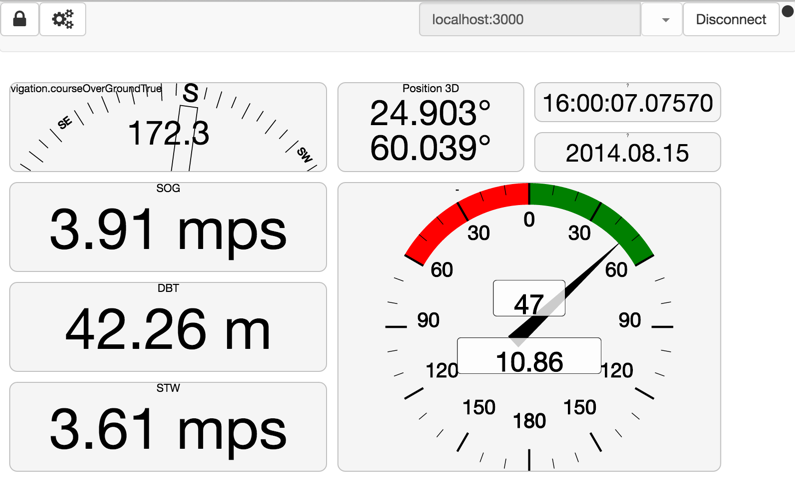

this is the link of gitHub signalk page https://github.com/signalk/instrumentpanel

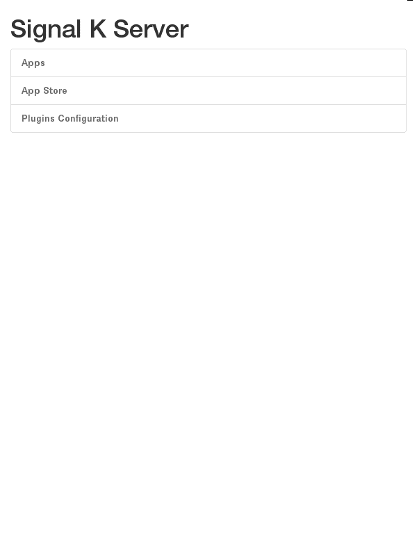

NEWS:
after "bridgeing" with "Update_jailbreak_bridge_*_install.bin"
and ugrading with "Update_kindle_5.3.2.1.bin"
WebLaunch stop crashing!!
very very cool WebLaunch!!!!
Very very cool the bridge!!!
ID:	160127   Click image for larger version
