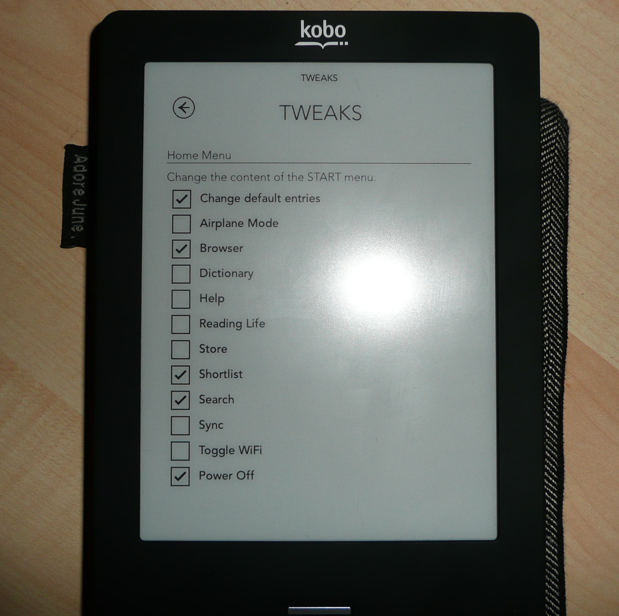

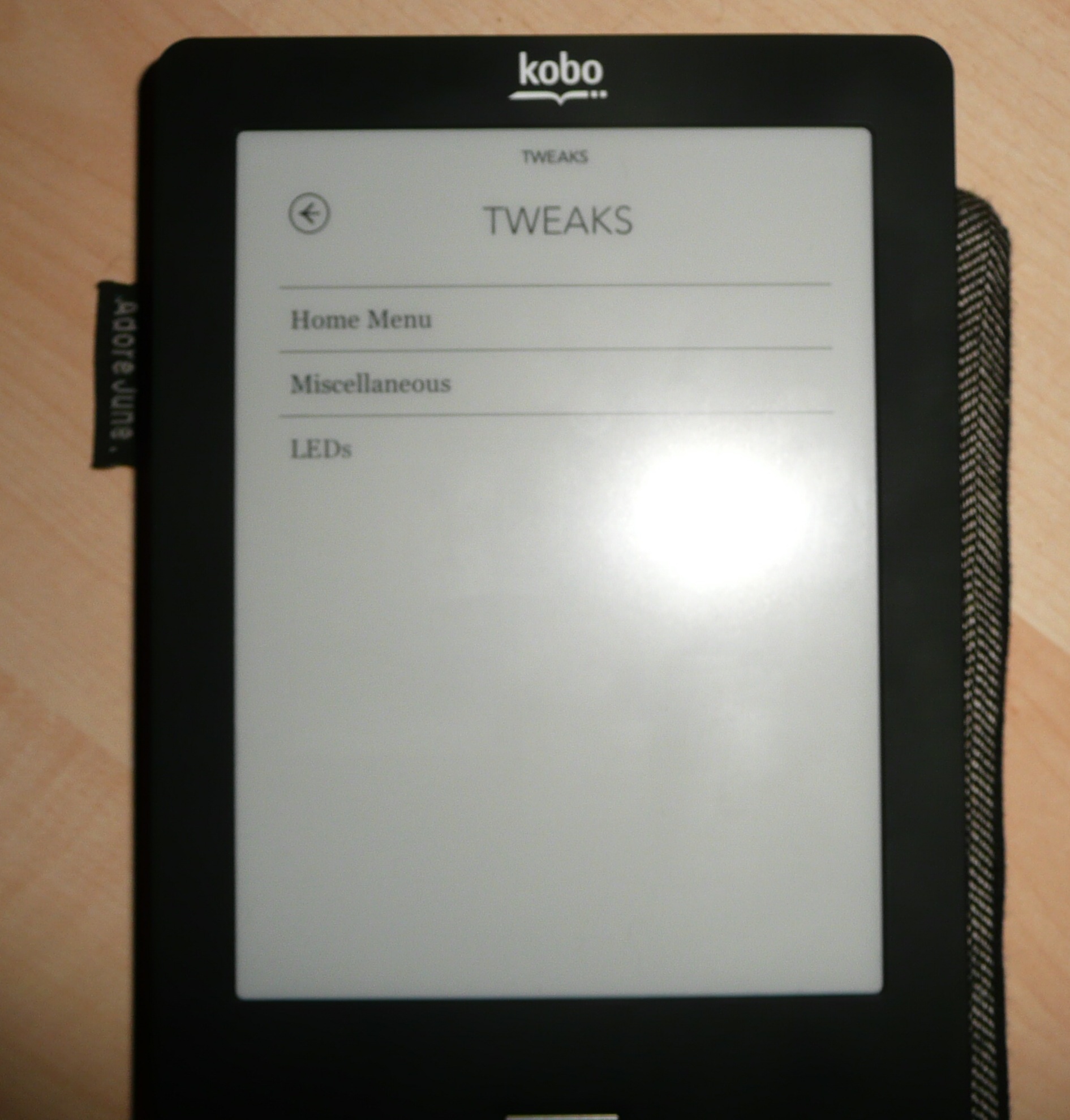

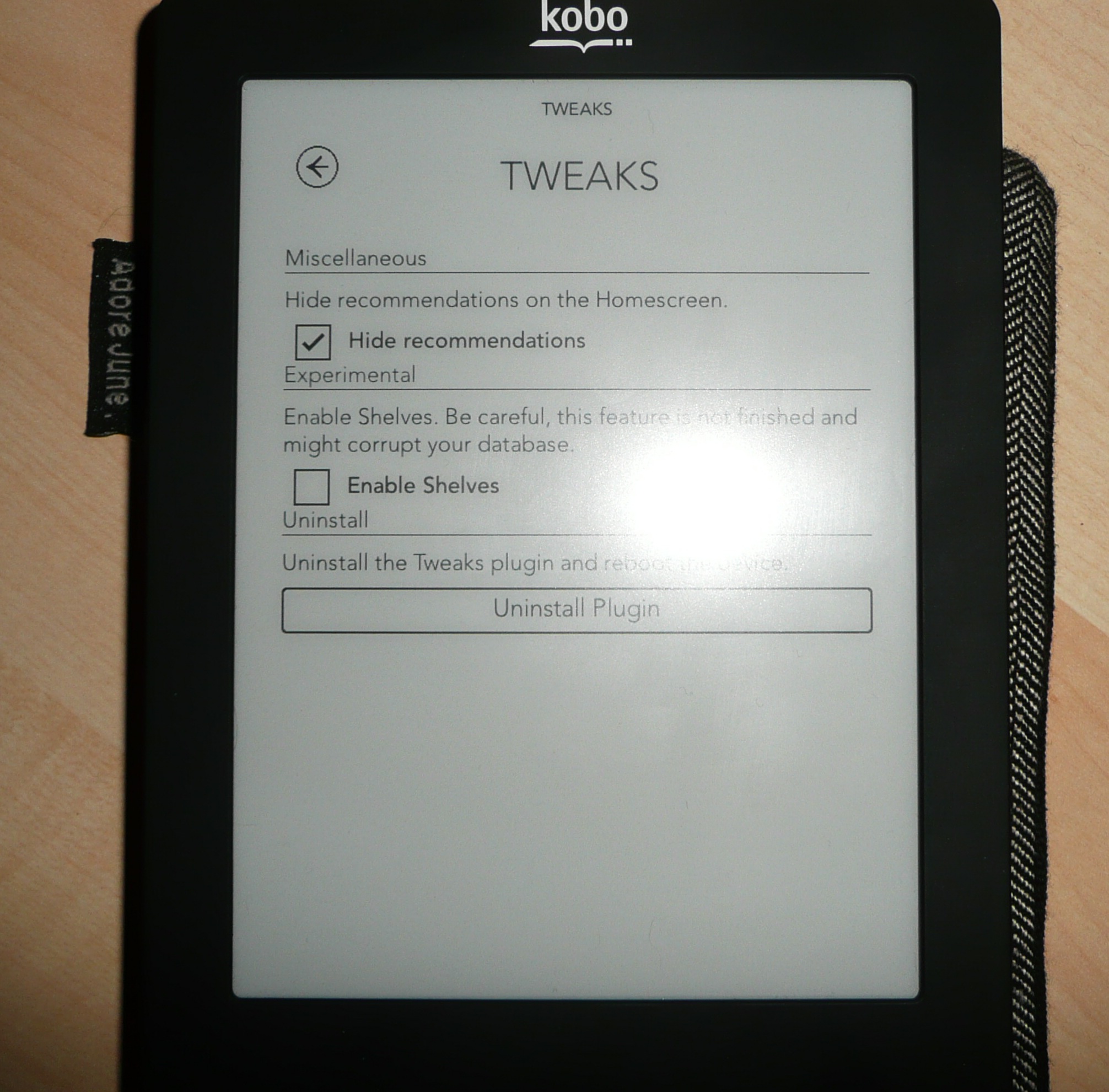

Since I was looking at it anyways, I finished some stuff and I'm happy to announce a new version!
The biggest change is that now there's a much better GUI for controlling all the options, so manually editing any config files should be unnecessary. It's mostly using the same widgets as nickel so everything should look and behave similar to the native settings dialogue.
Installation is the same as always, download Kobo.tgz.zip, extract the zip, copy Kobo.tgz to the .kobo Folder on the device and eject the reader.
Thank you . Looks very nice. Well, I have some questions:
  • What's the difference between Airplane, Toggle WiFi and WiFi on/off?
  • What exactly happens while/after uninstalling the plugin?
And here comes my wishlist :
  • Please establish plugin versioning.
  • Add at least one blank line resp. a little space under every checkbox on the "Miscellaneous" page. At the moment, the design of this page is a little confusing.
  • Add language support. This could be realized by an INI file with entries like "Library=Bücherei" and so on, for each string. So the user may edit this file manually to suit the plugin for his own language.
  • Improve the consistency between entries in the home menu and tweaks page.
  • Create a complete INI file with all sections and entries (set to default). Currently one has to toggle each home menu option twice to create first a corresponding entry itself and then to set the desired entry value.
  • Place a note that the device will reboot to uninstall the plugin.
  • Remove the plugin INI file(s) while uninstalling.
Koboyashi is offline   Reply With Quote
Old 02-23-2012, 11:41 PM   #135
ah-
ah- knows the square root of minus one.ah- knows the square root of minus one.ah- knows the square root of minus one.ah- knows the square root of minus one.ah- knows the square root of minus one.ah- knows the square root of minus one.ah- knows the square root of minus one.ah- knows the square root of minus one.ah- knows the square root of minus one.ah- knows the square root of minus one.ah- knows the square root of minus one.
Posts: 64
Karma: 7786
Join Date: Jan 2012
Device: Kobo Touch
Toggle WiFi and WiFi on/off are the same thing, but I have to admit I'm not 100% what it does since I didn't implement this. From looking at the code I'd guess clicking on WiFi on/off connect immediately without having to open the browser.
Uninstalling deletes the plugin shared library (libtweaks.so) and reboots using busybox reboot.
There's a warning right above the uninstall button . But you're right, having a confirmation dialog would be a good thing. But that's quite a bit of work since I'd have to write the missing headers for potentially a lot of stuff. Maybe in the future.
