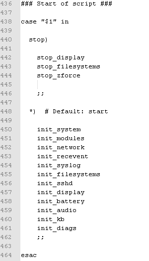

Far as I can make out: This is what is run by the N U Z x command
EDIT: All that stuff should be there, far as I can tell. files are there. configs. iptables is definitely set to allow all traffic on usb0.
sneaky folder killer removed. Can you think of anything else I might have missed or could do next?

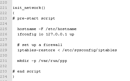

Is this machine using that iptables with the special line for icmp?
You know, the one I suggested should not be there.
**That** line would make icmp "work" when nothing else does.
Avoid the entire firewall dance for the moment . . .
Set the default policy of all three main chains to "ACCEPT" with no other rules.
Save that three statement config file wherever "diags" is picking up its iptable_save file.
After sshd (or telnetd or ftpd or ...) is working, then deal with setting up the firewall.

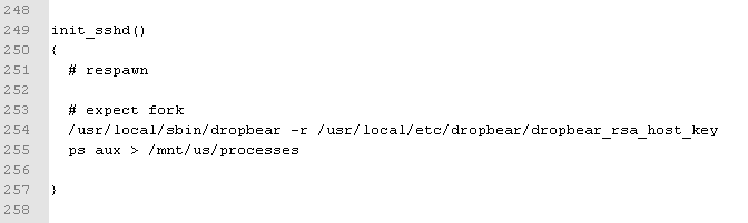

ps aux
Current state of play with DIAGS. Some progress. finally got it to spit out a ps aux to the /mnt/us.
no dropbear. hmm..

perhaps I'm not invoking it correctly, but I don't see how.
I'll add a sleep 5 and see what happens.

Is the file system you are putting the dropbear binary on mounted: "noexec" ?
Also note these:
root       463  0.4  0.2   2296   668 ?        Ss   11:23   0:00 /bin/sh /etc/init.d/rcS
root       475  0.0  0.0   2296   252 ?        S    11:23   0:00 /bin/sh /etc/init.d/rcS
root       476  0.3  0.2   2296   696 ?        S    11:23   0:00 /bin/sh /etc/rcS.d/S50diags start
Which is:
1: Unusual
2: Probably indicates the kernel ran an "Early User Space" root before it got to where it is at now.
3: Indicates that 11 jobs ran to completion between pid 463 and pid 475
4: lookup code Ss, that is probably an rcS from the 'EUS' in the initramfs that did not get cleaned up, might be something else.
In init_sshd():
Ref:
http://linux.die.net/man/8/dropbear
Add -E and also redirect 2>to_some_/mnt/us/filename
Add -p 22 :: no address specified, will listen on all available interfaces
Add -g
Add -K 0 :: no time-out specified, disables keep-alives
And if really desperate - add an strace -fF with output to /mnt/us/somefilename

Note from another image (the network pre-start script): /var/run/ppp is where the pid of the 3G ppp0 process will be kept.

init_sshd() Round 12
okay so reading the code...
filesystem is not noexec
# First take care of var/local
if ! mount -t ext3 -o rw $local /var/local; then
f_log I filesystems createvarlocal "Creating /var/local filesystem"
mkfs.ext3 -F -L LocalVars $local
tune2fs -c 0 -i 0 $local # disable fsck
rm -rf /var/local/*
cp -arf /opt/var/local/. /var/local/.
fi
mkdir -p /var/local/system
Also the section of code that appears to do "something" with dropbear (not sure what is supposed to invoke it- possibly it's a startup call?) by my reading of it should attempt to at the very least create a new key in /etc/dropbear/blah , even after I nerfed the /usr/local/* cleanup.
ASSUMPTION: Key is overwritten if the key already exists, this may be wrong.
&& %s -t rsa -f %s
has to be dropbearkey -t rsa -f /etc/dropbear/dropbear_rsa_host_key
Thus if that was triggered one might assume that my copy in usr/local/dropbear/key would be different to the one in /etc/dropbear/key
[root@kindle mmc]# diff -s usr/local/etc/dropbear/dropbear_rsa_host_key etc/dropbear/dropbear_rsa_host_key
Files usr/local/etc/dropbear/dropbear_rsa_host_key and etc/dropbear/dropbear_rsa_host_key are identical
They are the same however. And thus the key I expect. So it's not a wonky key.
ASSUMPTION: was probably wrong. as opposed to anything else as rm -rf /usr/local/* operates as expected when in place...
I'll give this config a go and see what falls out then go for a strace (don't want to hang DIAGS too bad. might get stuck)
init_sshd()
# respawn
# expect fork
/usr/local/sbin/dropbear -a -p 22 -g -K 0 -r /usr/local/etc/dropbear/dropbear_rsa_host_key -E 2> /mnt/us/droplog
sleep 5
ps aux > /mnt/us/processes
/usr/local/sbin/dropbear -P /var/run/sshd -p 22 -r /etc/dropbear/dropbear_rsa_host_key -E 2> /mnt/us/droplog2
sleep 5
ps aux > /mnt/us/processes2
