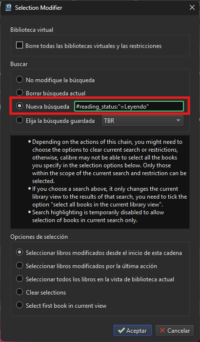

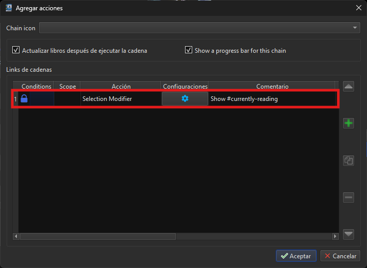

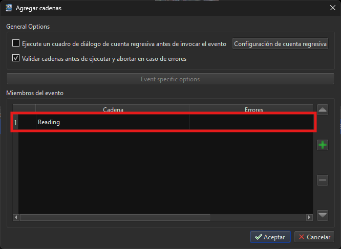

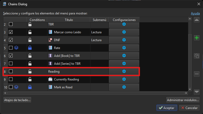

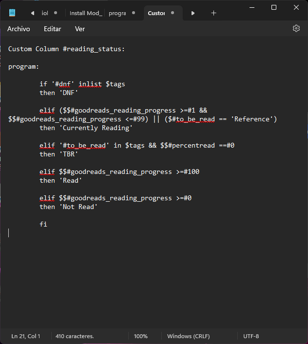

Old 05-12-2024, 02:47 AM   #1332
correoparaappzz
correoparaappzz began at the beginning.
Posts: 72
Join Date: Nov 2023
Device: Kindle Oasis
Hi, i don't know what i'm doing.
i use "Event Manager" to show me the books i'm currently reading every time i change library, all good
But now I want it to show me my TBR in case I don't have books in Currently Reading, and i don't know how
correoparaappzz is offline   Reply With Quote
Old 05-12-2024, 05:48 AM   #1333
capink
capink ought to be getting tired of karma fortunes by now.capink ought to be getting tired of karma fortunes by now.capink ought to be getting tired of karma fortunes by now.capink ought to be getting tired of karma fortunes by now.capink ought to be getting tired of karma fortunes by now.capink ought to be getting tired of karma fortunes by now.capink ought to be getting tired of karma fortunes by now.capink ought to be getting tired of karma fortunes by now.capink ought to be getting tired of karma fortunes by now.capink ought to be getting tired of karma fortunes by now.capink ought to be getting tired of karma fortunes by now.
Posts: 1,223
Karma: 1995558
Join Date: Aug 2015
To be able to offer specific help, I need more details regarding how you keep track of currently reading and TBR. I need the custom column names and the datatype of these custom columns.

There are two solutions:
  1. Create a New chain
    Create a new chain with a single action: "Search Using Templates", using the following Templates:
    program:
        if from_search('id', '#reading_status:"=Currently Reading"') then
        else
            '#reading_status:"=TBR"'
        fi
    Note: Make sure the option "Template output is a calibre search" is chosen.
  2. Modify your existing chain
    Modify you chain as follows:
    • Make sure in the first "Selection Modifier" action the option "Select first book in current view" is selected.
    • Add a second "Selection Modifier" action with this search:
      Note, however, that you must put this condition on it (Right click > Add/Modify conditions):
      template = program: from_selection('id')
      datatype = text
      comparison = "!="
      condition value =
The first solution is the simpler solution. But since your #reading_status is a composite column, I think the second might perform better. Experiment with the two and see what fits you better.
Edit: The two template functions from_search() and from_selection() are only available in Action Chains plugin. @chaley has since introduced a template function called book_values() that can replace from_search().
capink is offline   Reply With Quote
