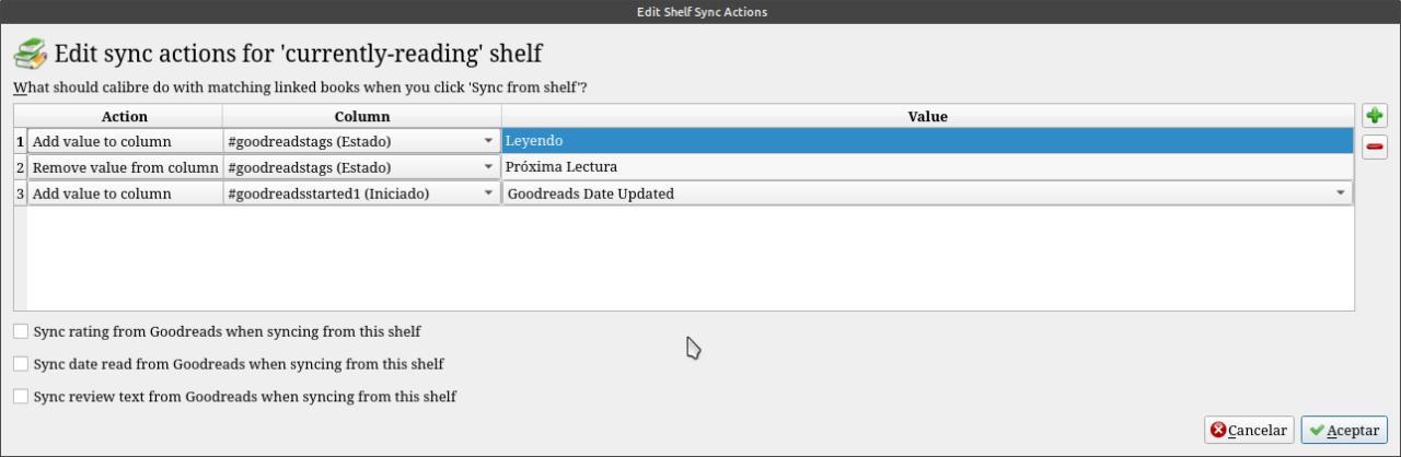

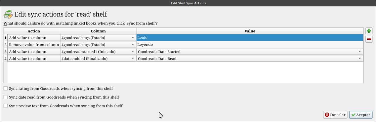

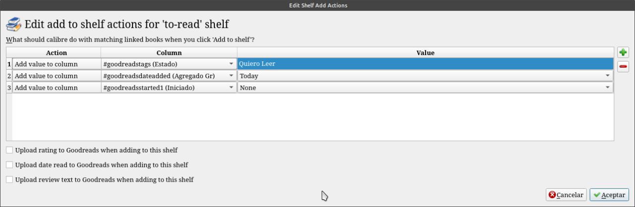

Old 12-06-2019, 10:38 PM   #1290
dunhill
dunhill's Avatar
Posts: 971
Karma: 1044682
Join Date: Sep 2017
Originally Posted by Squarty View Post
please can you guide me step by step to configure this plugin in Calibre ?
It is a bit long to do a step by step.
First you have to create custom columns. Once the creation of the customized columns is finished, we accept and Calibre will be restarted, so that these changes take effect, the columns will appear in the last positions, we must possess them, pressing the mouse over the column and move it to their places of choice .
Now we install the Goodreads sync plugin. Once the plugin is installed, Calibre restarts and the Goodreads sync icon will appear in the toolbar.
We click on the icon and touch customize complement.
in that field we put the email address with which we enter Goodreads a screen opens where we have to authorize the plugin with Goodreads, just by touching the button that says Authorize our Goodreads section opens in the browser.
And our Goodreads shelves are automatically added to the plugin.
I leave here below what they have to put on each shelf all by clicking the settings for the shelves of
To read
Actions to add to the shelf:
Actions to synchronize shelf:
Reading (currently reading)
Read (read)
