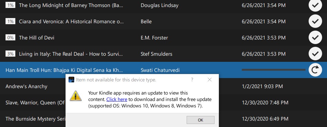

I successfully installed kindle-for-pc-1-17-44170 and blocked the automatic updates with the given batch file. After re-registering I downloaded a few books, but I got a system message that I need to update the Kindle for a particular book. I've paused further downloads for now.
Any guess why?
Any guess why?
Some books are only available in KFX format.
pdurrant is offline
That particular book appears to be in Hindi. That is one of the categories of books that are only available from Amazon in KFX format.

Noted. Thanks.
