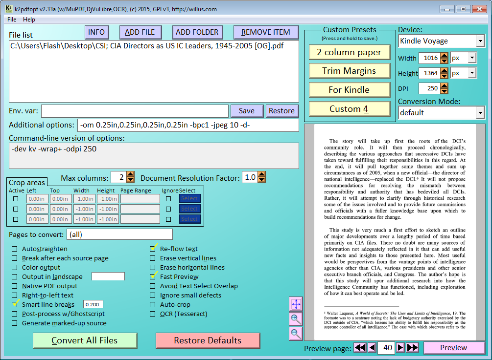

Originally Posted by fullspeedin2sun View Post
The options I'm using are in the attached screencap. I was hoping to make this PDF easier to read on my Kindle Paperwhite 3 without making it much bigger as it looks like it was natively created.
Also, is there an option to add margins in the GUI?
You really need to turn off native mode output and allow text wrapping to be able to magnify the text. Just try it out. I think you'll like the result (is file size really more important to you than readability?). To add quarter inch margins, put this in the "Additional Options" field:
-om 0.25
P.S. You can convert a few pages at a time (e.g. A chapter or two) to keep the converted files to reasonable sizes if that helps.
-om 0.25
Ultimately, I need an easier time reading this than I need to preserve space on the Kindle, so I will do this. Thank you for your help, this program is a fantastically useful piece of software.
When you convert a PDF in smaller sets, do they add up to a total smaller size? As in, I could convert them in smaller packets and combine them at the end?
[...] When you convert a PDF in smaller sets, do they add up to a total smaller size? As in, I could convert them in smaller packets and combine them at the end?
No such luck. The total size will still end up the same. See this page for tips on how to reduce file size for bitmapped output.

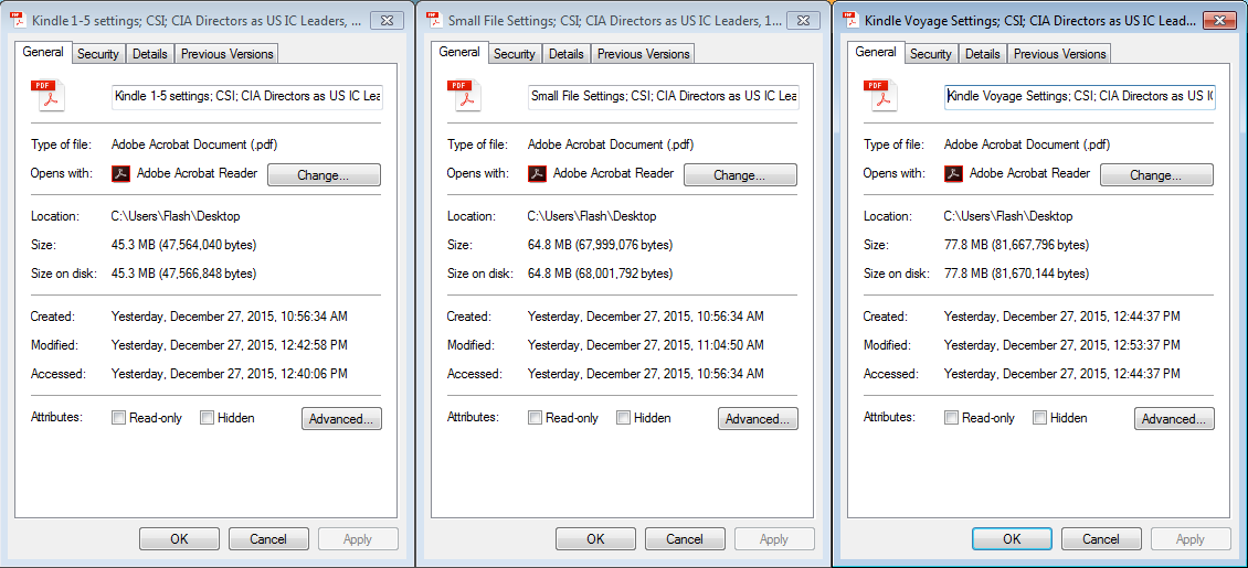

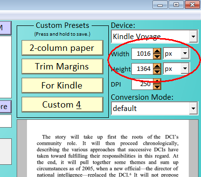

I had some cool but curious results when I played with those options. When I used the default settings for Kindle 1-5 this same file was 45mb, when I used the default settings for a Kindle Voyage/Paperwhite 3 the file is 78mb, and when I modified the settings to alter the bpc, the jpg quality, and the dithering [as well changing the dpi a little, screencap of settings attached], the file was 65mb.
Why is there such a difference in sizes between the Kindle 1-5 and the Voyage? Shouldn't the file size be smaller when I change the settings, maybe even a quarter of the size like the page on bpc and jpg quality management said?
Name:	k2pdfopt results.png
ID:	144973   Click image for larger version
Name:	Small File Settings.png
The Kindle Voyage has more pixels (300 dpi) than the Kindle 1-5 (167 dpi), so each bitmapped page saved by k2pdfopt for the Voyage has a much higher pixel count.
Makes sense. So I'm using the optimization options correctly and I've hit the limit on how much I can shrink this pdf?
fullspeedin2sun is offline   Reply With Quote
A couple things:
1. Your use of the -bpc option needs a space between "-bpc" and the value, e.g. "-bpc 1" instead of "-bpc1".
2. The -bpc option is not compatible with the -jpg option. If you use the -jpg option to save the bitmaps as JPEG, the -bpc option is ignored. So you need to pick one or the other. I need to make this more clear in the documentation.
A JPEG quality factor of 10 seems pretty low, but as long as you find it tolerable, then that's fine.
