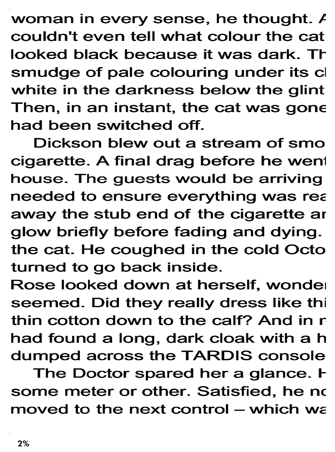

Hi. Crop function works wonder. However, I have some problem with re-flow text. I converted a PDF using re-flow (-dev kv -wrap+) and when I read it on Paperwhite 3, I got this. Wonder whether it's on my end or not.

That's difficult to diagnose without more information. When you view the PDF on a PC reader, is it also cropped like that? Are you using any other options? Does the conversion look right in the preview window (if you're using Windows)? Can you post (or PM me) the source and converted PDF files?

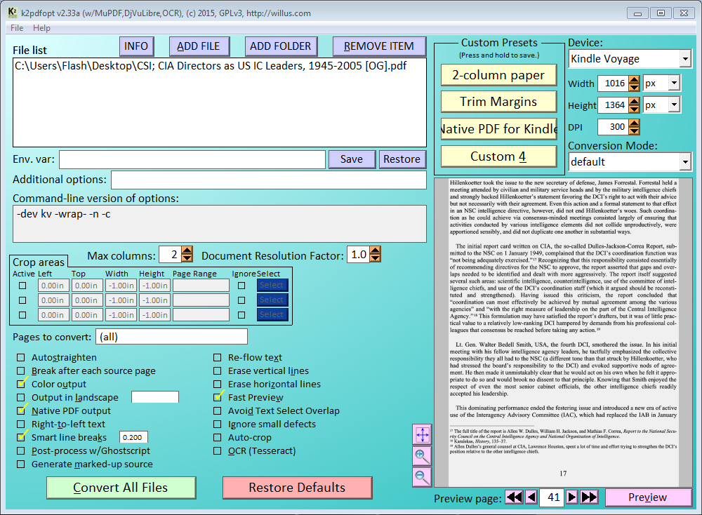

Yes, you should be able to magnify the text with k2pdfopt, but it depends on what settings you are using and how the document is laid out. If magnifying the text means you also have to re-flow it, then native mode won't work.
Can you post the source PDF or a couple of pages from it, or PM it to me? Also can you send a screen shot of the options you are using?

source PDF and screen shot of my k2pdfopt options
The options I'm using are in the attached screencap. I was hoping to make this PDF easier to read on my Kindle Paperwhite 3 without making it much bigger as it looks like it was natively created.
Also, is there an option to add margins in the GUI?
