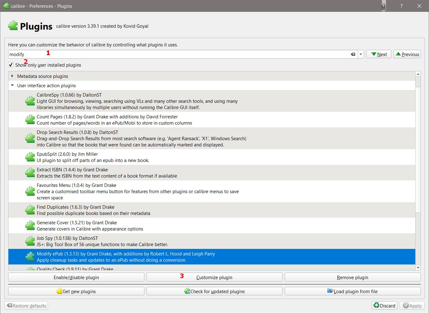

PS where is the option for - don't ask - just do it - it is not on the main pi choices screen ?
What is it with you guys, did you miss Reading 101
@ilovejedd - can you try unchecking "Prompt to save ePubs" in the PI configuration and do what you just did from a fresh start.
PI configurations are done from within Preferences->Plugins
Let's leave it alone now, I've asked the developer who added the notify suppression option to take a look at it, we have a repeatable test case, further posts will only obfuscate the issue.

How to find an installed plugin :
