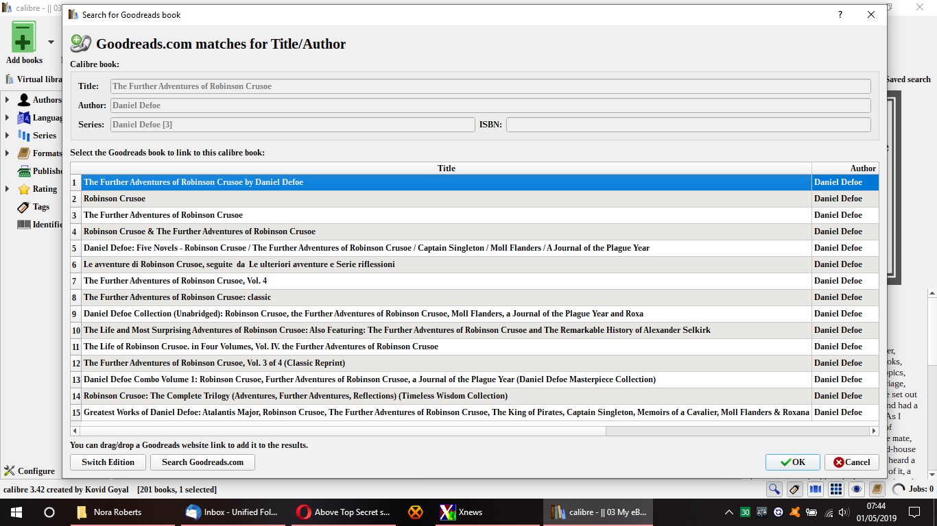

Is it possible to request the columns in the plugin can be fixed in width.
Often when I want to search for a book there is a large list and some titles extend beyond the screen and I have to scroll sideways to see the author name.
The screenshot attached shows an example.
Thanks.

A few of the dialogs don't set a default width for the title and all columns get resized to longest value visible. I'll add it to the TODO list. I might get a chance over the weekend.

Beta: tags, column widths, progress bars
I've been doing some work on the plugin today, and here is a beta. The changes are for the things mentioned recently. They include:
  • Adding dropdown for tag-like custom columns in sync and add action dialogs.
  • Fixing how the tags are applied during a shelf sync.
  • Set the a width for the title and author in the book linking dialogs. I think these are the only ones that the widths are not set properly.
  • Added progress bar to the sync from shelf. There are several steps and for at least one I don't know ahead of time how many there will be.
