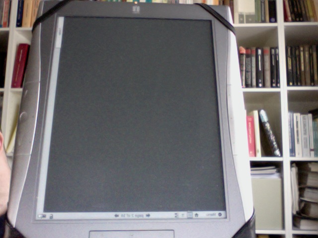

After extensive use, the remaining problem I have with the patch is the following: if the device is turned off or goes to sleep while on a pdf or another file, when it wakes up, it is impossible to access the home folder, the corresponding tap, even though it says folder, just reflects the last file. After closing all the files, the home folder is black and says page 2 of 16, the menu is accessible though and you can turn off and restart the device ... anyone else with such a problem ?
(the workaround I use is to make sure that the device is on the home folder before I shut it down)
fekhner is offline   Reply With Quote

I need some more info. I assume you are using the option: 'All documents Active on Shutdown', right? How many documents are re-opened after startup? Are they 'big'-files, interms of, need a lot of time to render?
It seems familiar, though. When you say that you see page 2 of 16. Do you also see one icon, and when going to another page, again one other icon from the home-screen is shown? I have seen something like that during development of the hack.
I normally use 'Document Active on Shutdown' and then I do not see the problem you describe. So that could be a workaround.
Right!
one 360 KB pdf file and xjournal open --> no problem! (pdf file and home folder re-open correctly, xjournal does not open)
one 360 KB pdf file, one 3.9 MB pdf file, one 20 MB djvu file (closing on that one, does not take a lot of time to render) --> problem appears =
home folder tab and home icon from menu at the bottom just reflect the djvu document, or after closing that, one of the other pdf documents, all documents are readable
after closing all documents home folder is on page 2 of 16 with the inner window completely black, so you cannot see what happens when you go to page 3,4 of 16, page 1 is inaccessible
Regards,
Marcel.
same configuration with large file djvu as above, option changed to 'Document Active on Shutdown' --> no problem !!
as always, thanks a lot for your help, will use this workaround from now on,
best wishes, G
