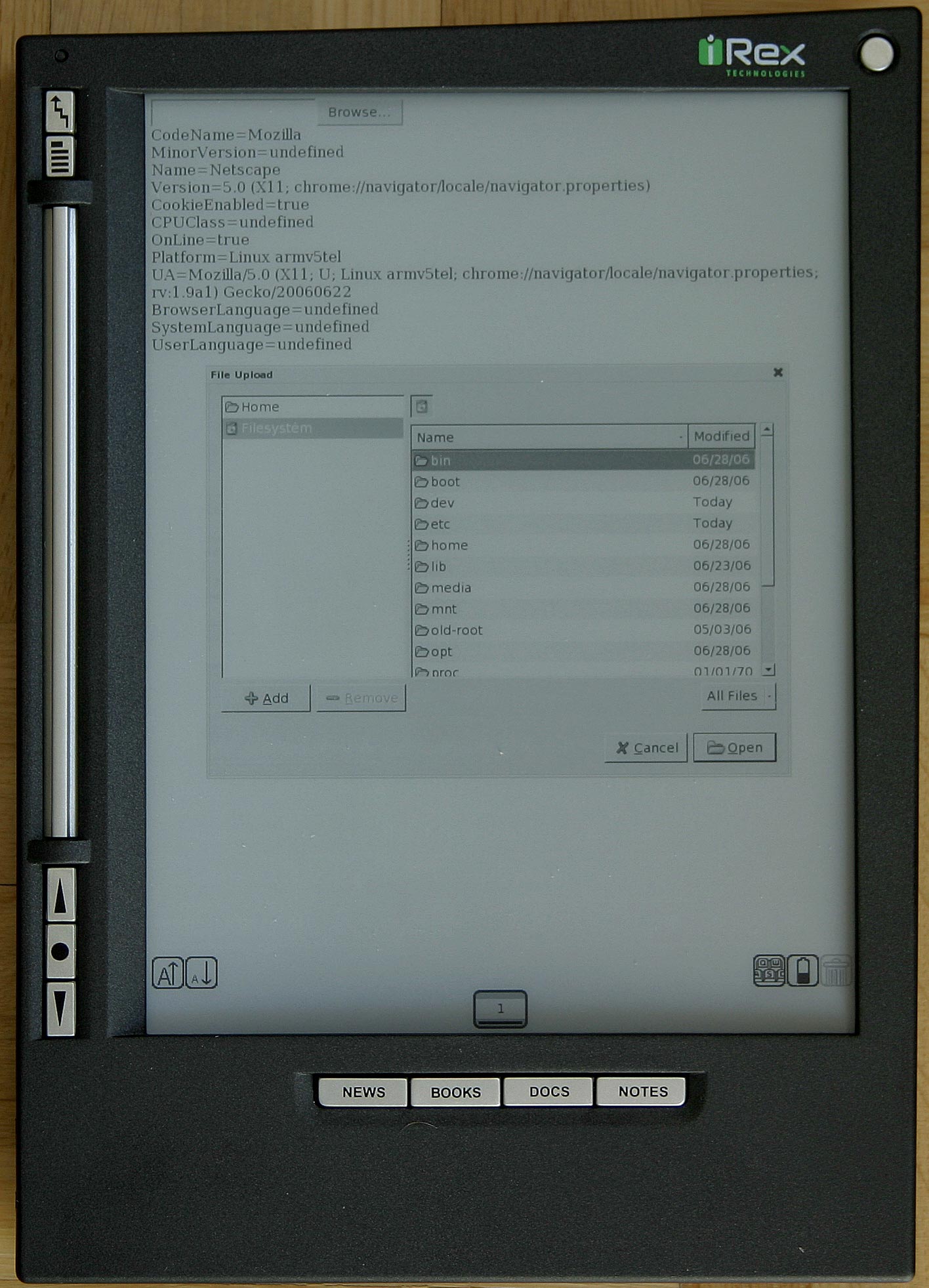

The browser seems to support all kinds of javascript. And i even could tak a look at the filestructure that way. I added an image, so you can see for yourself.

Tribble, that is a window on your sreen. It looks pretty much like one of the common window manager is running on the machine (there are even key shortcuts specified). I think that this is great news!

this is seriously cool, indeed.
Is the whole file system accessible when connecting via USB or only the books folder?
If it isn't, could you please try to invoke a "save file to" dialogue?
After that, maybe you can test in which folders you can write. If you can save files to every folder, we have the jackpot
We just drop a line in init.d and get a shell on a port.

So from the user agent, it looks like a Mozilla Browser (there was never a Netscape 5, if i can trust http://www.joergkrusesweb.de/interne...ser-agent.html).
And the file dialog looks like the one in GNOME.
edit: compare this to the iliad browsers user agent:
Mozilla/5.0 (Windows; U; Windows NT 5.0; de-AT; rv:1.7) Gecko/20040608
this is from Mozilla 1.7 on Windows 2000. Very similar, isn't it?
another edit: looks like you are alpha-testing Firefox 1.6.
http://www.tnl.net/ua/OS/Windows/Firefox/1.6
the last edit (hopefully):
i was totally mistaken. Seems like they are really running a version of Firefox 2.0 there. Just downloaded the last beta, here's the user-agent of it:
Mozilla/5.0 (X11; U; Linux i686; de; rv:1.8.1b1) Gecko/20060710 Firefox/2.0b1

Seems like it Windows are moveable. just have to do a manual screen refresh.

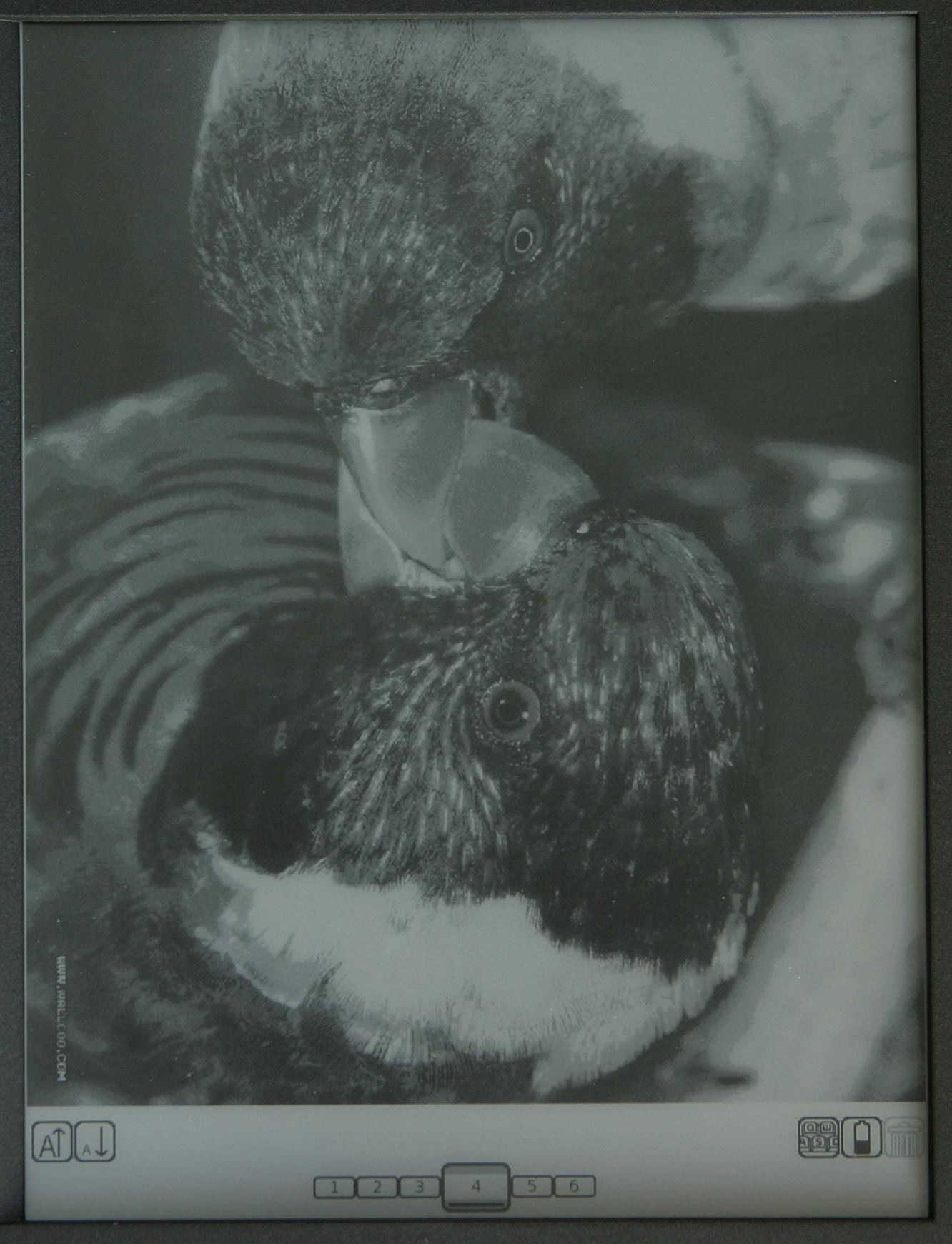

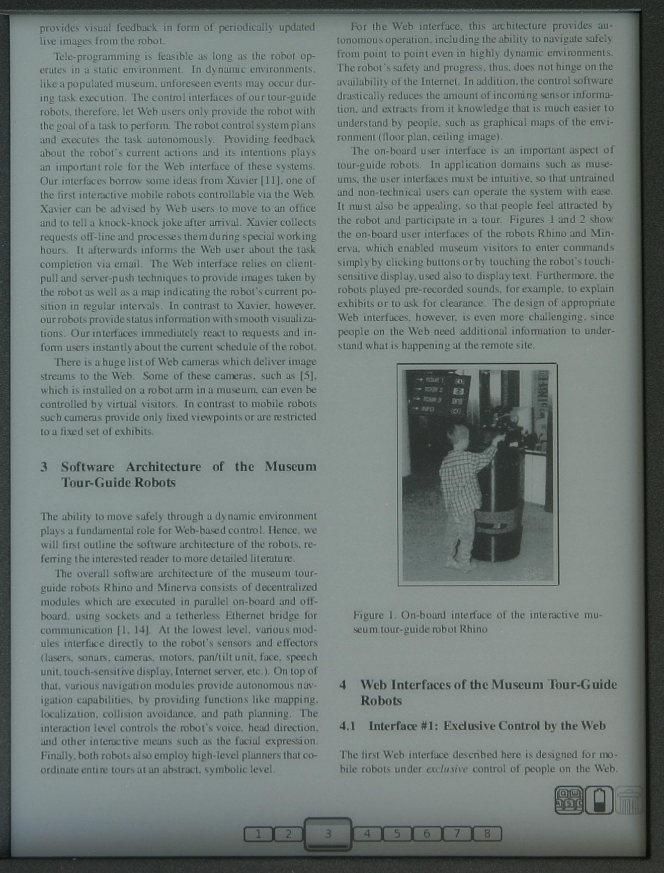

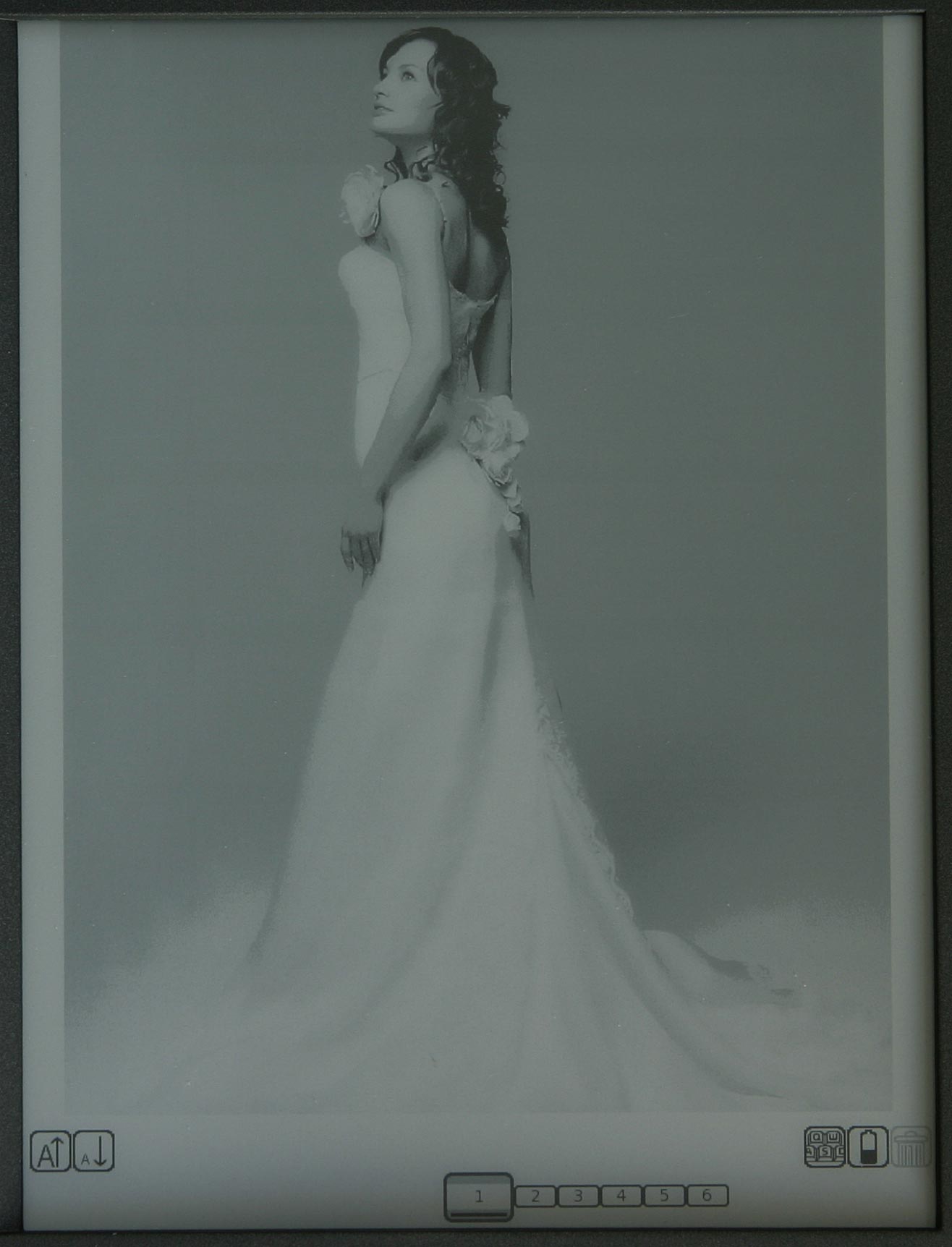

And here a few images of the sample pictures, a novel page i printed to a 12x15cm pdf page from firefox, and a cropped scientific paper i had around.
The paper is quite readable, but i like small fonts anyway, so it will not be for everyone. And for the figures a variable zoom option is necessary (drag top left to bottom right of zoom area - that would be nice).

The filesystem is not accessible via usb. At least not by just plugging it in as described in the manual. And you cant see files in the /etc folder, when you change into it. So the browser might not run as root
How could i invoke a "save to file" dialogue? CTRL-S and ALT-F dont seem to do anything. Any ideas?

well, you could put a hyperlink to a file in the same directory in the html. If it isn't a file which is supported by Firefox, it will/should/could display a "File save to" dialogue.
You tried the shortcuts with an USB keyboard?

Trying to klick on a linked file (zip and jar) produces an error message:
Downloading /tmp/somerandomname.exe
/tmp/somerandomname.exe could not be saved, because the source file could not be read.
Guess it wont be that easy.
