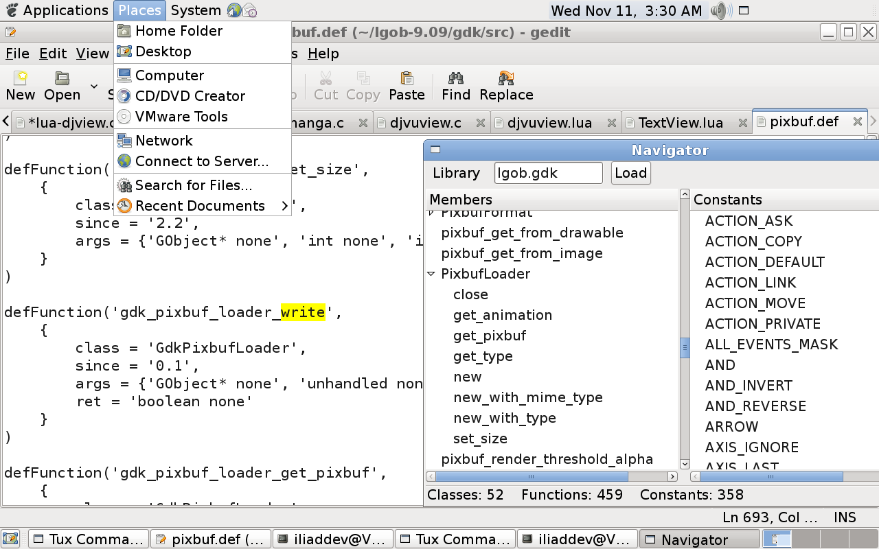

gdk_pixbuf_loader_write() not available in lgob?
It's quite strange. I can't call gdk_pixbuf_loader_write using the form:
local gpldr = gdk.PixbufLoader.new()
local success = gdk.PixbufLoader.write(gpldr, file_buf, ret, nil)
or
local success = gpldr:write(file_buf, ret, nil)
So I checked with Navigator.lua and pixbuf.def and found it strange (as the attached image). In pixbuf.def, there is an entry for gdk_pixbuf_loader_write(), but not listed on Navigator.lua.

Post
When building lgob, the log file (./lgob-9.09/gdk/log) shows that gdk_pixbuf_loader_write() is not handled (no code is generated)
This is (probably) because of the second parameter
defFunction('gdk_pixbuf_loader_write',
                class = 'GdkPixbufLoader',
                since = '0.1',
                args = {'GObject* none', 'unhandled none', 'gsize none', 'GError** full'},
                ret = 'boolean none'
This is (probably) caused by the fact that lgob's code generator does not understand the corresponding type (yet)
gboolean  gdk_pixbuf_loader_write  (
  GdkPixbufLoader *loader,
  const guchar *buf,
  gsize count,
  GError **error);
I'll check this with Lgob's author...
Edit: I just got a replay form Lucas: The analyse was correct, it will be fixed soon in a Lgob update. Il update the Iliad package after that...
