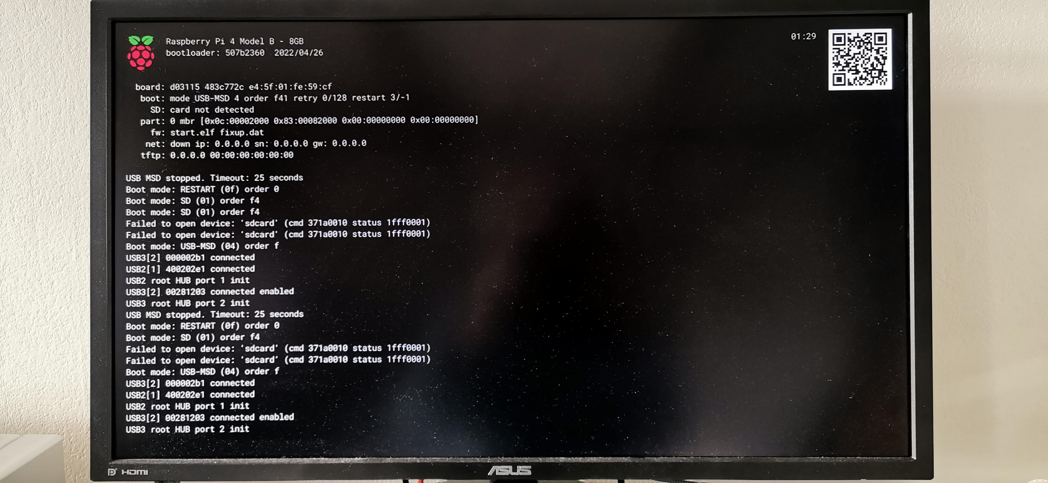

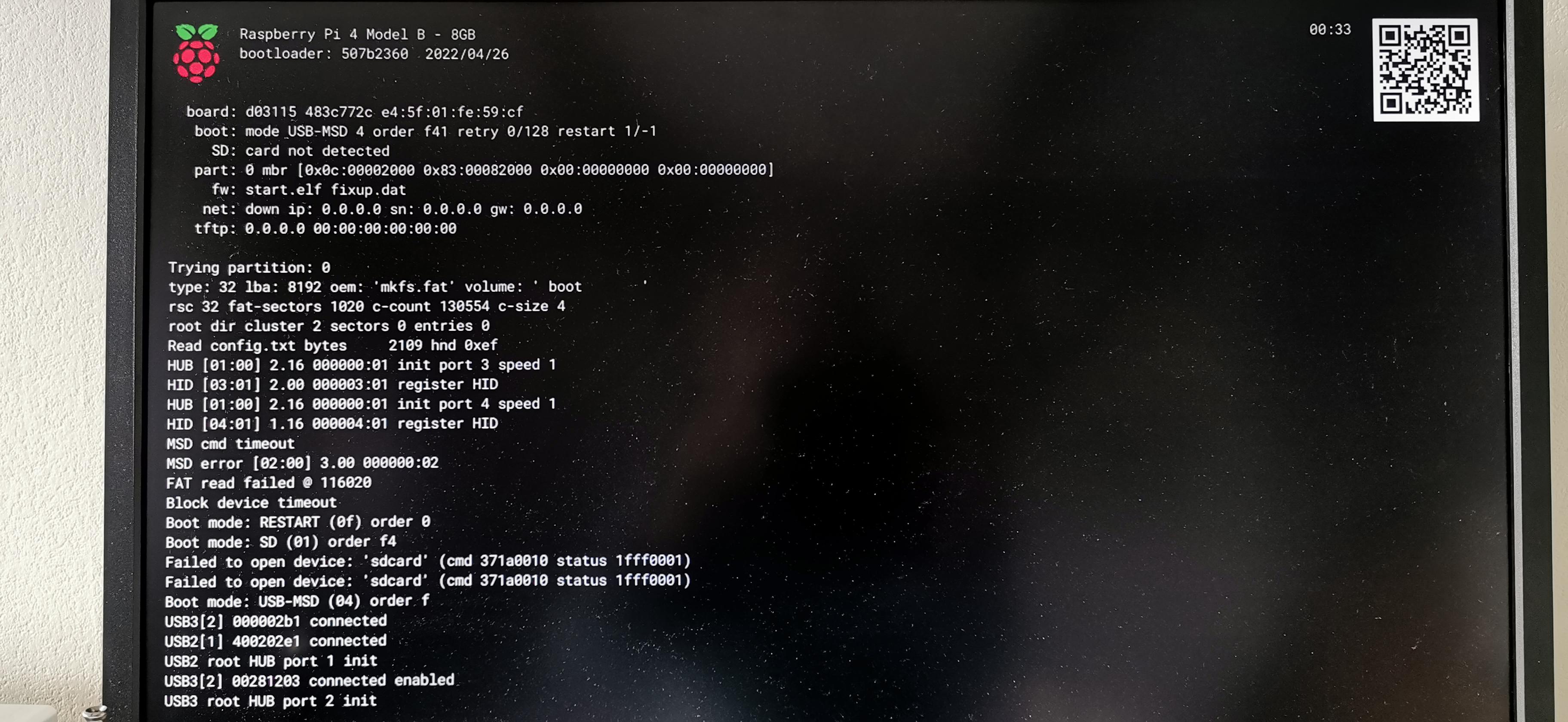

@mariosipad
well, after one day and some hours.....

@huber
There seems to be something wrong with either the USB port or the USB stick……. not good.
Power off, remove USB stick, insert SD card that worked, power on, does it start up?
Insert USB stick, is it recognised?
mariosipad is offline   Reply With Quote

@mariosipad
thank you very much for still corresponding
SD Card is recognized, additional USB stick at none of the remaining USB ports

Power off, remove SD
Power on, what happens?

Done, just with SD card, no USB stick - starts normal

oh, sorry: power off, removed sd card, started power shows pic attached

My error.
Power off
Insert USB, power on.

just with SD card works fine

Ok, but now with USB stick only……

No chance, same error codes as shown at the 3 pics above

@huber70
Then the installation on the USB stick is “kaput”.
Might be something minor or something major, dont’t know.
And do not know why. It might have something to do with the “low power” messages.
I would suggest to start over again (with the other USB stick or not, you call).
Then put on a smaller calibre database (takes less time to put on) and finally reboot without keyboard, mouse and monitor ( less power draw).
And see what happens.
