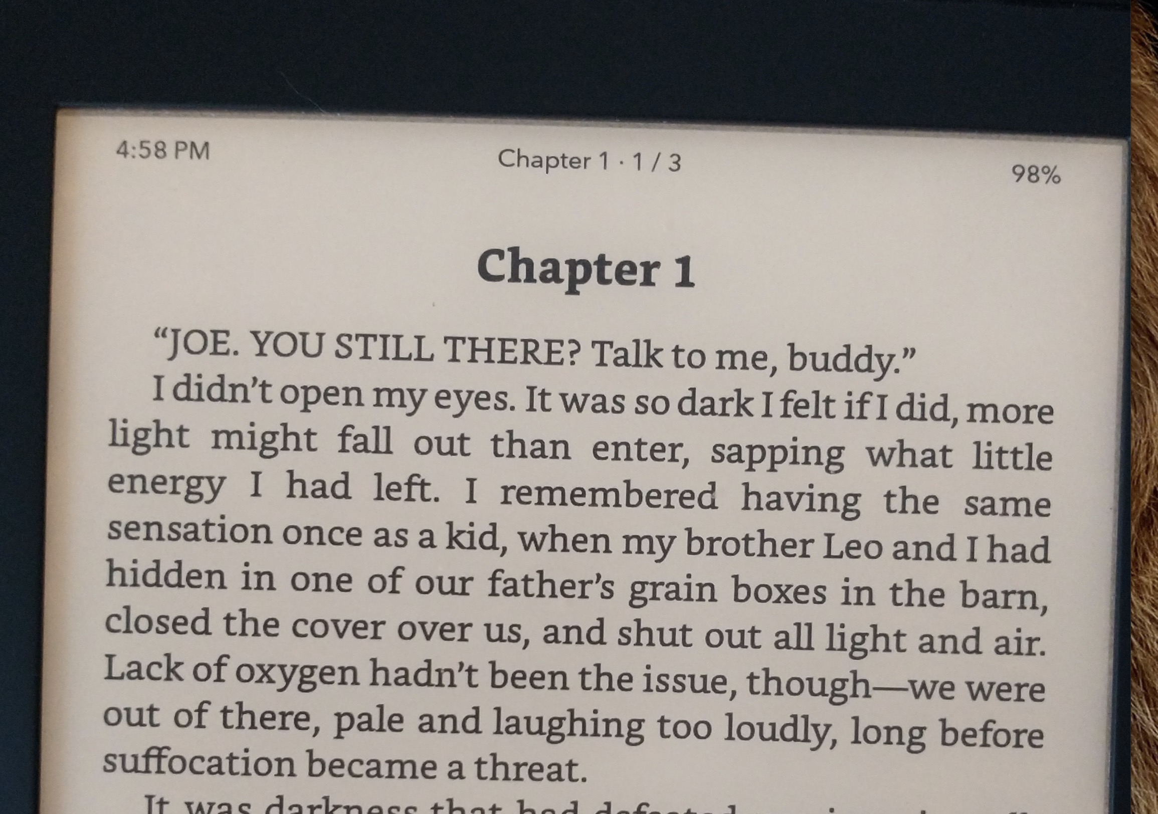

Just to confirm that my Aura H2O is now on 4.34.20097 with all my usual patches.
Nickel clock works perfectly - as shown in the following screenshot
(ps I switched the clock to left and battery to right while I was at it, so it's different from my last screenshot)
Thanks again @sherman and sorry to be a bother

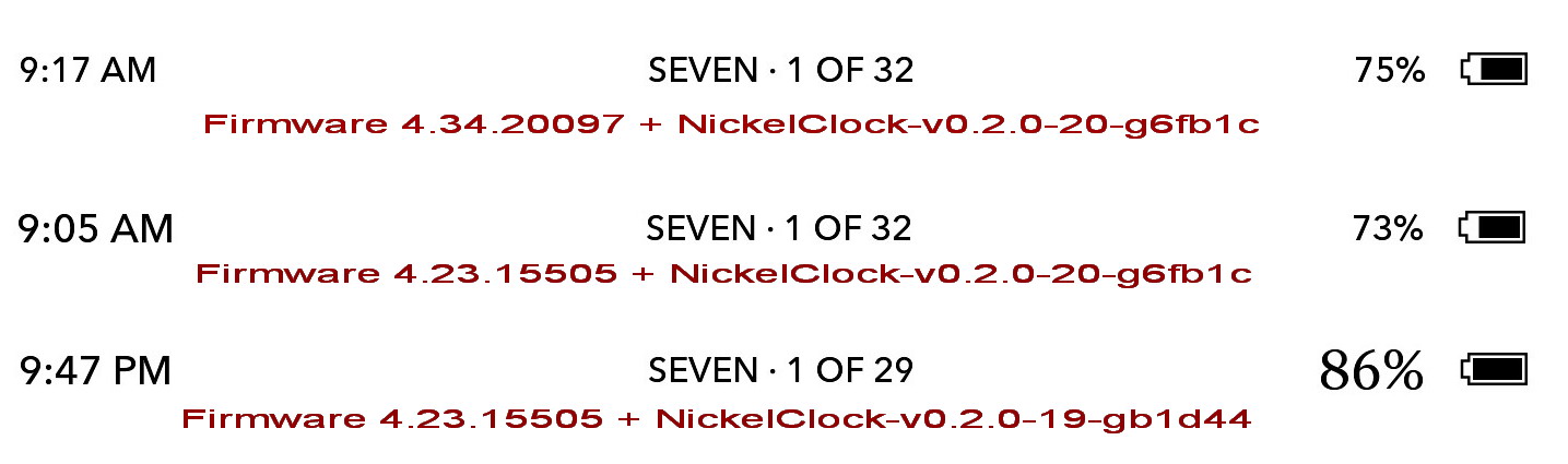

Thank you for spending the time to make nickel clock compatible with older firmware.
I tested the new version nickel clock with 4.23 firmware. The battery font size becomes normal. However, I notice in 4.23 firmware, the clock font size is slightly bigger than the clock in home pages (both old and new nickel clock version). This does not occur in new 4.34 firmware. However, I regard the new nickelclock is completely acceptable in old firmware.
I uploaded a comparsion picture as attchement for your reference.
All test are done without any patch on my Forma.
Thanks.
Allen

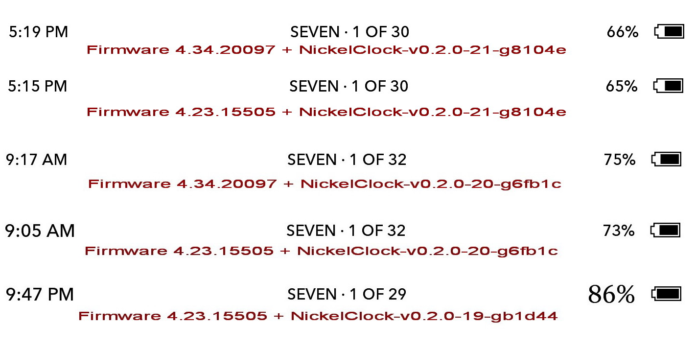

I've attached another test version. Hopefully it solves the time label issue as well (I had to implement the same fix as I did for the battery).
WARNING: Once again, entirely untested by me, but I don't foresee any issues.
Test version removed. v0.3.0 now released.

Sharman,
I believe you got it. The time and battery font size are the same for both new and old firmware.
Thanks.
Allen
