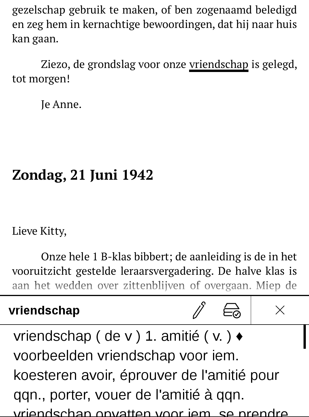

I've just looked at the xdxf-article. It is definitely not filtered.
<ar>
<head><k>leerling</k></head><def><p><span style="font-weight:bold;">leerling</span> <span style="font-style:italic;">(</span><span style="font-style:italic;">de</span><sup>m</sup><span style="font-style:italic;">)</span><span style="font-weight:bold;">, </span><span style="font-weight:bold;">leerlinge</span>*<span style="font-style:italic;">(</span><span style="font-style:italic;">de</span><sup>v</sup><span style="font-style:italic;">)</span><br/>1. <span style="font-style:italic;">scholier(e)</span><br/><span style="font-weight:bold;">élève</span><span style="font-style:italic;"> (</span><span style="font-style:italic;">m. of v.</span><span style="font-style:italic;">)</span><br/><span style="font-style:italic;">(</span><span style="font-style:italic;">lagere school</span><span style="font-style:italic;">)</span>*<span style="font-style:italic;">(</span><span style="font-style:italic;">man</span><span style="font-style:italic;">) </span><span style="font-weight:bold;">écolier</span><span style="font-style:italic;"> (</span><span style="font-style:italic;">m.</span><span style="font-style:italic;">)</span>, <span style="font-style:italic;">(</span><span style="font-style:italic;">vrouw</span><span style="font-style:italic;">) </span><span style="font-weight:bold;">écolière</span><span style="font-style:italic;"> (</span><span style="font-style:italic;">v.</span><span style="font-style:italic;">)</span><br/><span style="font-style:italic;">(</span><span style="font-style:italic;">middelbare school</span><span style="font-style:italic;">)</span>*<span style="font-style:italic;">(</span><span style="font-style:italic;">man</span><span style="font-style:italic;">) </span><span style="font-weight:bold;">collégien</span><span style="font-style:italic;"> (</span><span style="font-style:italic;">m.</span><span style="font-style:italic;">)</span>, <span style="font-style:italic;">(</span><span style="font-style:italic;">vrouw</span><span style="font-style:italic;">) </span><span style="font-weight:bold;">collégienne</span><span style="font-style:italic;"> (</span><span style="font-style:italic;">v.</span><span style="font-style:italic;">)</span><br/><span style="font-style:italic;">(</span><span style="font-style:italic;">man</span><span style="font-style:italic;">) </span>lycéen<span style="font-style:italic;"> (</span><span style="font-style:italic;">m.</span><span style="font-style:italic;">)</span>, <span style="font-style:italic;">(</span><span style="font-style:italic;">vrouw</span><span style="font-style:italic;">) </span>lycéenne<span style="font-style:italic;"> (</span><span style="font-style:italic;">v.</span><span style="font-style:italic;">)</span>*<br/>♦ voorbeelden<br/>een briljante leerling<br/><span style="color:#472565;">un brillant sujet, un sujet d'élite</span>*<br/>een externe, niet-inwonende leerling<br/><span style="color:#472565;">un(e) externe</span>*<br/>een interne, inwonende leerling<br/><span style="color:#472565;">un(e) interne</span>*<br/>de nieuwe leerlingen<br/><span style="color:#472565;">les élèves qui entrent, de 1ère année</span>*<br/>een zwakke, trage, middelmatige leerling<br/><span style="color:#472565;">un élève médiocre, lent, moyen</span>*<br/>de zwakste leerling van de klas<br/><span style="color:#472565;">le dernier de la classe</span><br/><span style="font-style:italic;">(</span><span style="font-style:italic;">figuurlijk</span><span style="font-style:italic;">)</span>*<span style="color:#472565;">le mauvais élève</span>*<br/>2. <span style="font-style:italic;">volgeling</span><br/><span style="font-weight:bold;">élève</span><span style="font-style:italic;"> (</span><span style="font-style:italic;">m. of v.</span><span style="font-style:italic;">)</span><br/>disciple<span style="font-style:italic;"> (</span><span style="font-style:italic;">m. of v.</span><span style="font-style:italic;">)</span>*<br/>♦ voorbeelden<br/><span style="font-style:italic;">(</span><span style="font-style:italic;">Bijbel</span><span style="font-style:italic;">)</span>*de leerlingen van Jezus<br/><span style="color:#472565;">les disciples de Jésus</span>*<br/>3. <span style="font-style:italic;">aspirant(-)</span><br/><span style="font-weight:bold;">élève</span><span style="font-style:italic;"> (</span><span style="font-style:italic;">m. of v.</span><span style="font-style:italic;">)</span><br/><span style="font-style:italic;">(</span><span style="font-style:italic;">man</span><span style="font-style:italic;">) </span>apprenti<span style="font-style:italic;"> (</span><span style="font-style:italic;">m.</span><span style="font-style:italic;">)</span>, <span style="font-style:italic;">(</span><span style="font-style:italic;">vrouw</span><span style="font-style:italic;">) </span>apprentie<span style="font-style:italic;"> (</span><span style="font-style:italic;">v.</span><span style="font-style:italic;">)</span>*<br/>♦ voorbeelden<br/>een leerling-metselaar<br/><span style="color:#472565;">un apprenti maçon</span>*</p></def>
</ar>
After forcing the conversion it looks like this:
<ar>
</ar>
And the coding agrees that '♦' is a diamond. (As does this forum, that upon saving this post converts '&# 9830;' immediately to '♦'.)

@Markismus, this is great! Works very well, see the scr0004.png and scr0008.png. And thanks for the explanation!
I think the ♦ are normal and are meant as a sort of separator.
Do you have a problem with the remaining color-styling or does the conversion rip that right out?
Nope it's perfect. The only "issue" is that in the PocketBook dictionary app, the ♦ are displayed as □ (see scr0004.png). It works in the quick dictionary popup however. So it seems the issue is on PocketBook's side and can be ignored (it's minor anyway ).

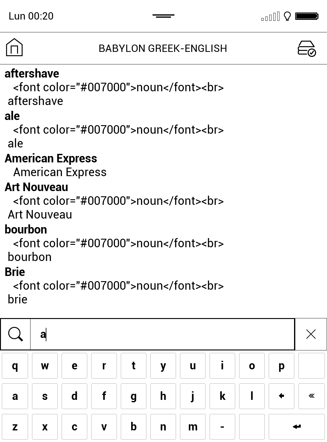

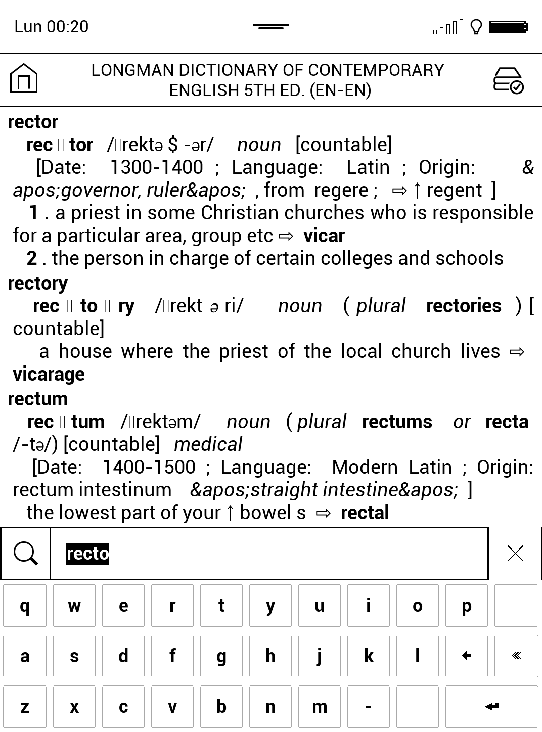

I've tried the other dictionaries you put on pCloud. Here are those with issues (see screenshots), could you regenerate them?
  • All the Van Dale dictionaries except GWHN 2019 have the same issue as the NL-FR
  • Babylon EL-EN has HTML tags (likely a different problem, right?)
  • Duden has hexadecimal HTML entities
  • KD has hexadecimal HTML entities
  • Longman has some HTML entities (notice the &apos; in the screenshot)
  • Littré 2011 had an issue with the conversion of the HTML entities, apparently? (might also be a different problem?)

@Getkey Could you test the Babylon_English_Greek dictionary of Nov15th2021?.
I've included the <br>-tag in $PossibleTags and expanded the code for eliminating colors-tags:
if($remove_color_tags){
	# Removes all color from lemma description.
	# <c c="darkslategray"><c>Derived:</c></c> <c c="darkmagenta">
	# Does not remove for example <span style="color:#472565;"> and corresponding </span>!!!
	# Does not remove for example <font color="#007000">noun</font>!!!
	$def =~ s~<\?c>~~gs;
	$def =~ s~<c c=[^>]+>~~gs;
	# Does not remove span-blocks with nested html-blocks.
	$def =~ s~<span style="color:#\d+;">(?<colored_text>[^<]*)</span>~$+{colored_text}~gs;
	# Does not remove font-blocks with nested html-blocks.
	$def =~ s~<font color="#\d+">(?<colored_text>[^<]*)</font>~$+{colored_text}~gs;

After adding <0x00> to the subroutine removeInvalidChars and rerunning the script for Duden the entry generated is:
<ar>
<head><k>a</k></head><def><sup>i.</sup><blockquote><span><span><b>a, </b><b>A </b>das; - (UGS.: -s), - (UGS.: -s) [mhd., ahd. a]: <b>1.</b> erster Buchstabe des Alphabets: <i>ein kleines a, ein großes A; </i> <i>eine Broschüre mit praktischen Hinweisen von A bis Z (unter alphabetisch angeordneten Stichwörtern); </i> <b>R </b>wer A sagt, muss auch B sagen (wer etwas beginnt, muss es fortsetzen u. auch unangenehme Folgen auf sich nehmen); <sup>*</sup><b>das A und O, </b>(SELTENER:) <b>das A und das O </b>(die Hauptsache, Quintessenz, das Wesentliche, Wichtigste, der Kernpunkt; urspr. = der Anfang und das Ende, nach dem ersten [Alpha] und dem letzten [Omega] Buchstaben des griech. Alphabets); <sup>*</sup><b>von A bis Z </b>(UGS.; von Anfang bis Ende, ganz und gar, ohne Ausnahme; nach dem ersten u. dem letzten Buchstaben des dt. Alphabets). <b>2.</b> ‹das; -, -› (MUSIK) sechster Ton der C-Dur-Tonleiter: <i>der Kammerton a, A.</i> </span></span><span></span></blockquote>
<sup>ii.</sup><blockquote><span><span><small><sup>1</sup></small><b>a</b>= a-Moll; Ar.</span></span><span></span></blockquote>
<blockquote><span><span><small><sup>2</sup></small><b>a</b> ‹Präp.› [ital. a &lt; lat. ad = zu]: auf, mit, zu (in ital. Fügungen, z.*B. a*conto, a*tempo).</span></span><span></span></blockquote></def>
</ar>
Note that the '>' symbol is still formatted as the html-codepoing '&lt;'. is this also not displayed properly, just as '&apos;'?
@Getkey Could you test Duden of Nov15th2021?
Markismus is offline   Reply With Quote
Old 11-15-2021, 06:38 AM   #120
Markismus
Markismus actually read the MS Office License Agreement.Markismus actually read the MS Office License Agreement.Markismus actually read the MS Office License Agreement.Markismus actually read the MS Office License Agreement.Markismus actually read the MS Office License Agreement.Markismus actually read the MS Office License Agreement.Markismus actually read the MS Office License Agreement.Markismus actually read the MS Office License Agreement.Markismus actually read the MS Office License Agreement.Markismus actually read the MS Office License Agreement.Markismus actually read the MS Office License Agreement.
Markismus's Avatar
Posts: 974
Karma: 153081
Join Date: Jul 2013
Location: Rotterdam
Device: HiSenseA5ProCC, OnyxNotePro, Note5, Kobo Glo, Aura
I've created a subroutine to remove the html-escape characters:
sub unEscapeHTMLString{
    my $String = shift;
    $String =~ s~\&lt;~<~sg;
    $String =~ s~\&gt;~>~sg;
    $String =~ s~\&apos;~'~sg;
    $String =~ s~\&amp;~&~sg;
    $String =~ s~\&quot;~"~sg;
    return $String;}
The entry for rectum is now generated as:
<head><k>rectum</k></head><def><b>rec</b>‧<b>tum</b></c> /ˈrektəm/  <i><c> noun</c></i> (<i>plural </i><b>rectums</c></b><i> or</i> <b>recta</c></b> /-tə/) [countable]</c><i> medical</c></i>
<blockquote>[Date: </c>1400-1500</c>; Language: </c>Modern Latin</c>; Origin: </c>rectum intestinum</c> </c><i>'straight intestine'</c></i>]</blockquote>
<blockquote> the lowest part of your ↑<kref>bowel</kref>s</c> ⇨ <b>rectal</b></blockquote></def>
</ar>
@GetKey Could you check whether the Longman Dictionary of Nov15th displays without html-codes?
