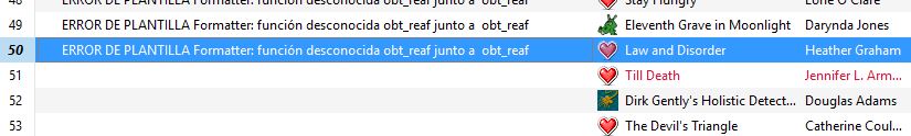

I have found a problem with templates and functions. You can see the message at the screen:
TEMPLATE ERROR Formatter: unknown function obt_reaf near obt_reaf... But books 50 and 51 have the same template... and it works in 2.84.
This is the code, I suppose it is not necessary but...
Attachment 156660

And it works now. There is something strange.
