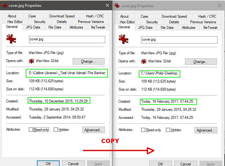

Create Date is not available on Linux and OSX, i.e. it's only available on Windows.
And on Windows the Create Date is the date/time that a particular instance of a file was created. Below you see what happens when a file is copied, the copy's Created date/time is set to when the copy took place.
AFAIK the create date/time of the files are not stored when they are moved into a ZIP or RAR archive. When I unpack a zip with Windows Explorer or WinRAR the create date of the files in the unpacked folder is the current date/time.
So I would assume when calibre extracts ebook files from a ZIP or RAR the create date/time will be the current date/time - which is effectively the same as calibre's timestamp/Date column.

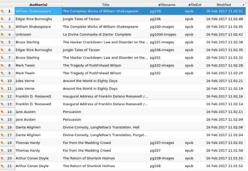

For knowing which the problem is, I would need a debug log of a session with failed files. Unless I have that, I can do nothing.
I added 21 files of the gutenberg project. I did it several times and the result is different. Typically between 0 and 3 books have missing filenames.
When is was ready to create the log, i got always a correct import. But now I can show one with an incorrect filename.
I imported the 21 books two times to demonstrate both are different. By the way, i did not see any hint in the log. Did you test, if the database update was successful?
The first Import (the first book is incorrect):
Yes, the exception is treated. Anyway, I'm going to add some more logs and I'll update a temporal version, so if you want you can test it and I can see which the problem is.

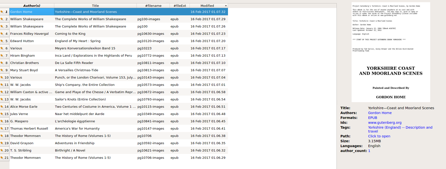

Hi @Terisa de morgan,
I imported more epub books, so I can hit the difficulties in one import.
1586 book imported, 202 filenames missing.
Sort after modified date, a gap of 8 books (such "larger gaps" are typical):
Name:	Screenshot from 2017-02-16 11-41-16.jpg
The next gap:
Name:	Screenshot from 2017-02-16 11-41-52.png
Sort by column #filename
Name:	Screenshot from 2017-02-16 11-42-55.png
No hint for me in the log:

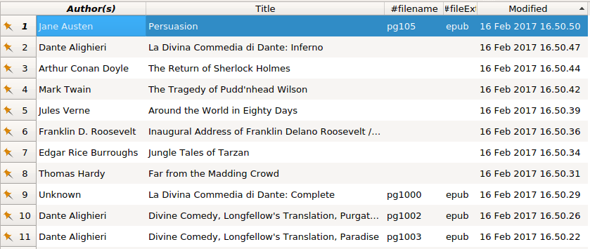

Checking the logs, it looks like you try to add the same file more than once and the second one fails. I¡ll try to check a similar situation at home.
I did it again without duplicates Terisa, it does not make a difference:
