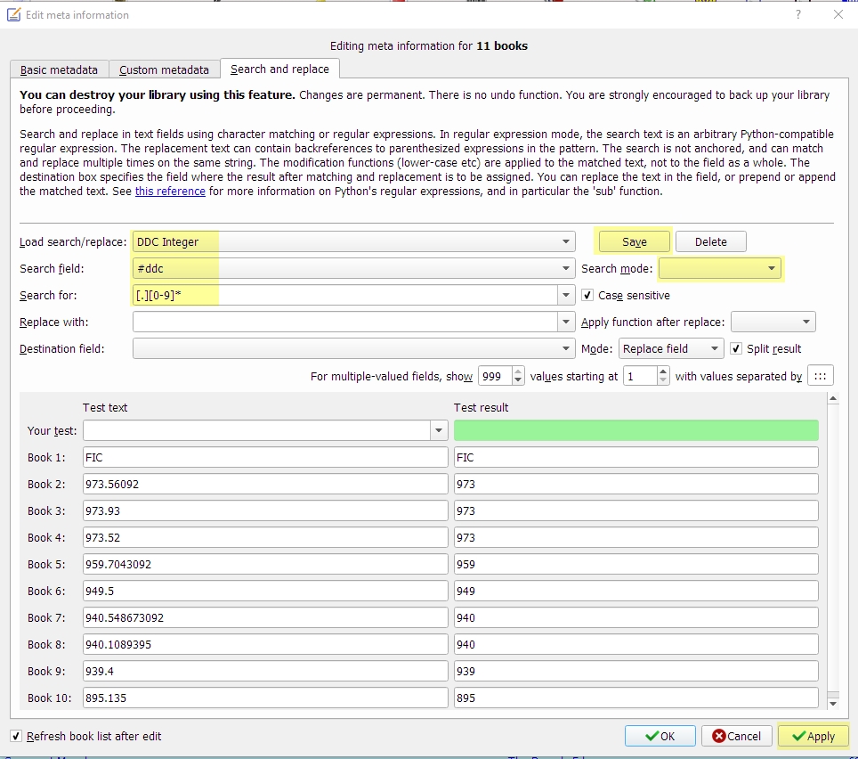

Change bulk DDC
Hi there,
I'm a Brazilian Lawyer, so, there are many issues that come with this those attributes: I have a terrible English, I don't know anything about a programming language, and I have my doubts if am I in the right topic to make this question - that's my first time in the Forum.
Basically, I work only with the main DDC numbers (100, 220, 330, 340, etc) and I was wondering if is there any way to change in bulk DDC numbers? In preference/settings, I didn't see a way to do it.
Furthermore, (as I said, that I'm a John Snow on Programming = I Literally Don't Know Nothing), I tried to use Regular Expressions, however, I have to do "category by category", for instance:
Search: 34.*
Replace: 340
Search: 35.*
Replace: 350
... and so it goes.
Is there a not dumb way to do it?
Sorry about anything...
Best Regards
MauroMassucatti is offline   Reply With Quote

DDC Integer Creation
See the attached image explaining how to create an "integer" from your DDC, although of course the DDC is textual since there are a few non-standard values that are not uncommonly used, such as "FIC".
DaltonST
DaltonST
I don't know how to thank you, DaltonST! Awesome!!!

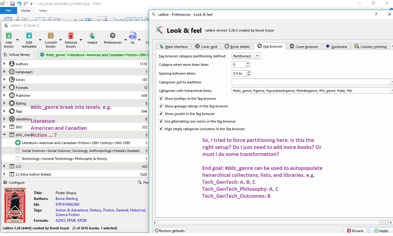

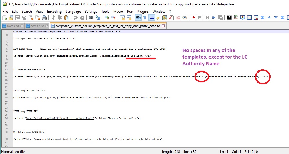

soooo many images ;-) really helpful, I just wish I knew a way to download the full sized ones in bulk. Onto bigger questions:
1. Is there a typo in your composite_custom cut and space? Yesterday, with the columns cut and pasted, the plugin crashed with 'url not found' (or no data? apologies for the terrible, sleep deprived bug report). Removed the columns, problem did not reoccur. Today, I added back the custom columns, but I removed the extra spaces in the template for the LC Authority Name, and everything is copacetic. Is this spurious and I actually had some other issue? (I've attached a revised cut&paste doc just in case)

2. I want hierarchies in my genres, ideally auto-generated. Do I need to script some regex to change the Library Codes genre ">" separator into commas? Like the example in the manual, I'd like to end up with a situation where books A, B, and C fill out the following categories:
Tech, GenTech: A, B, C
Tech > GenTech > Philosophy: A, C
Tech > GenTech > Outcomes: B
instead, I have flat ddc_genre lines. Please help! (yes, I assume that partitioning at 0 is a silly idea, but I don't grok the structure calibre is using.)

[1] 555 people have downloaded the .txt file, and until now there have been no complaints. If there is a typo, it must be trivial and easily correctable. I haven't used or looked at it in ~3 years. Actually, since then, Calibre miraculously added new functionality to obviate the need to use it. See Preferences > Look & Feel > Create Rules to Convert Identifiers into Links.
[2] The LC Genre submenu has a menu item to specifically import a .csv file to add/change the mappings. The original .csv file is attached to the Original Post. See https://www.mobileread.com/forums/sh...11344#poststop for a user-submitted French version.

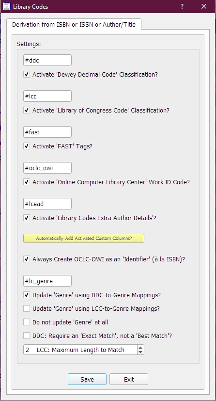

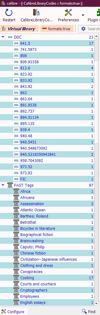

Version 1.0.35 FAST Tags
Version 1.0.35 - 2018-10-11 FAST Tags added to LC Customization. FAST retrieved as Tag-Like. Minimum Calibre now is Version 3.30.
See the attached.
DaltonST
