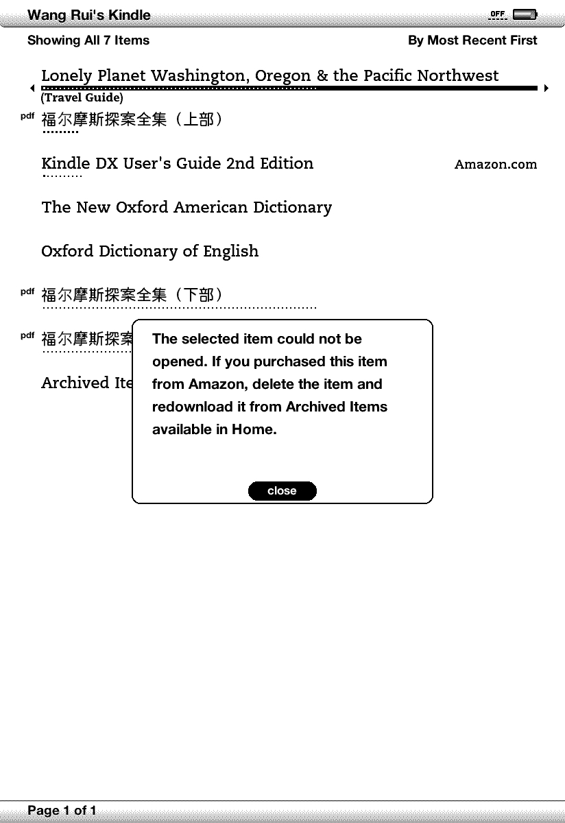

Can Not Open the .azw3 Files Without DRM

Yeah. I followed the guide of yours step by step and finally succeeded. It’s really helpful! And now, the webreader can be automatically launched every time when I restarted my Kindle. The .azw3 file shows perfectly on my DXG both in landscape and portrait mode now. Thank you so much!
