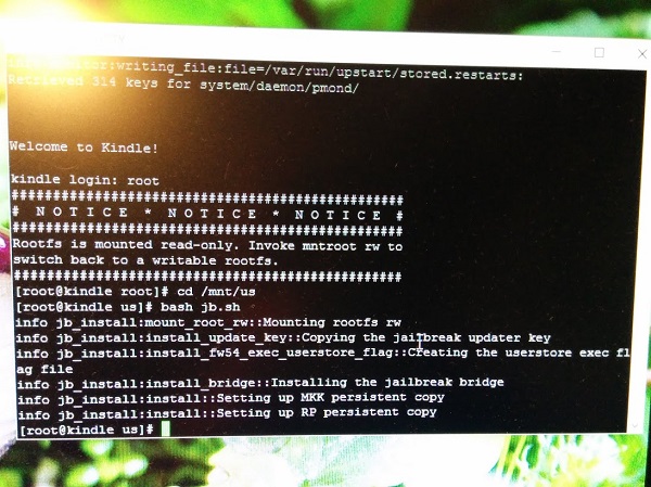

I already changed password by using:
mntroot rw
passwd
and when I run the jb.sh, I got a error
[root@kindle us]# bash jb.sh
info jb_install:mount_root_rw::Mounting rootfs rw
info jb_install:install_update_key::Copying the jailbreak updater key
jb.sh: line 305: can't create /etc/uks/pubdevkey01.pem: nonexistent directory
info jb_install:install_fw54_exec_userstore_flag::Creating the userstore exec flag file
info jb_install:install_bridge::Installing the jailbreak bridge
info jb_install:install::Setting up MKK persistent copy
info jb_install:install::Setting up RP persistent copy

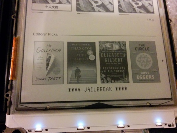

But the funny thing on kindle screen shows:
DIAGS Exit
Please use serial port
**** JAILBREAD ****
Is this means jailbreak successfully?

Thanks a lot! Now I got it!
