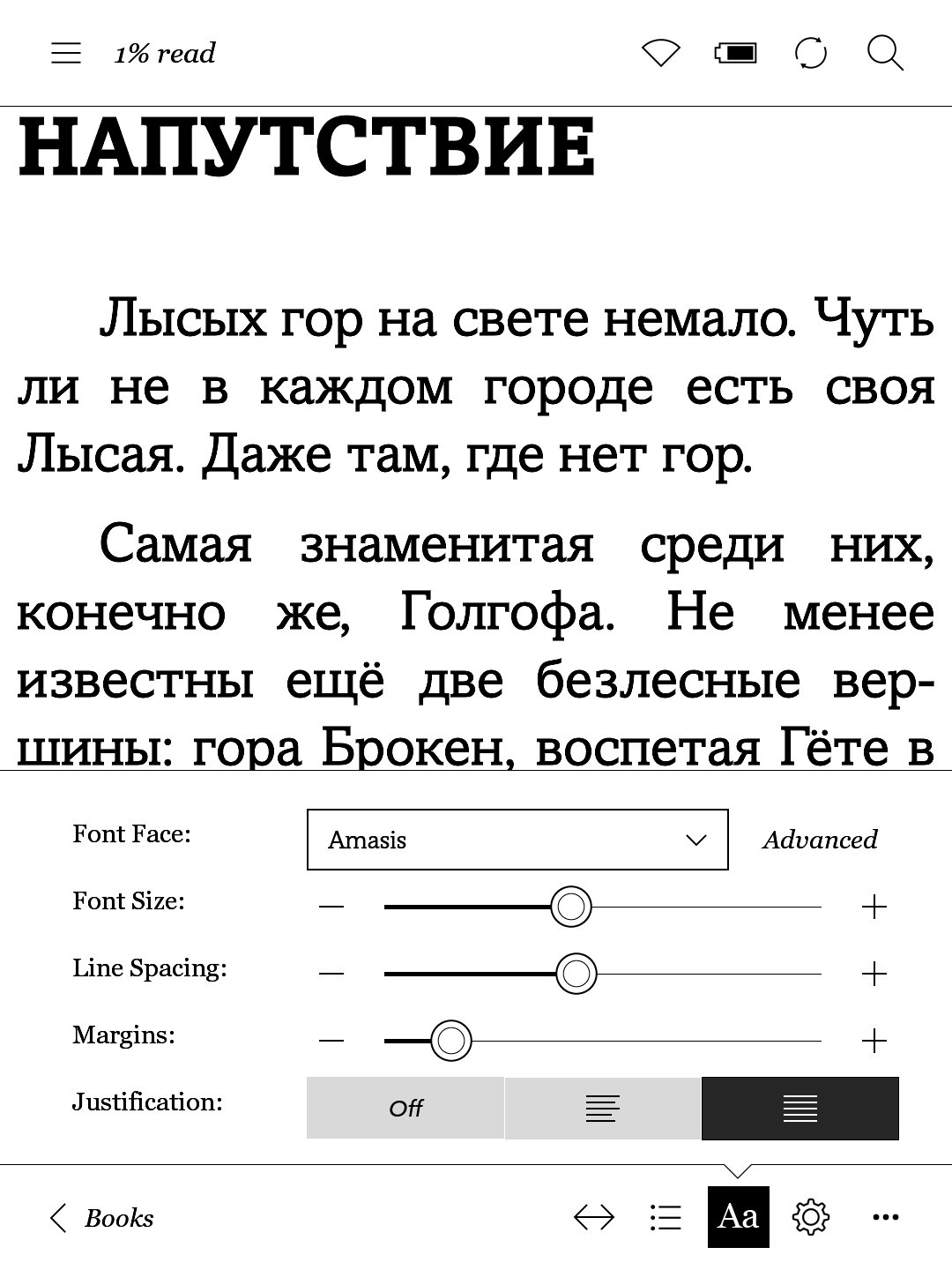

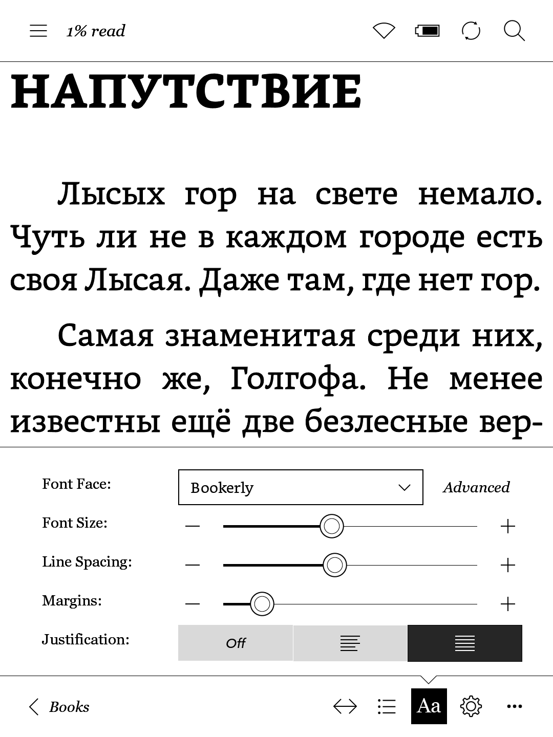

Best way for hyphenation in KEPUB for me:
0. Patch firmware for always hyphens for Kepub.
1. Apply path for hyphens, posted in this tread above.
2. Get book in FB2
3. Convert to EPUB, by fb2mobi: https://github.com/rupor-github/fb2mobi
* in settings switch off hyphens;
4. Convert to KEPUB by kepubify: https://github.com/geek1011/kepubify
Page view you find in attachment.
ID:	160882   Click image for larger version

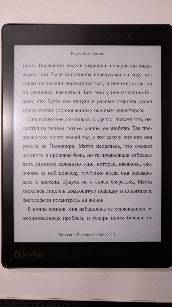

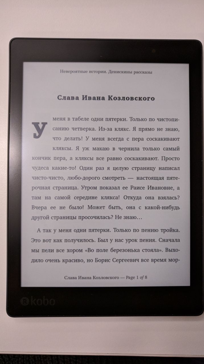

Originally Posted by Vetchy View Post
Yes, I know, that official it not support. But for example - look for screens.
In attach you find how looks fb2 in shelf and render of text.
As you see, FB2 files have an afwul Calibre css for headers, cite etc.
In russian community some users try to create nice style and fix not working footnotes.
There is a file called fb2.xsl.gz in folder usr/local/kobo. If you open it, you can see:
"copyright 2002 Paul Henry Tremblay # # Copyright 2011 Kovid Goyal #"
Maybe this is the reason to see the headers like calibre ones
And probably, changing this file css, you can improve it ...
It is nice that our kobo can read fb2, so please tell us if someone in the community can "repair" this file to have a better look and footnotes fully operative.

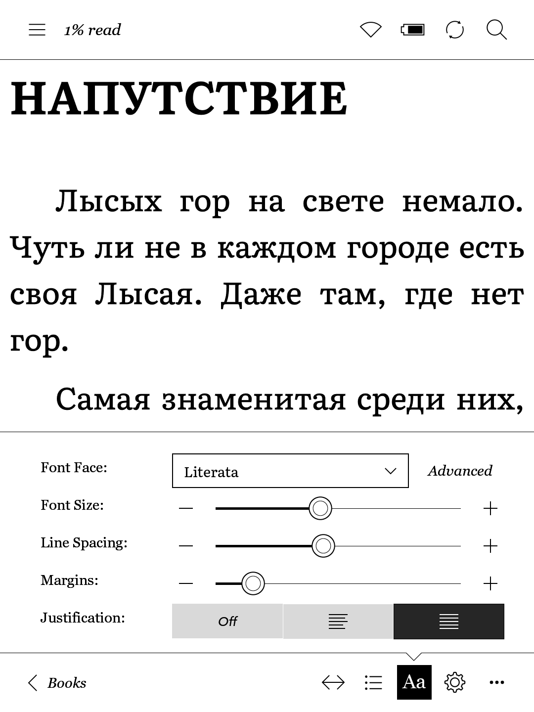

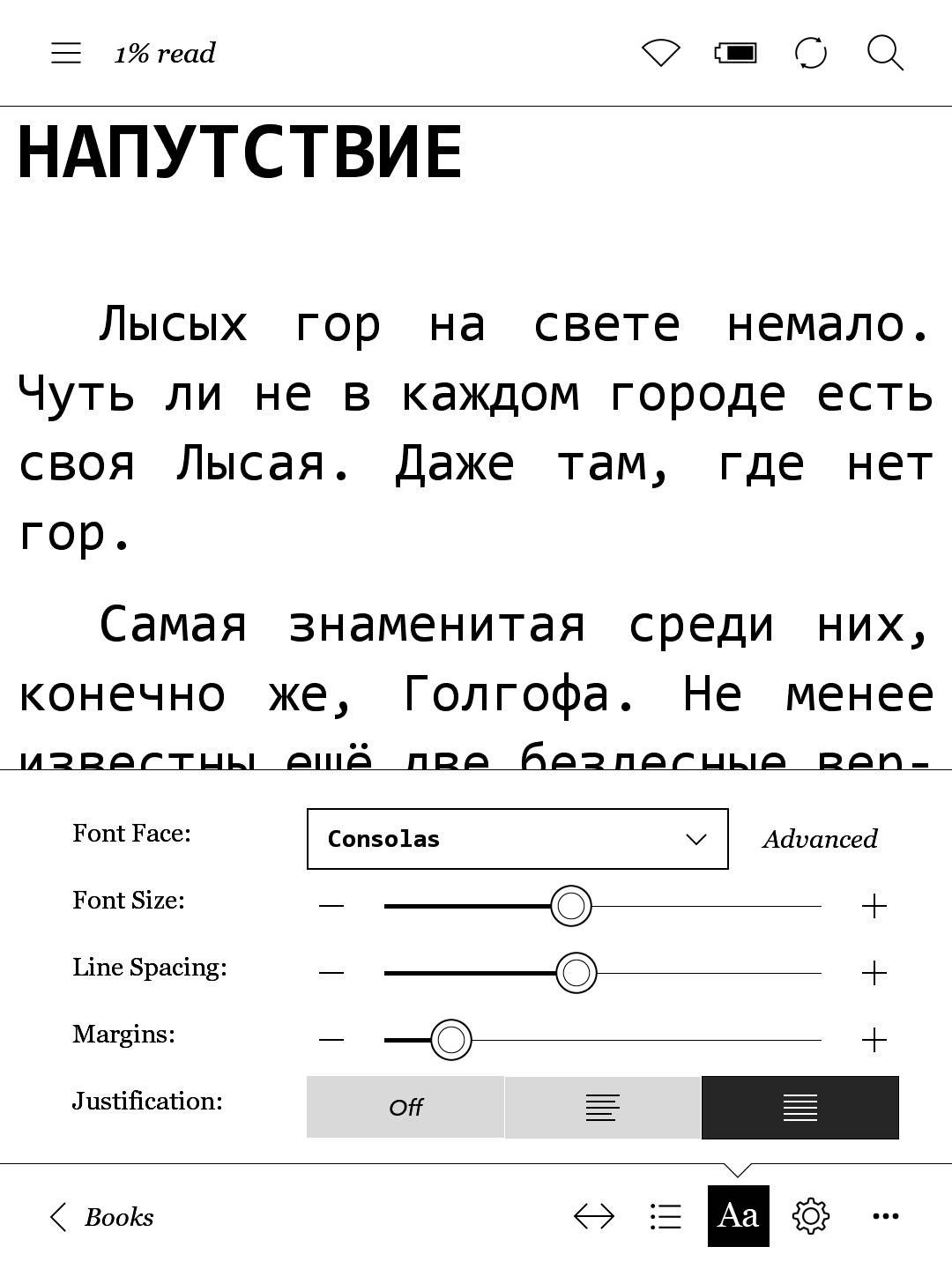

Originally Posted by jcn363 View Post
I downloaded the book and edited to be absolutely sure was clean before put into my device.
Good luck.
I have no problem changing the font in the epub version.
ID:	160939   Click image for larger version
ID:	160940   Click image for larger version
ID:	160941   Click image for larger version
