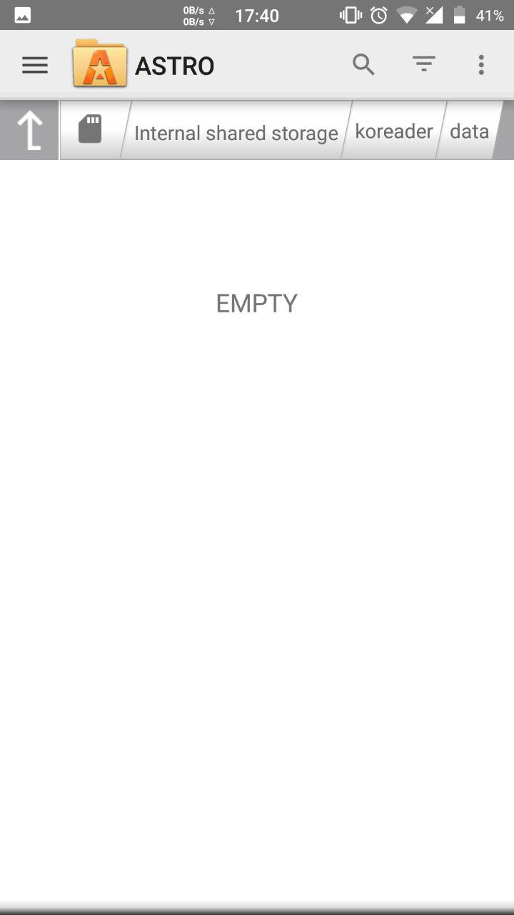

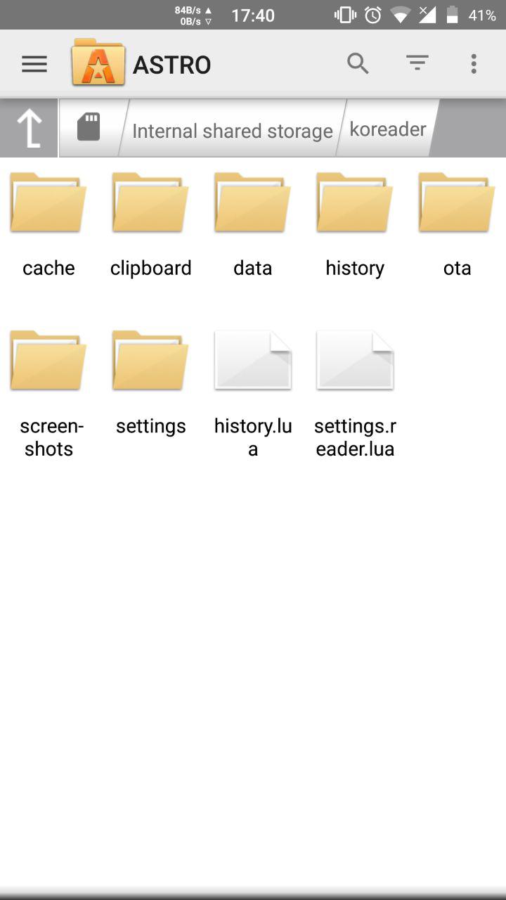

Hi, how can I add custom fonts on koreader?
Thanks

I think just ./fonts in the data directory should generally do the trick. Hopefully also on Android!
Edit: but the bigger question might be how to find the data directory. Any Android KOReader users around?

The Fonts have their own folders in the "koreader" directory. You could try adding your fonts to the appropriate folder. I have added a number of .ttf fonts to the "freefont" folder. It has been a while since I did this for the android version (I broke my tablet), but as I remember it I just put them into the download .apk (along with some other changes) then signed the modified .apk (using EasyApkDisassembler.V1.3.2). Those .apk installed fine on my old tablet.

Thanks for the reply. Unfortunately I can't find any folder named "font/Font/fonts/Fonts", here 2 screens of the koreader directory.
ID:	156293   Click image for larger version

In that case it's possible that this is unsupported on Android without repacking the apk. You could try creating a "fonts" directory yourself, see the Kobo release for what the folder structure looks like there.

Creating the folders fonts/freefonts within the koreader directory did the trick!!
Thank you so much!

You mean the one in the screenshot?
